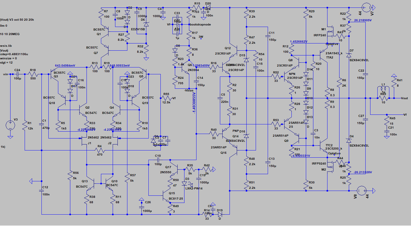

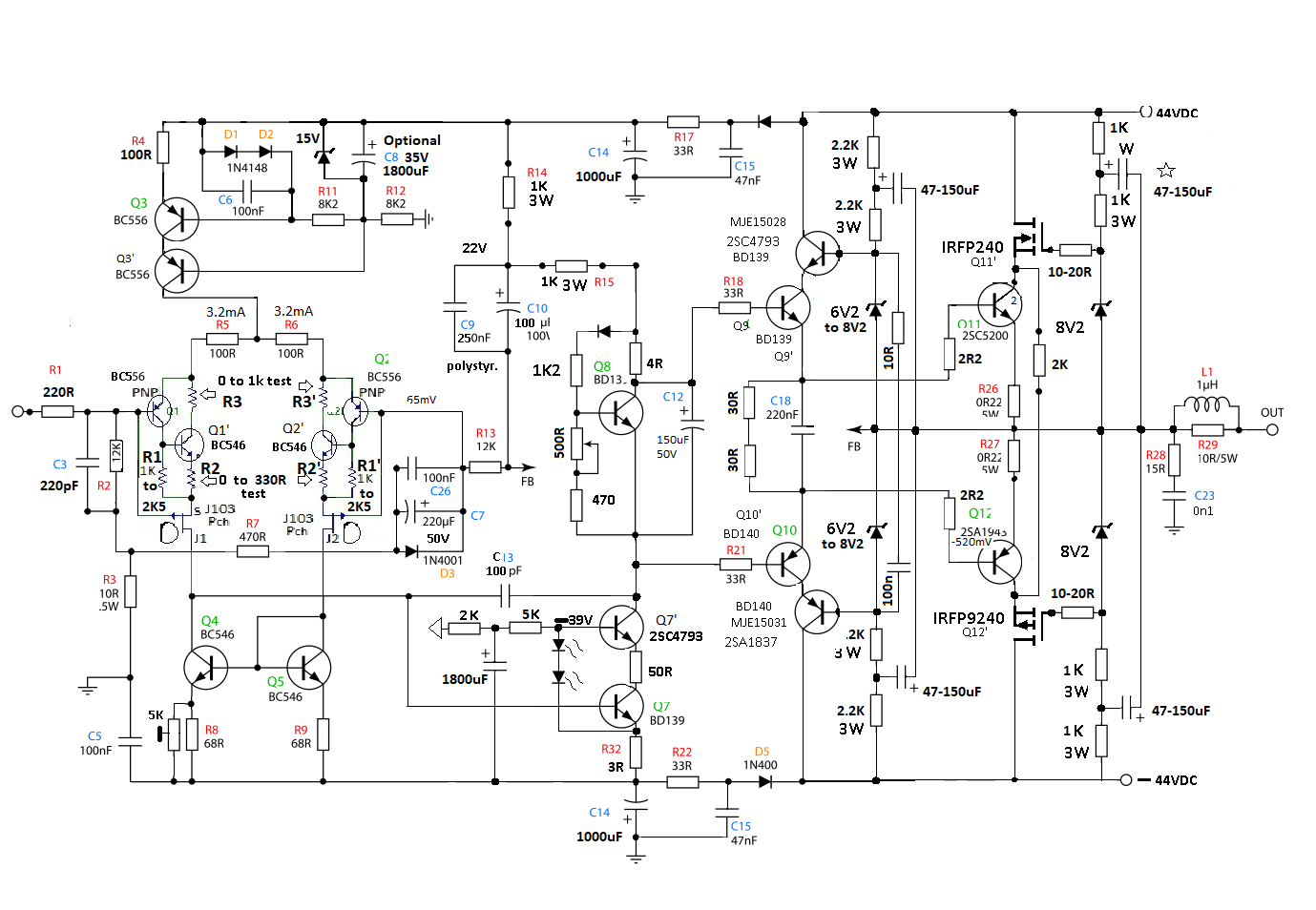

Dear Max,
I just found a last thing for you to change.
R35 and R47 are now 10K each. This is too much to supply Q17 with enough base current.
See image below for the difference it makes when changing these values to resp 3k3 and 1K.

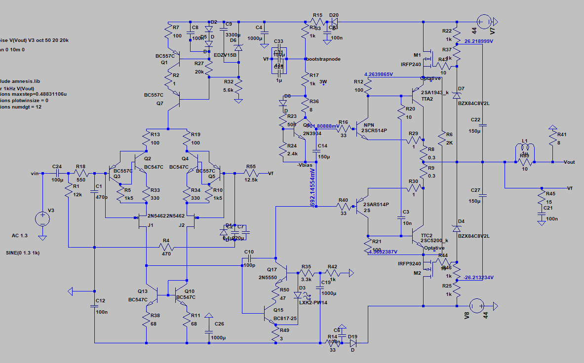

Hi Max,
I noticed in the pictures of your prototype that the output transistors are MJ15023 and MJ15024 which are much slower and are less linear than the devices in the simulation. Also the Drivers in the prototype are TO126 types BD139 / BD140? not the fast SMD devices in the simulation.
I wonder if the reason you head a difference with Cascoded output is just improving the performance of devices in the prototype, and may not be required with the actual sustained Beta devices specified in the simulation.
Might be useful to list all the devices in the prototype so a more accurate simulation can be built.
Symon

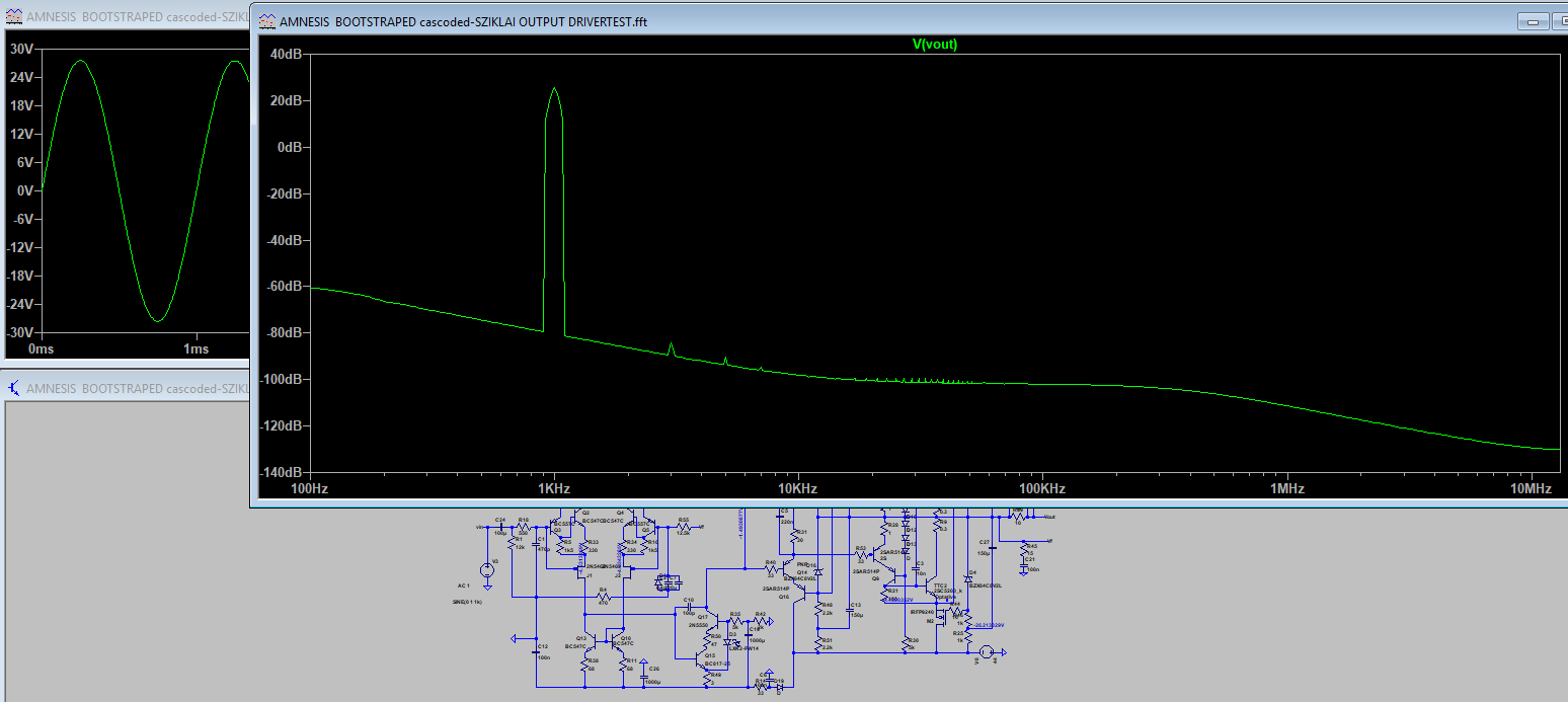

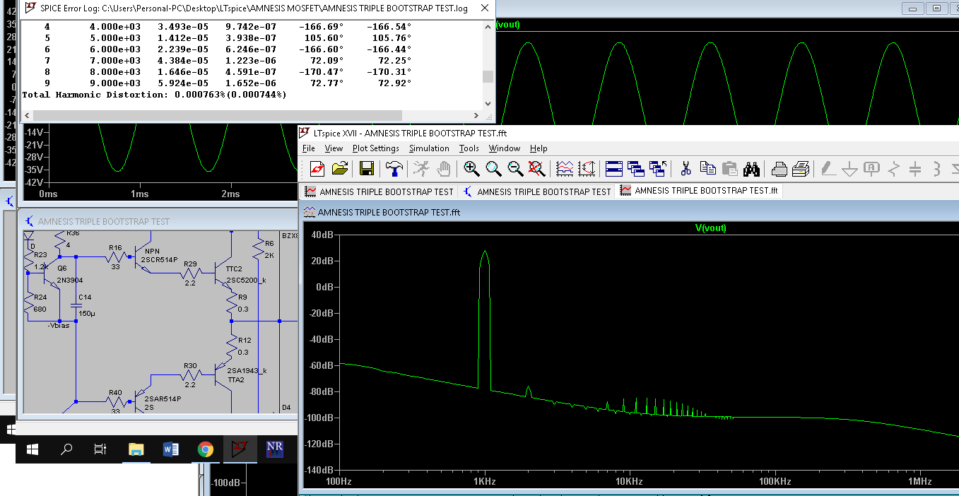

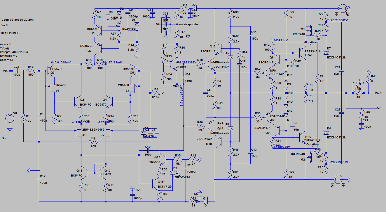

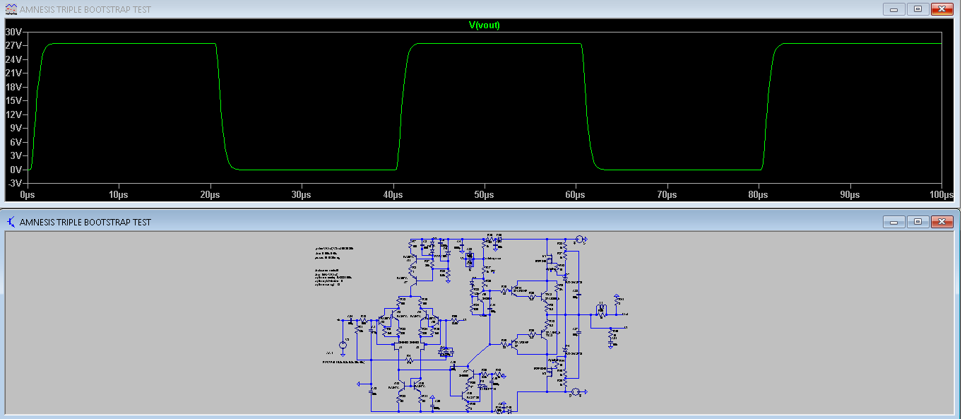

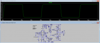

Listening tests are going well with the new 3K3/1K mod for the VAS cascode.
Maybe it's time to re-visit some old ideas, like Pass' style EF/Darlington output, for those who like simpler solutions. 🙂
Edit: apparently R21, R48 and C20 are not needed. THD 0.000763% with 2nd harmonic predominant.
Edit n°2: stability margins are not brilliant but square wave test looks good.
Also, the common bias for driver and output is feasible and can be tested.
M.
PS: I am a big fan of Van Der Graaf Generator, so I'm including them for my tests. 😎

That cascoded Darlington output from Nelson Pass is interesting isn't it. 😉
Remember one can increase headroom (going nearer PS voltage) by making the biasing resistors for the Vref asymetric.
Dear Hans wrote,
Funny that you mention it. Now that we found the origin of the oscillation bursts, we can go back to the looser original input filter: 220R + 220pF, which gives good numbers. 😎
I thought safety margins were much stringent... 😕
Disclaimer: all R and C values are subject to change without previous warning 😀
M.

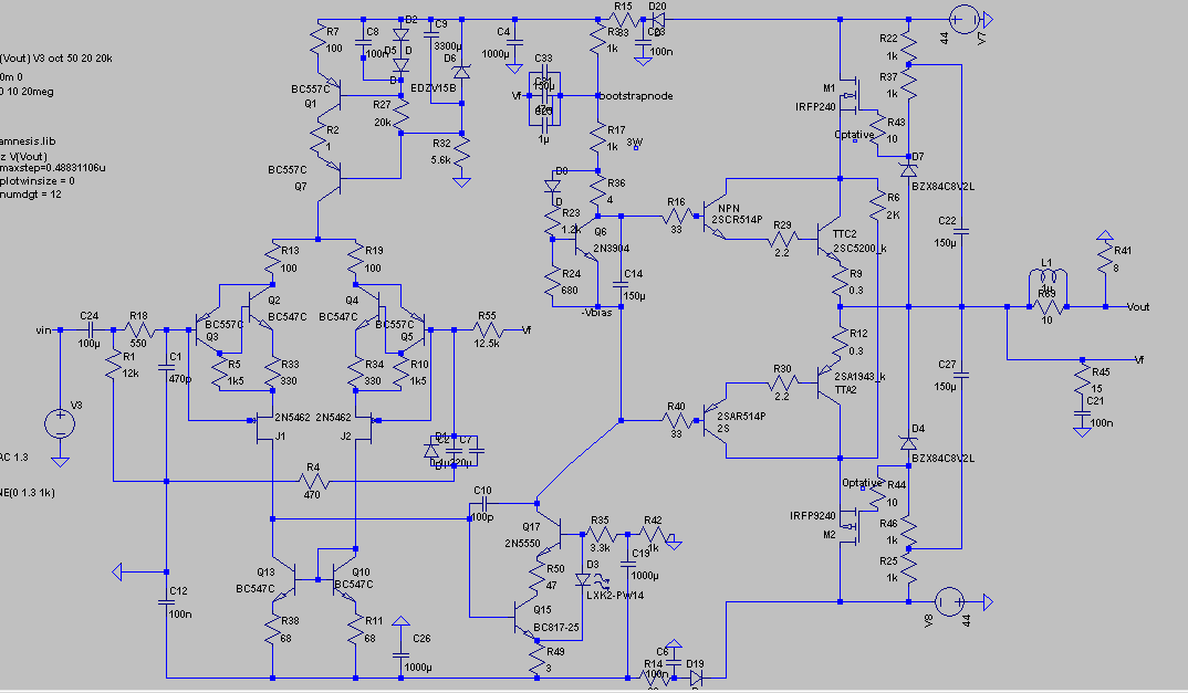

And its bootstrapped Sziklai output counterpart. 😎
Hi Max,
interresting new version, I tried running it but substitued model from Bob Cordells libary for more representative devices. I used BD139/BD140 for the drivers, and MJ21193/4 for the output devices. Manly because these are closer to the characteristics of the devices you are actually using than the 2SC5200 etc.
The one thing I will note is you need to adjust the bias generator, standing current is currently over 500mA. So operating in Class A up to about 14V peak output.
Becareful with this CFP output's tend to oscilate, especially if the driver doesn't hae low Cob value.
That said, would be interesting to hear how well the actual circuit works.
Regards
Symon

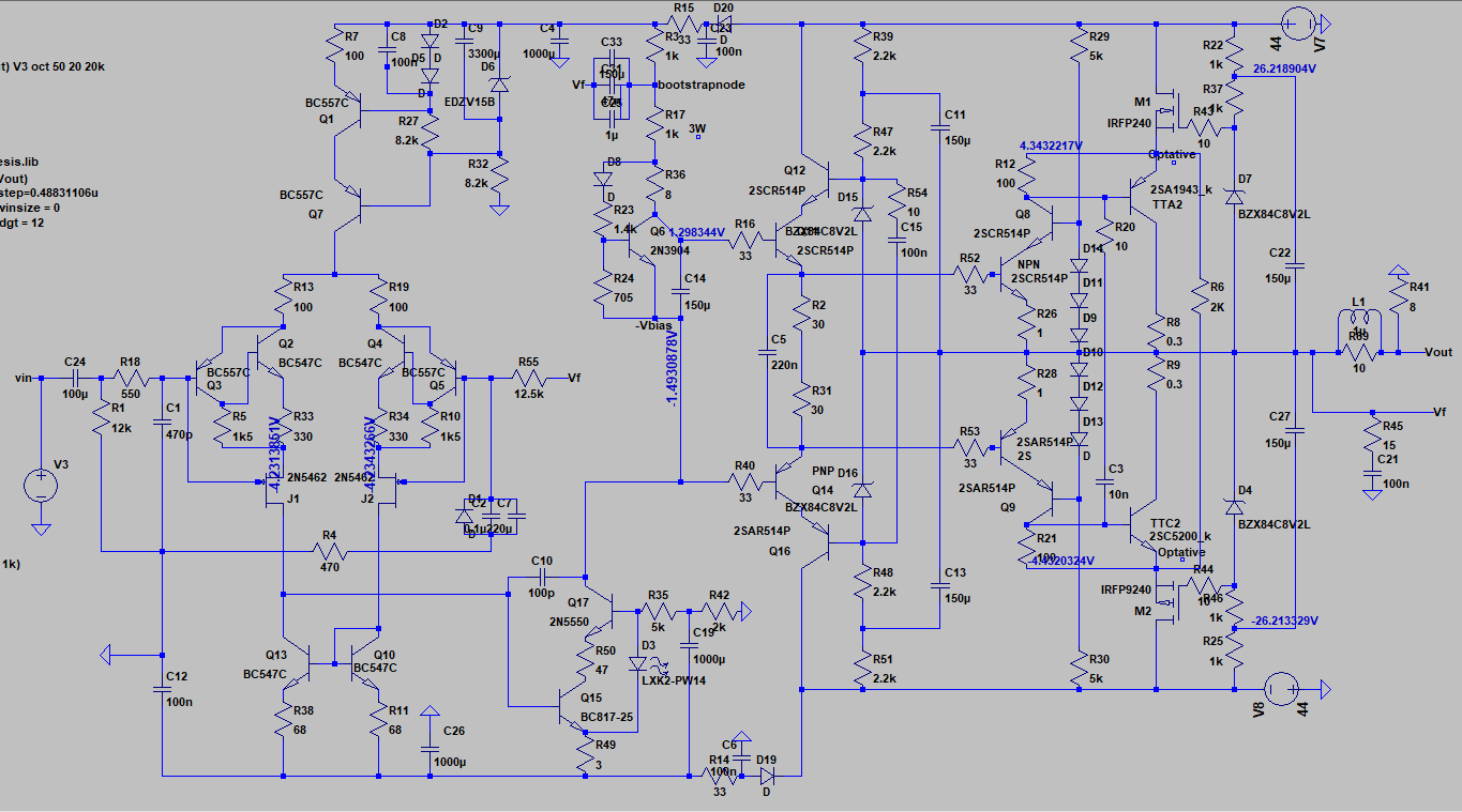

Yes, I know CFP do oscillate. When I began I tried the most strange outputs you can imagine. The more complex, the more unstable and good sounding they were 😀
Edit: I am now playing with the resistor arrangment for tha Sziklai and THD is going down...
Of course, bias is set with a pot until desired current.
Glad you have the 139/140 models. Mind to share?
You know I am a nullity with LT-spice but maybe I can add them.
Be aware that the final prototype will use 5200/1943 as outputs, just for the abundance of them. Anyway, experimentation with different units is encouraged.
I am trying now to set a "bootstrapped cascoded-Sziklai" but it is tricky...
What do you think about that Bootstrapped-Darlington output?
Chhers,
M.

Hi Max,
I used the model from Bob Cordell's web site
CordellAudio.com - SPICE Models
The reason I chose MJ21193/4 was because these are 4MHz devices like the MJ15023/4 that you are using in prototype. 2SC5200/2SA1943 are 30MHz so nearly 10 times faster.
So just trying to get closer to the circuit you built.
Symon

Here is a new Amnesis.Lib including the BD139 and BD140.
Hans
Thanks, I will do my best.
I got that. Do you see the effect of bootstrapping/cascodying? On BW or else.
My Red PCB Amnesis (Modded Blame ST from DestroyerX) does use 5200/1943. That one uses a linear supply with "charge-transfer", so I cannot say if the difference in sound comes from the different output units or not.
Thanks for the models. I will try to figure it out.
The bootstrapped Sziklai output with 1R emitter resistors needs further increase in Vbe multiplier resistor to control bias current. I wonder too what it sounds like.
My QUAD BOOTSTRAPPED (with SMPS) is on its third day of listening test, running stable and the sound is "very decent". The objective of the thread was to make an amp that was satisfactory to listen to classical music and for that transparency and dynamics were the ultimate goals. In that sense, this version is satisfactory. It has an open and detailed sound with lots of dynamic contrasts, remaining relaxed. I suspect it can be perfected, as everything, but it is fine like it is.
A "QUAD" PCB will allow for stepped experimentation on outputs: first, simple EF; second
bootstrapped output with simple driver; then bootstrapped Darlington; then perhaps bootstrapped Sziklai; then "QUAD" 😎 Lots of fun. 😎 😀 Maybe I can even perfect other more complex outputs...and finally the VFET bootstrapped output.
Choose your flavor.
M.

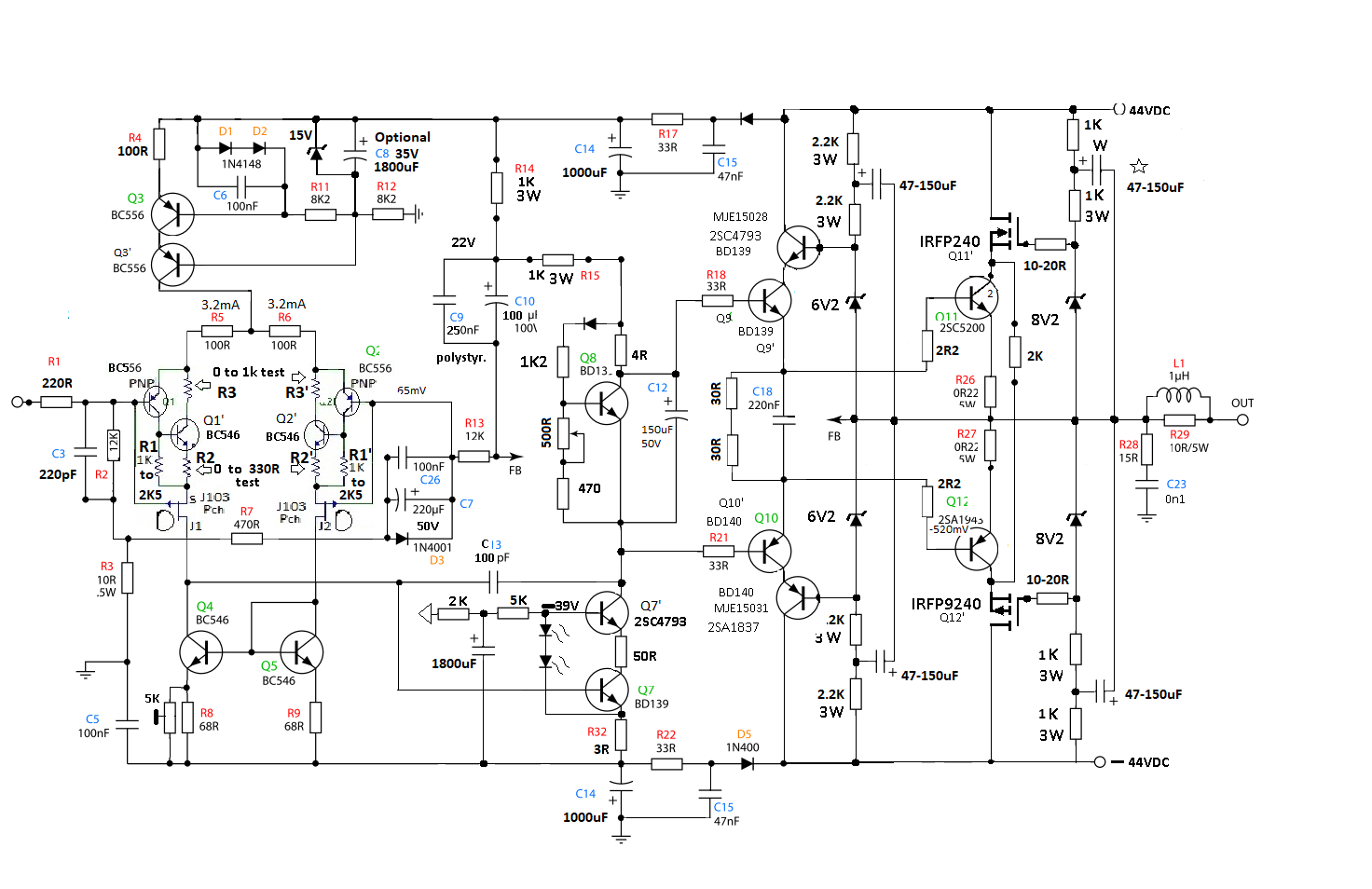

Dear Max,
What is the function of R3, 10 Ohm.
It is doing no harm, but why ?
Further everything seems O.K., in LTSpice it is still stable with a Miller cap of 15p.
Hans
Hans

Hi Hans,
I understand that that one isolates signal ground from power ground and reduces the risk of hum...😕
I still play with new outputs 😀
Look at my bootstrapped cascoded-Sziklai output. 😎
I may add a predriver like I've done long ago...
M.

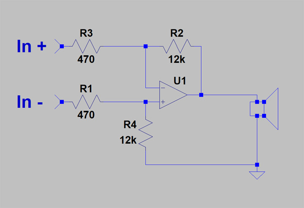

Hi Max,
If you want to safeguard your amp against hum and ground loops, the image below gives the optimal layout.
Minus side of R4 has to be physically connected very close to the Speakers minus output, this point of course also connected to the signal ground or ground plane of the PCB as it is now.
The input signal does not have to be differential, it can just be the SE connection you are using now.
Hans

Thanks for that! 🙂
The amps are silent so far. It might be useful for my other amps, though.

Hi Hans,
connecting signal ground to noisey power ground via a small resistance is a standard way to to break hum loops. It's covered in Bob Cordells book chapter 18. It's not really new idea, I've seen it done in several circuits dating back to 1980's.
What you propose is closer to balanced input, which might be useful if the Pre amplifier is a long way from the Power Amplifer. It's more common on pre ampliers with multiple inputs. In this case the ground loop is most likely between the Power Amplifier and Pre-Amplifier.
Symon
Symon
Hi Symon,Hi Hans,
Symon
I agree with your first statement, however in Max case he has not connected the signal ground to the power ground, but he has inserted 10 Ohm in the signal lines, effectively acting as an attenuator.
As regard to your second point, this simply IS a balanced input and has nothing to do with the preamp being a long way from the main amp.
The setup is just to prevent ground loops within the main amp.
Just have a look over here:
https://www.diyaudio.com/archive/bl...d1460406090-bruno-putzeys-micropre-g-word.pdf
Hans
And the "Bootsrapped Bootstrapped-CFP input" version. 😎
Both new input could be implemented in the official "QUAD" amp. ;-)
Oops! What happened with that 10R?
