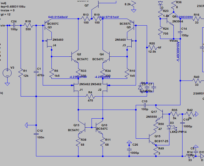

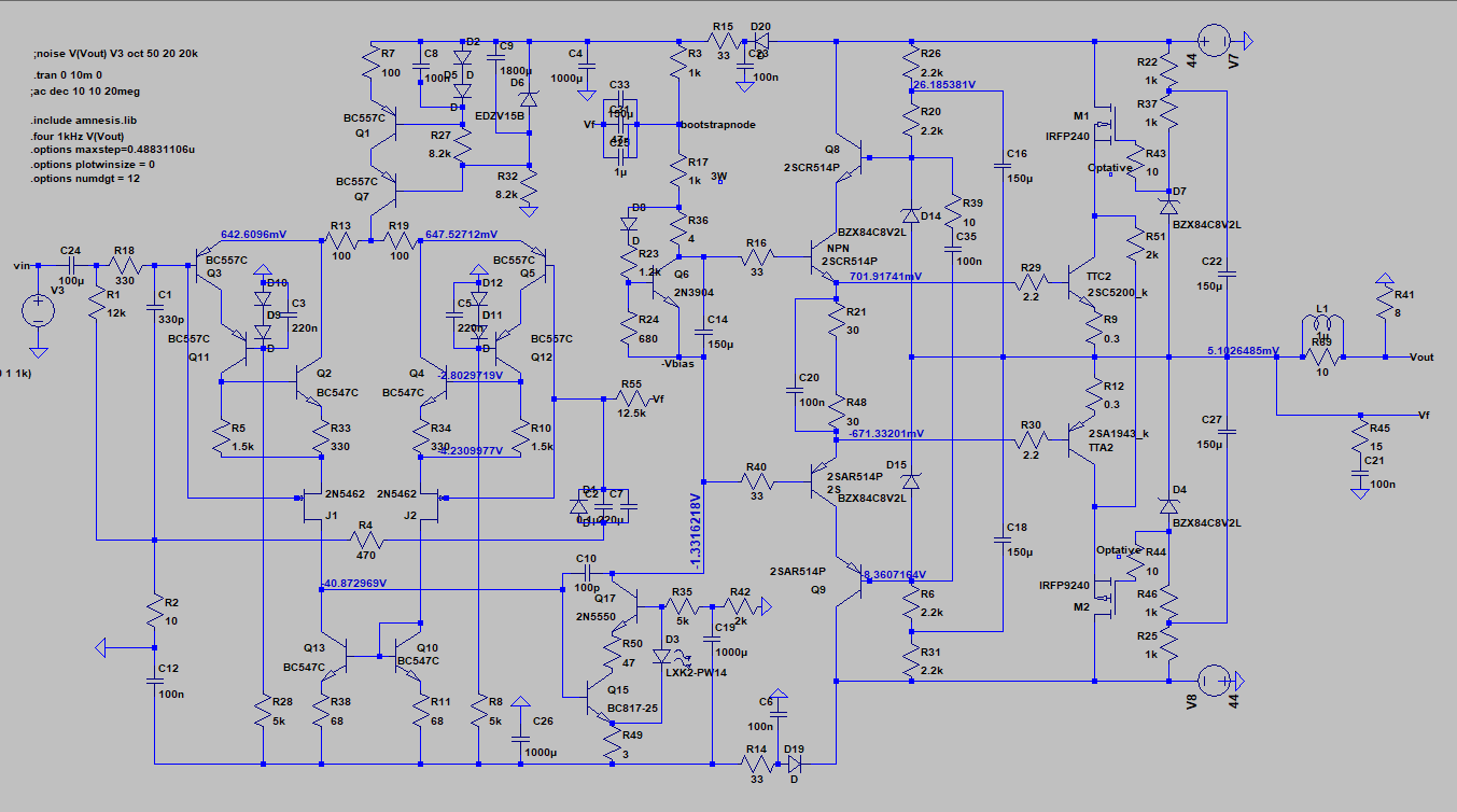

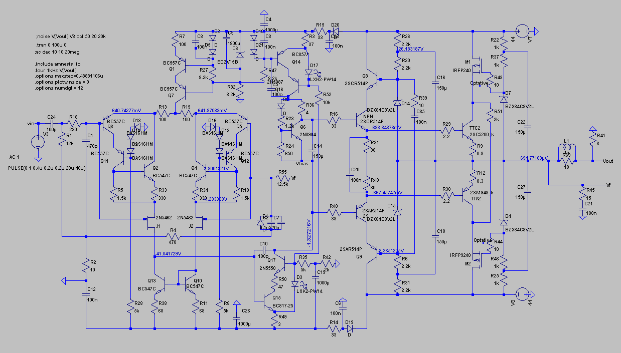

The AMNESIS amp: a good amplifier, like a gentleman, has no memory.
Both new inputs could be implemented in the official "QUAD" amp. ;-)
Oops! What happened with that 10R?
And violá, the "QUAD" with "bootstrapped cascoded-CFP input" .
While we wait for the big fight...
  • AMNESIS QUAD BOOTSTRAP cascoded cascoded CFP.asc
And the "Bootsrapped Bootstrapped-CFP input" version. :cool:
Both new input could be implemented in the official "QUAD" amp. ;-)

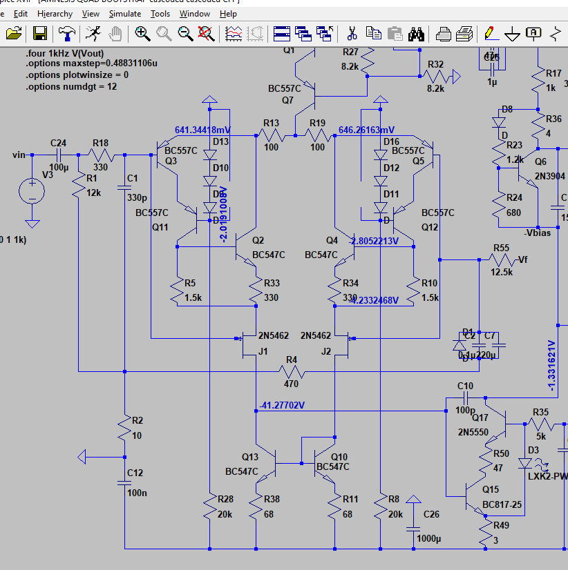

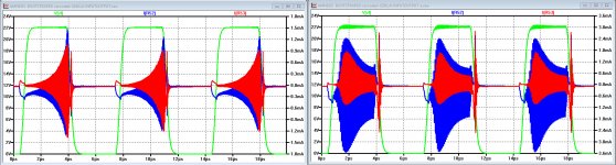

Hi Max,
I took a short look at the CFP design in #320, but found that Q14 was just a generic transistor !!
When replacing the first four drivers by BD139/BD140, I got nothing but oscillation.
When also replacing the second set of four, oscillations continued.
I'm not so fond of this type of output stage, just because the difficulty to get it stable.
First try to get a working model with exactly the transistors you are going to use, not doing that is a waste of time.
Hans
Oops! My bad. Sorry.
Your completelly right! The addition of the driver completelly unbalanced it. No one is stable.
But without driver, meaning bootstrapped cascoded-CFP input and ouput seems stable.
Do you think that omiting the driver to a Darlington (or a Sziklai) bootstrapped will be too much for the VAS?
Simulations show them stable...
Guys, forget all the circuits that say "driver" or "drivertest".
This one seems stable.
The "QUAD" with bootstrapped cascoded-CFP input is also stable in simulation.
  • AMNESIS BOOTSTRAPED cascoded-SZIKLAI INPUTOUTPUT.asc
Not as stable as you think, I'll come back to it tomorrow to show you why.
Maybe you can explain in the meantime why you have made the input more complex.
Hans

Dear Max,
As promised I show you my findings.
I have made 2 models, the one you have sent me and a version with the BD139/BD140 that you have envisaged but for some reason not yet using in your Sim Model.
In both I have set the current through the output drivers to the same 129mA.
Now looking at the output square wave, it almost looks in your version at the left as if the output is stable.
But when magnifying the signal shows that there are oscillations visible at ca 20Mhz.
Now looking at the current through R52 and R53, you get a much better vision on these oscillations.
The image on the right is with the BD139/BD140 and is even worse.
To magnify the effect somewhat, I have reduced the Miller cap to 50pF and the input filter to 220 Ohm/220pF.
These oscillations are internal oscillations because of the CFP drivers.
You still need some modding to get rid of this.
To compare: with the drivers as emitter followers, I could easily reduce the Miller cap to 15pF without any problem.
At the end I fully agree that listening test are the final tests, but when something is oscillating you are not yet ready for listening tests.
Hans

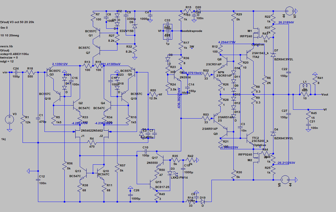

Dear Hans,
You are talking about the "bootstrapped cascoded-CFP INPUT and OUPUT" version, right?
Yes, I know the CFP outputs (even the simple version) are a nightmare to stabilize, even in the case that all appears OK on simulation, due to parasitics, probably. So, when I'll find the time and energy to deal with them again, I will start with a fresh new PCB and be prepared to add a cap or resistor here and there... :D for example, I've seen some commercial amps with b-cCaps at the drivers, though this never worked for me.
Yesterday, I made the "bootstrapped cascoded-CFP" input mod by adding a second BC556 to the CFP (or internal cascode as I call it) with reference to ground as my last schematic shows. I did not add a capacitor yet as it seems to work OK without it. Is it necessary?
I forgot to mention that this mod is discussed in Dr. Kolinummi's book, page n°140, with simulated THD comparison to other variations. He references the base to the main emitter through a 2V voltage source, though this did not work for me, perhaps I am using to much base current...
Preliminary listening test are positive. :cool:
I will elaborate this later if extended listening tests confirm findings.
Thank you, thank you very much for your revision and stimulation :wave2:
M.

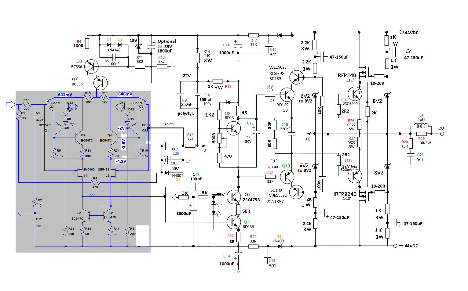

Hi Max,
I watched the latest findings and wondered about the consequences/changes
for an update of my present preliminary layout.
I already started an update based on your new official Amnesis QUAD bootstrapp schematics (post #331) and Triple Bootstrap (post #332) incl. new input stage.
Is the CCS VAS still an option for layout or do you recommend the Bootstrapped VAS only (sound, stability)
Is the cascoded Sziklai output (post#324) an option that should be considered for layout update (a combi layout acc. to posts #331 and #324 is possible).
Due to the increasing number of small signal diodes (up to 14) I want to replace the present type 1N4148 by the SMD type BAS16J to keep traces short.
Any objections?
Cheers

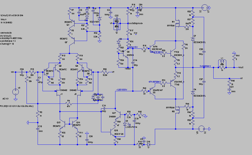

And for those who do not like complications, the "TRIPLE" bootstrapped.
Hi Max,
This is the definitive prove that thermal modulation has nothing to do with the experienced sound.
I did the same test as before , for the dual bootstrapped CFP below at the left and for the new triple bootstrapped input configuration at the right, both on the same scale.
See what a huge difference it makes in heating up between the two.
Hans

Hi Max,
Dear JOSI1,
It would be great to have those PCBs to experiment further. While the "TRIPLE" (post #332) is attractive and simulates well, it is not tested yet. Besides, we don't know how much interest it will have...
The "QUAD" should allow for every variation possible, and more, :) though at the expense of longer vias...
Again, though a nice addition, the CCS-VAS version would have to be checked for to stability and sound before recommending :( I attach a version...
The Sziklai is potentially problematic and at this stage I will consider it for further experimentation only. Even the more tested "QUAD" has a great chance of causing some troubles, that is why I recommend we stick to the proven one. This is not a project for beginners, like yours truly :D , or for the faint of hart. A resilient spirit will be needed when the thing start to oscillate :D
Any objections?
Cheers
OK. The only ones that need to be axial are those on the power supply lines to allow for higher current and eventually to serve for independent power to the input-VAS. :cool: As long as we get the needed -1.4V to -2V referenced to ground.
I will have to buy those then.

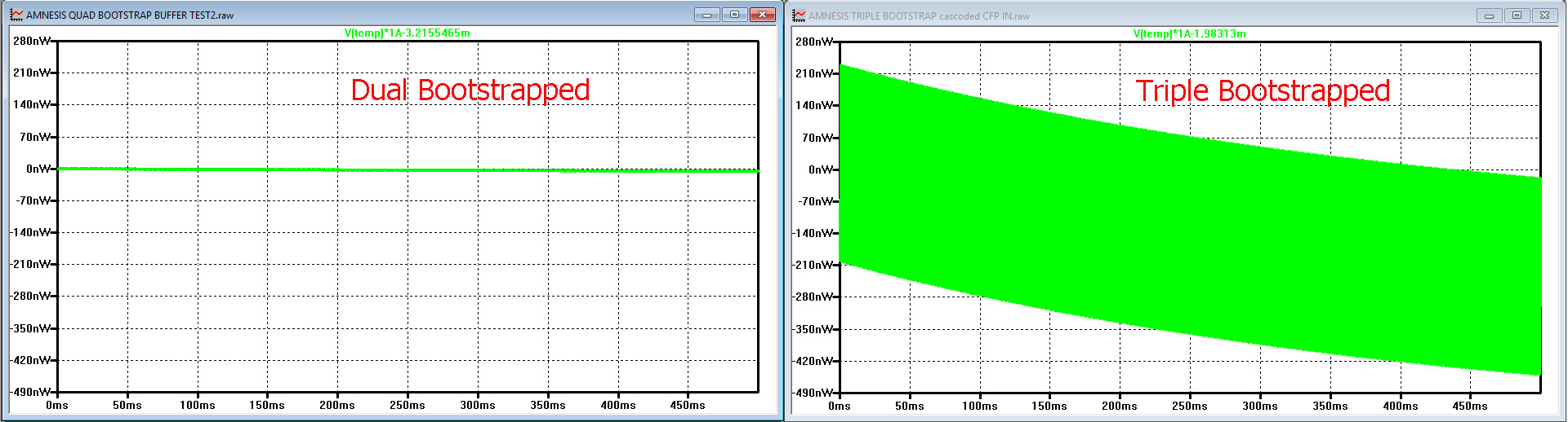

Hi Max,
Hans
Dear Hans, this is very interesting but please remind us which schematics and where you measure as I'm also confused sometimes with so many iterations of the amp and we need to settle this issue. A more detailed explanation of your findings is needed.
This whole set of experiments will, hopefully, give us better sounding though complex (input) circuits, and I am not in the least preocupied if it is due to LTMD or THD or TIM or whatever. We live to learn... :) As I said before, the transistors seem to be gregarious beings that like to share the burden of the task between pairs :D
M.

Dear Max,
The power measurements I made were as before:
Vce(Q3)*Ic(Q3)=Pwr(Q3) while driven from a 1Khz 0.7 Volt sinus wave.
Pwr(Q3) then was processed by a LP filter with a 0.5sec time constant for simulating the thermal transient of a SOT23 transistor.
The plots, being the 1Khz Signal caused Power change minus the steady state DC Power value, is what you see.

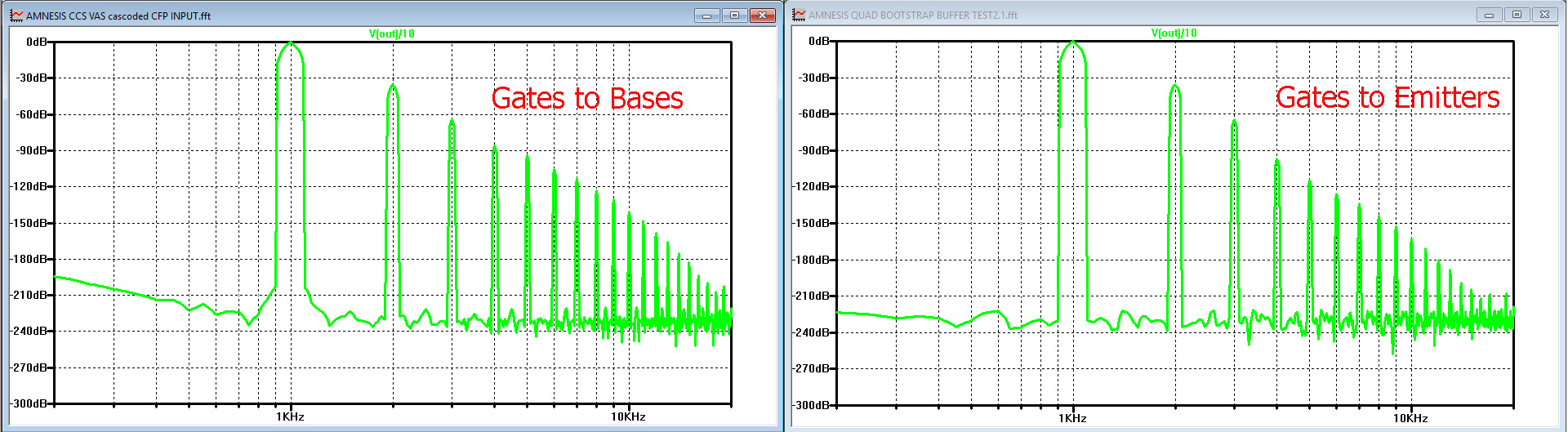

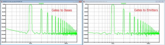

Then I paid some more interest in the input configs that you used.
And again, I hit large differences with the presented tables in Kolumnis book on page 140/141.
I used a differential input pair isolated from Vas and Output stage, and connected a 100K load one side to -22Volt and the other side to Collector Q13.
I gave a 16mV eff input signal causing the required 10V eff on the 100K resistor, just as Kolumni did. This calculated with into a gm of (10V/(16mV*100K) = 6.3 mA/V.
Distortion was measured between your double and triple bootstrapped input versions.
They were both exactly the same, but very much higher as in the book, meaning that he probably used a much lower output voltage !
However, when changing the connection from J1 and J2's gate to the lower side of R13/R14, the higher harmonics went down a bit, again exactly the same for both models.
Look at 5Khz, the 5th harmonic went down by a factor 10 or 20dB.
In your listening tests it might be good to include this option.
See the image below for the two different gate connections.
At last, I tried to modify your triple bootstrapped version just as in Fig 5.28b in the book, as well with Q4 as a Fet and with a transistor.
I also tried with ideal voltage and current sources, but never got the combination stable, again raising my doubts whether this combination was ever tried in this form.
Hans

I'm not so sure what you mean with "buffer" on the title.
To show you what I did, have a look at the two versions of your triple bootstrapped input circuit in the .asc file below.
Difference is the connection of the two gates.
Output is 10Veff@1Khz on a 100K resistor, like Kolinummi did.
With yout dual bootstrapped version I did exactly the same.
Ah! very interesting. I tried to connect that way the second cascoded BJT but it cannot be done. Is it right to have a voltage output instead of a current output? Can they be compared?
Unfortunatelly, when I tried the gate-to-emitter mod on the "QUAD" the stability margin decreased and the THD deteriorated several orders of magnitude... :confused:
Anyway, isn't the whole arrangement (bootstrapped cascoded-CFP) susceptible to thermal analysis? Can you see what happens to the JFET?
As I understand, it is not the absolute value of thermal production but the alteration of it following the non constant musical signal. Maybe non-periodic bursts of square waves could show something useful...
Hephaïstos measured single wave effects on Vbe, if I remember correctly...I will try to find the articles...can you plot Vbe v/s time?

To be perfectly responsible to the hypothetical public following the conversation, today I tried the Bootstrapped Darlington output :cool: which may appeal the more simplicity-inclined DIYers...
It works, but with the 10/15 Ohm stopper gate resistors for the MOSFETs it oscillated beautifully at +/-12.5MHz, so in my despair, I increased R43 (N channel stooper) to 330R and that stopped the overt oscillation. I may have to increase also the other one for a small tendency to widen the scope line at negative power peaks...and also the perfect (lowest) value must be explored.
How does it sound on first minutes? all-rigth, but I would say a bit less dynamic, especially noticeable on midrange and HF, less focused. It could be a "burning-in" problem. I will update this. You see, with my Amnesis QUAD the sound must jump out the speakers. Once you get used to this, you detect
the lack of it easily...
M.
