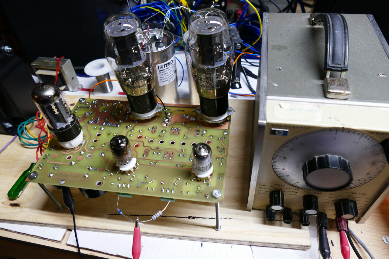

I have been working on the next generation of my TSE amp designs, and there is one connected up and running on my bench performing such an experiment shouldn't be too difficult, I could just remove the load from the OPT, but leave it in place to act as the plate choke. I would then wire up a large cap from the plate of the output tube to a load resistor, then return the load resistor to ground.
This amp is NOT and all DHT design, but the output stage is similar to that discussed here. One side of the filament is directly tied to ground. The grid is driven by a direct coupled mosfet follower which allows for A2 operation and eliminates blocking distortion. The plate goes to the OPT, which is fed directly from a CLC filtered 5AR4. B+ is about 340 volts with 45's. The driver tube is a 5842 high Gm triode, which is CCS loaded for very low distortion (around 0.2% at full output).

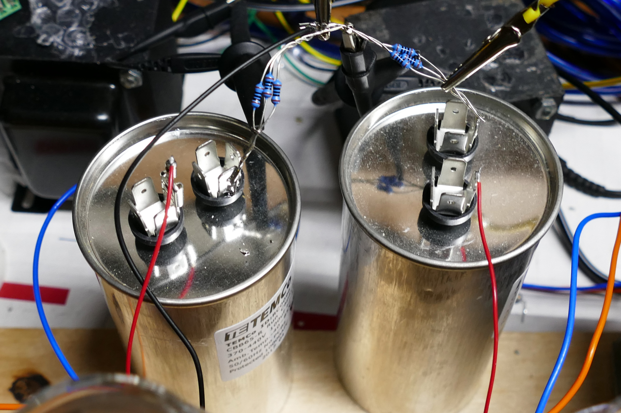

On paper a 10 uF cap is too small, so I grabbed a pair of 100uF motor run caps since I have plenty and they are quite good for audio. I didn't have any 32 ohm load resistors, but we are not talking big power here, so I wired 3 X 100 ohm 1% resistors in parallel.
I have no 6A4 tubes, and they won't fit my amp. The amp currently had 45's in it so I simply turned the idle current DOWN to 20 ma. I connected my cheap Philips DJ quality headphones up first. They are 32 ohms and capable of eating "2200 mW" so they have to be inefficient.....but efficiency is not specified. I have used these same headphones wired directly across the OPT output to check for low level hum, so I know how they sound on the same amp. Surprisingly they were quite LOUD, but not nearly as loud as directly from the 8 ohm OPT tap. The sound was good at lowish volume, but the bass got quite loose and boomy as I cranked it. It sounded worse than a SE pentode amp with no feedback connected to modern speakers. The mids and highs were clear and detailed, as good as through the OPT, possibly better on some music. Overall I preferred the OPT sound.

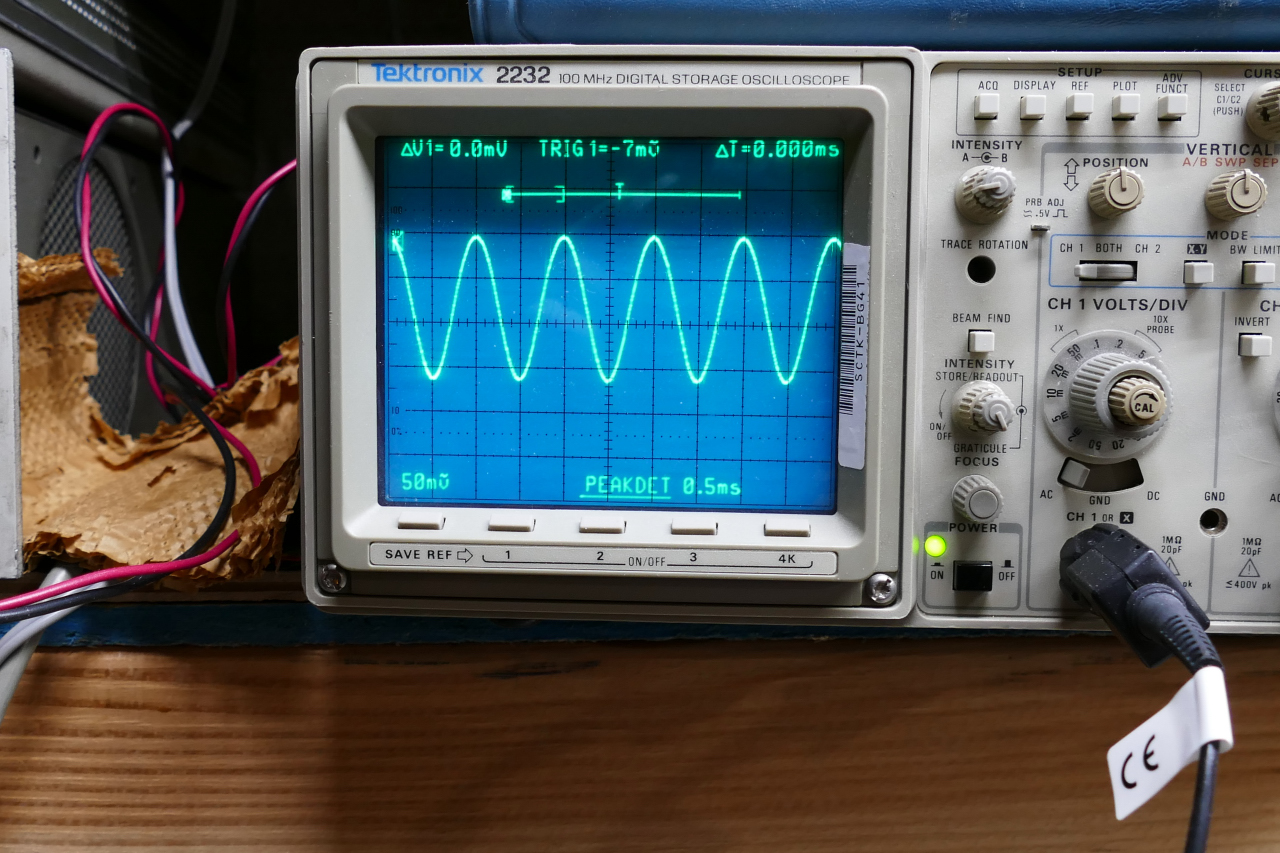

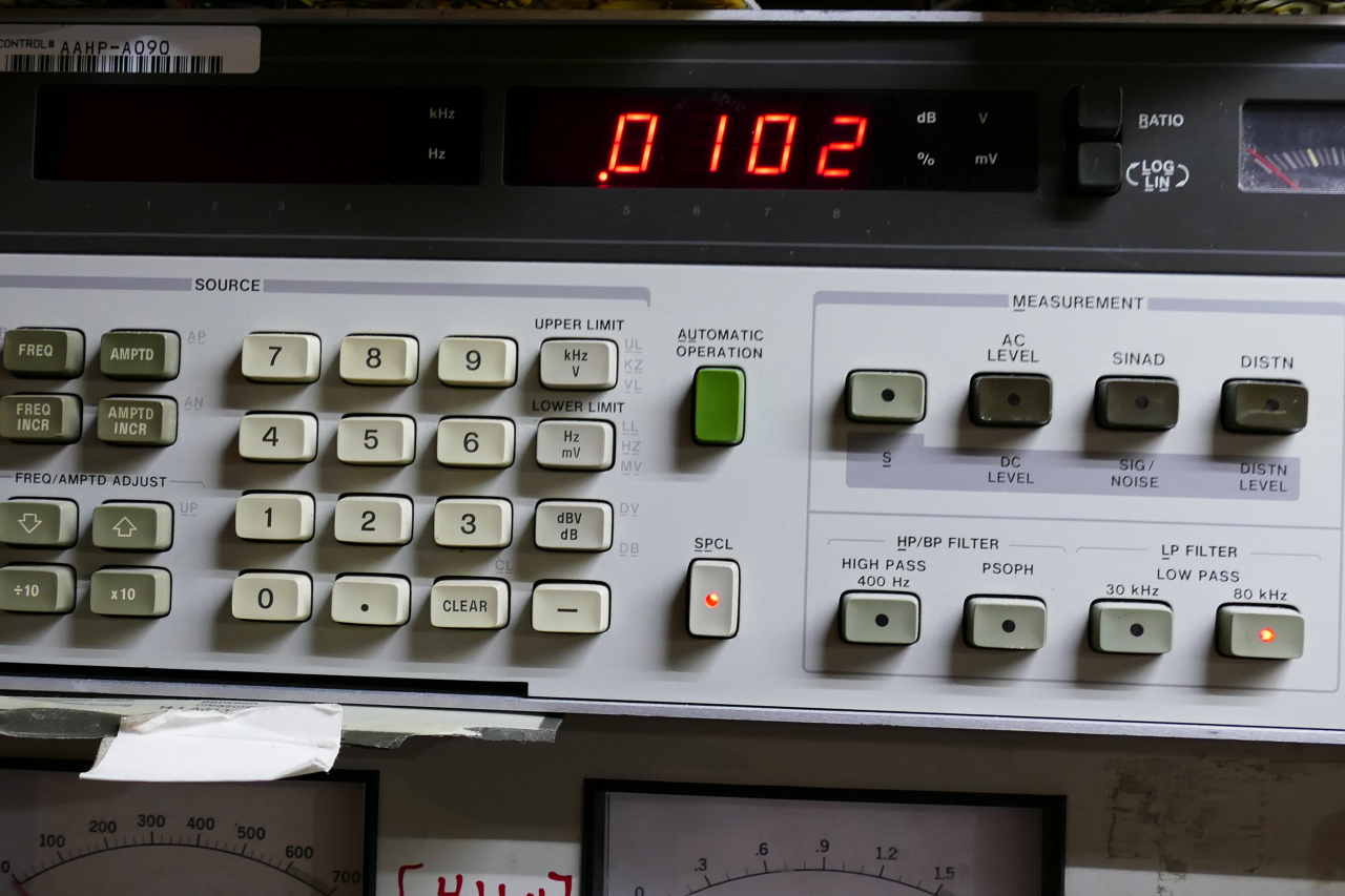

I connected up the scope, audio analyzer and oscillator. The oscillator I use is an old HP 204D that goes from 5 Hz to 1.2 MHz and makes about 0.1% THD through most of the audio range. 0.07% at 1KHz as measured on the HP8903A audio analyzer.

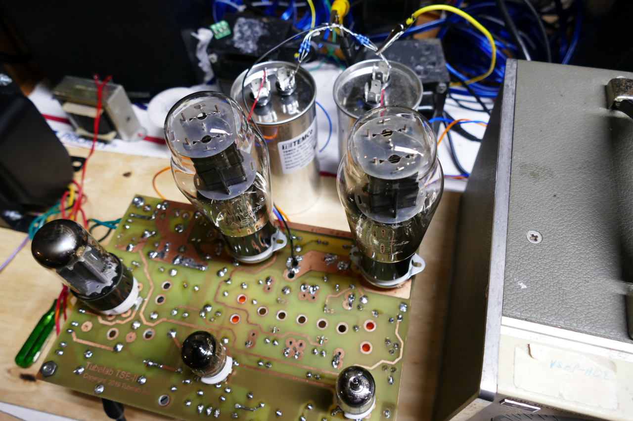

In a quest to find out if this concept was valid at all (remember the OTL for guitar thread that blew up) I stuffed some 2A3's in the amp and tried again. Again, better but the amp was obviously starved for current, so what to do but turn it up! After all, the OTL guys use AMPS not milliamps. I cranked the 2A3's up to 70 mA. Now the results were better, and the amp SOUNDED much better. The bass was tighter and less boomy, and it would get loud enough to hear it across the room from the headphones.

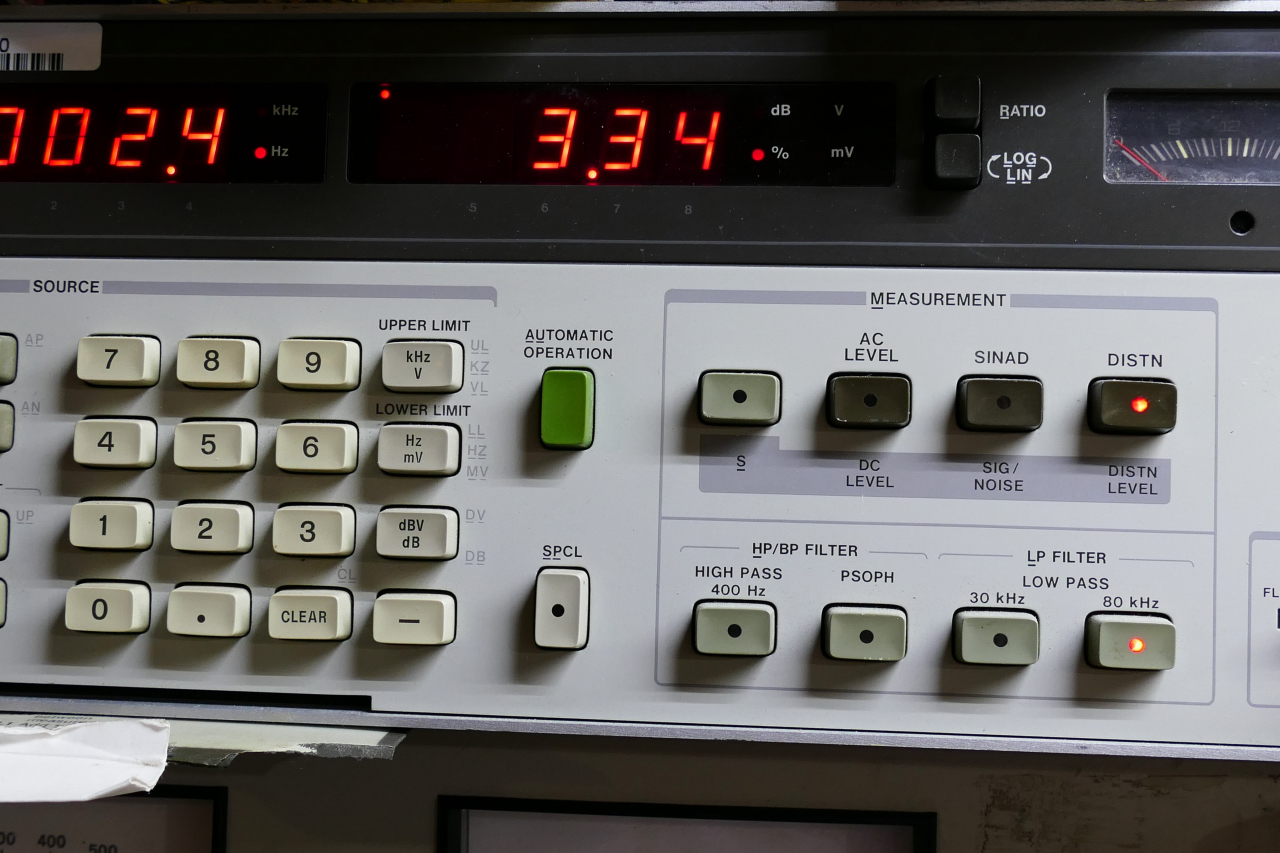

Where I could barely squeeze 20 mW at 15% THD with 45's at 20 mA, now I'm getting 100 mW at 13%, 50 mW at 7.6%, 20 mW at 4.1%, 10 mW at 3.34%, 5 mW at 2.1%, 1 mW at 0.97% and 1/2 mW at 0.5%. The lower limit on THD in this setup is around 0.5% due to the loose wiring, and the main THD component is 60 Hz (not 120 Hz).

The scope and analyzer pictures were taken with 2A3's at 70 mA and 10 mW output. Picture 507 shows "watts into X ohms" where I input 33 for X (3 X 100 ohms in parallel). Picture 507 shows the THD as 3.34%.

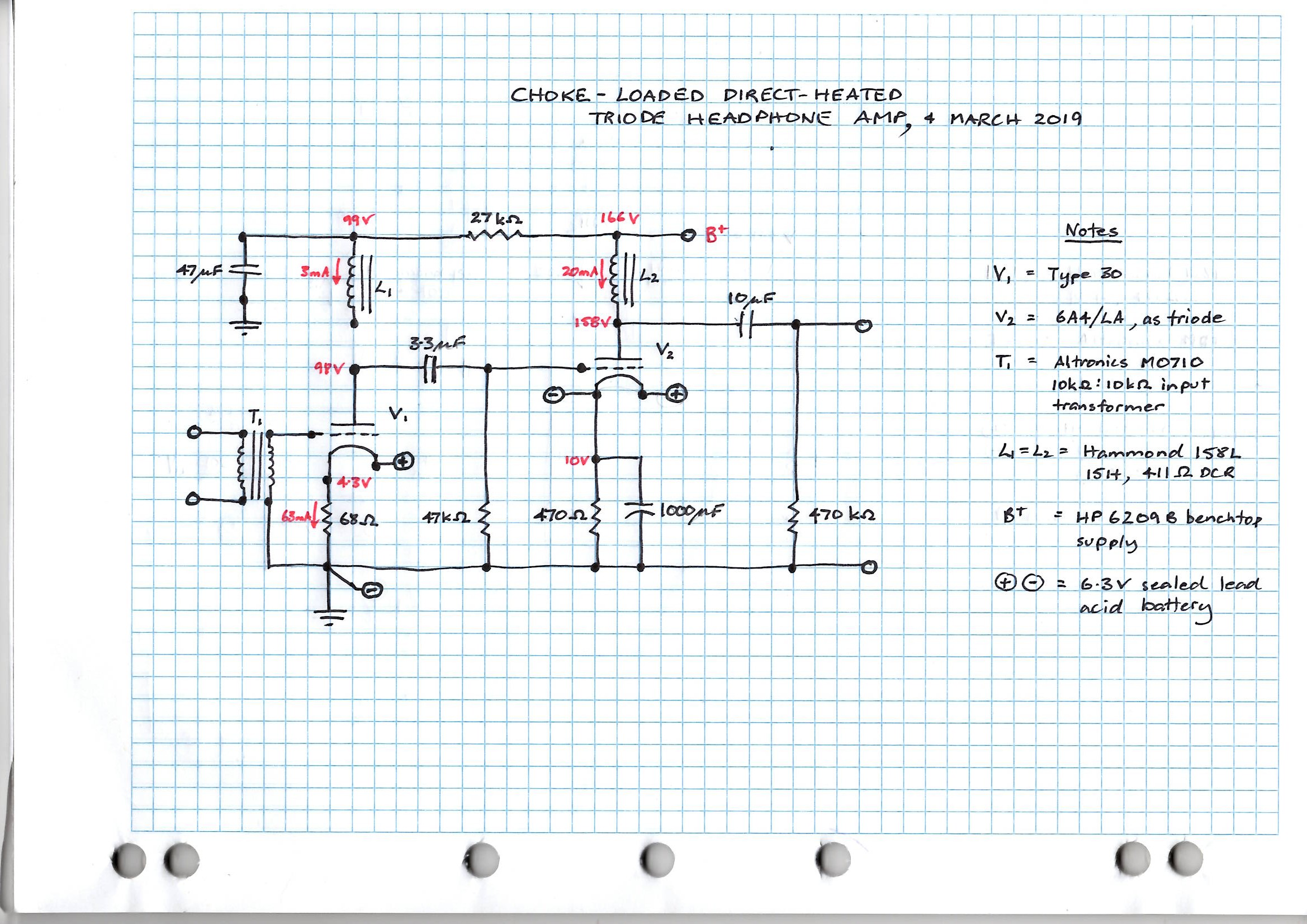

The real circuit is different than the one that appears on the schematic, one battery for two valves.
Cathode circuit of V2 is short circuited to ground on the battery.
Clearly seen on your own pictures, can you explain that?
What is the real circuit that you have measured?

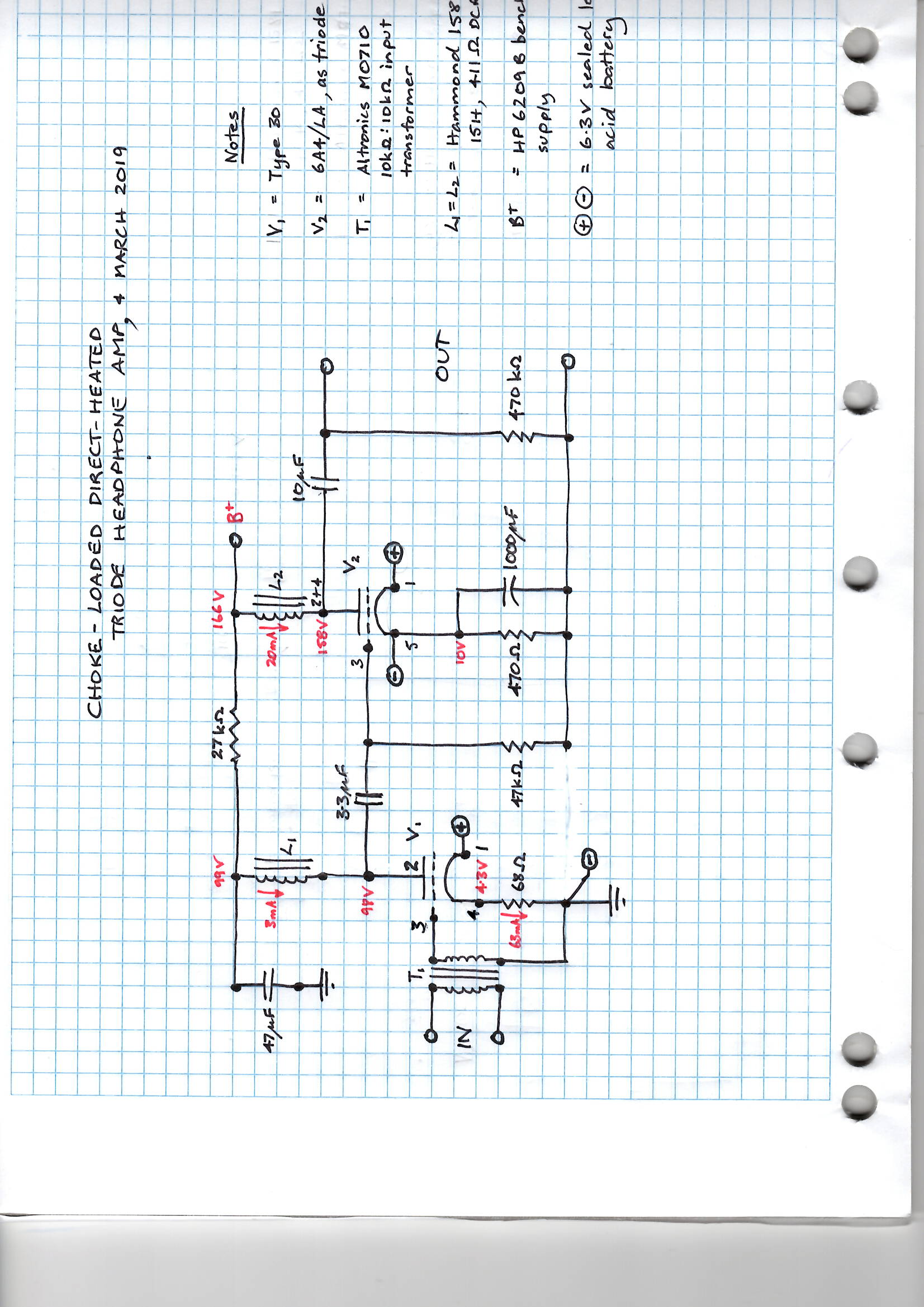

Thank you popilin - I can see two mistakes on my schematic and have attached a corrected version including pin numbers:
  • There IS a connection from the anode of V1 to its choke.
  • The is NO direct connection from signal ground at the base of the 68 Ohm cathode resistor of V1 to the lower leg of V2's 47 kOhm grid resistor
Yes, the signal ground for V1 AND the negative cathode pin No.5 of V2 are connected to the same negative terminal of the lead acid cell that heats their cathodes.

Also missing the battery, I have no DHT symbol, sorry, but now the circuit is more close to reality, especially the ground.
Sadly it was very difficult to decipher the circuit, your task, not mine...
Fortunately you are a great photographer! :p:D

We are getting close! Please pardon my schematic illiteracy - I didn't draw a battery but indicated a single battery with two leads coming from the positive terminal and two from the negative terminal.
For the type 30, the positive terminal of the battery connects to pin 1, the negative to the base of the 68 Ohm cathode resistor.
For the 6A4/LA, the positive battery terminal is attached to pin 1 and the negative to pin 5.
Put another way, Pin 1 of V1 and Pin 1 of V2 are connected to the positive terminal of the 6.3V sealed lead acid battery; and the base of V1's 68 Ohm cathode resistor and pin 5 of V2 are connected to the battery's negative terminal.
Why? I had one 6.3V battery.

You have a wire connecting signal ground of V1, negative terminal of lead acid battery connected by another wire to pin 5 of V2 at 10V? If your measurement is correct then there is a wire with 10V potential difference from end to end.

I see your point - I have not correctly referenced the voltage measurements for V1. My schematic evolved along with a rats nest prototype - Popillin has posted a tidier version that accurately reflects V1 voltages elevated by 10V relative to a signal reference at the base of V2's cathode resistor.
The extra 10V can be "lost" across the 27 kOhm dropping resistor from the B+ supply.
