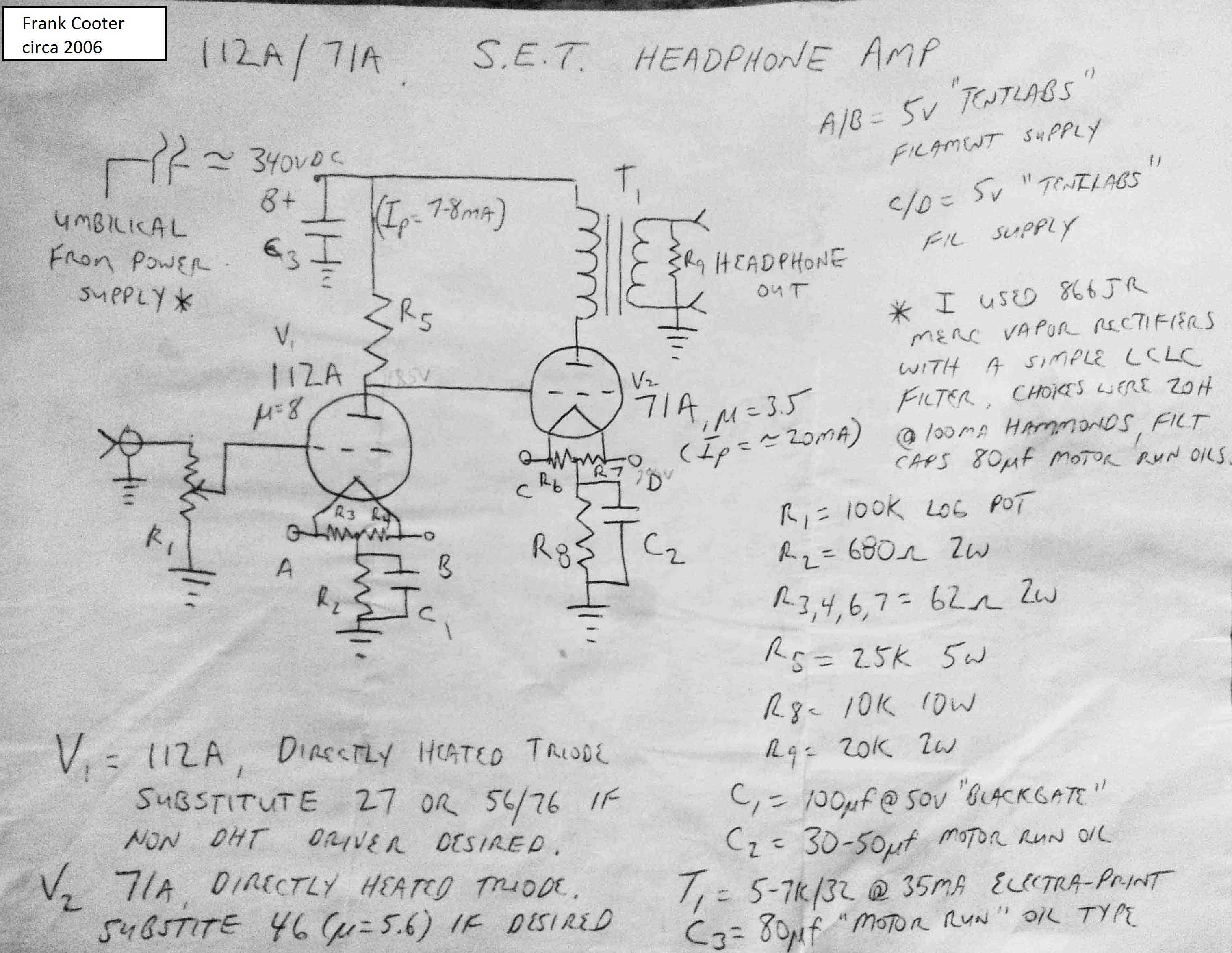

Now to the topic at hand as we now have our design goals. And I will start by posting the first all DHT headamp designed by Frank Cooter several years ago, the idea has been around for a while.
An all-DHT setup will sound amazing, but not easy nor cheap, maybe too expensive on an engineer's salary. 2 stages would work for Grados and Denons but not for some other headphones. You really need 3 stages.
In the schematics, replace 112A with something available like 26 or 4P1L, and 71A with 45. Add a 300B output stage. Replace resistor loading with CCS loads. Will sound brilliant. One day I shall build one.
The schematic I posted is a starting point for the discussion, circa 2006. We diyers have come a long way since. Its a discussion opener thats all.
I do disagree that three stages are necessary. a single 4p1l can drive a 2A3 into clipping with a modern DAC as source. Sims are showing that #1 & #2 can be driven with possibly even a single 4P1L. Gain is an issue but any gain higher than the bias of the output triode is wasted gain, especially with a mu-follower gyrator load on the driver.
Going from the "purity" of a spud, I would really not want a 3 stage tube amp, it may help a little with #1 & #2 but it would hurt #3.
You are right, we should use 2 stages of 26 or 4P1L, followed by 2A3 or 300B. We want the gain without resorting to pentode mode to get it.
More stages would only increase transparency by cancelling distortion. Trust me on this one, I've tried EL84 driving EL84 and it measured better and sounded better than being driven by anything else I've tried. The only requirement is that a good coupling capacitor is used. The tubes themselves are very linear.
I agree that distortion cancellation is a bit unlooked with SET's. I've simmed driving the 2A3 with a lot of tubes and this is getting off topic but the 6n6p beats anything by about 20 db, yet has more distortion on the 2A3's grid than a D3A or 6c45pi. 2H cancellation is the only explaination.
But I guess I want to keep this amp simple and relatively cheap. I am completly open to ideas but think it best kept a 2 stage amplifier. And I think with the right OPT a 2A3 is too much.
A 4P1l is really what I am leaning toward as an output tube. It can handle the 1W output which covers nearly all orthos except the HE-6 which is probably not worth designing for (its a specialist amp.)
For the driver the choice would be another 4P1l for gyrator-cap coupling, or alternatively a #26 with its lower plate voltage would allow a DC coupling to the 4P1l.
Now honestly I am still "open" to the idea of a 2A3 but I think a 300B is too much, powering it and the size of the OPT would degrade performance for the sensitive/efficient phones like Grados, Senns, modern AKGs.
The real secret to the whole thing is the right output transformer. Headphones like Grados/Senns/AKG's will lose low level signals with a big 4 lb transformer. We are talking about the first milliwatt with these types of headphones. I hope this thread brings a few output transformer experts out of the woodwork 😉

I'm thinking 4P1L > 4P1L. The operating points are quite well established by now - see the 4P1L SE thread. They can both be used in filament bias - no cathode bypass caps. I'm also thinking transformer coupled stages - I use a Hammond 126C which works fine. Alternatively some kind of direct coupling, but hopefully without a cathode bypass/ultrapath cap.
How about using line transformers? They may have issues with the DC plate current, but aside from that I'd think they'd be about perfect.
~Tom
The problem is too much DCR, it affects the frequency response of headphones like Grados, Denond, AT's, modern AKG's, etc. Most line output transformers have a DCR over 100 ohms.
I think we should focus on the tubes first then hopefully Bud P or one of the other few remaining OPT experts can point us in the best direction.
For the output tube I think my vote is the 4P1LE, its cheap readily available, very linear, and capable of over 1W output. It also has a lot of gain which makes it easier to reach the overall gain we need with a driver like the #26 or another 4p1L.
The driver is a bit of a tough choice. Going off Cooters design he wa very adamit about DC coupling. If we use a #26 the plate voltage is low enough to DC couple and still use an SSHV2. The with DC coupling is the large bypass cap on the output.
Now the biggest question I have is something I have pondered since I first so that schematic is how to get rid of the bypass cap and DC couple. Negative supply for the input tube?
Or with a modern Gyrator Mufollower on the driver maybe we don't need to worry about cap coupling to the output stage? Then we could filament bias both the tubes.
