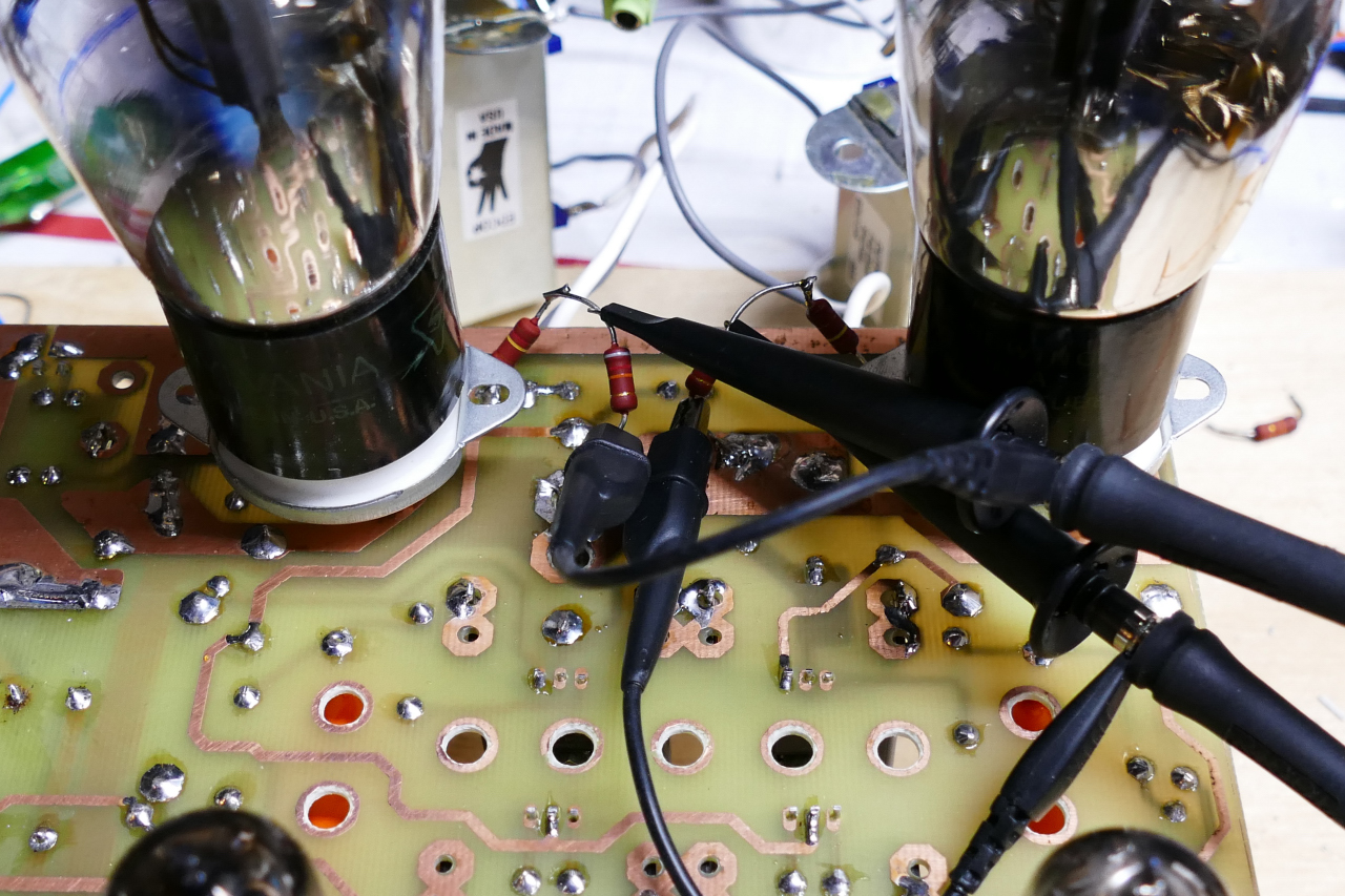

I'm including 3 pictures. The first shows a voltage divider wired from plate to ground of each channel to prevent blowing up my scope from high plate voltage. The scope was then adjusted with the aid of a DC voltmeter such that each vertical division represents 100 volts, with zero volts at the bottom of the screen and 500 volts in the center. Each of the two channels is connected to one of the output tube plates.
Both channels were driven from the audio oscillator at 1KHz. One channel was loaded with the OPT which has 33 ohms across it's 8 ohm secondary (roughly a 20 K load). This output feeds the audio analyzer for THD and power output readings.
The other channel feeds the same OPT with it's secondary unloaded, but the 100 uF cap in series with 33 ohms is tied across the primary (parafeed OTL).

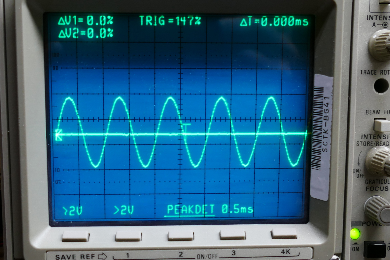

The second picture shows the plate voltages with the input turned up such that the lightly loaded channel is making about 1 watt of output power and it's THD was in the 1% range. It's plate voltage swings from about 200 volts to almost 500 volts. The "32 ohm" channel is stuck near 340 volts (B+). It is moving up and down by several hundred millivolts, but that's not visible at 100 volts per box on the scope.

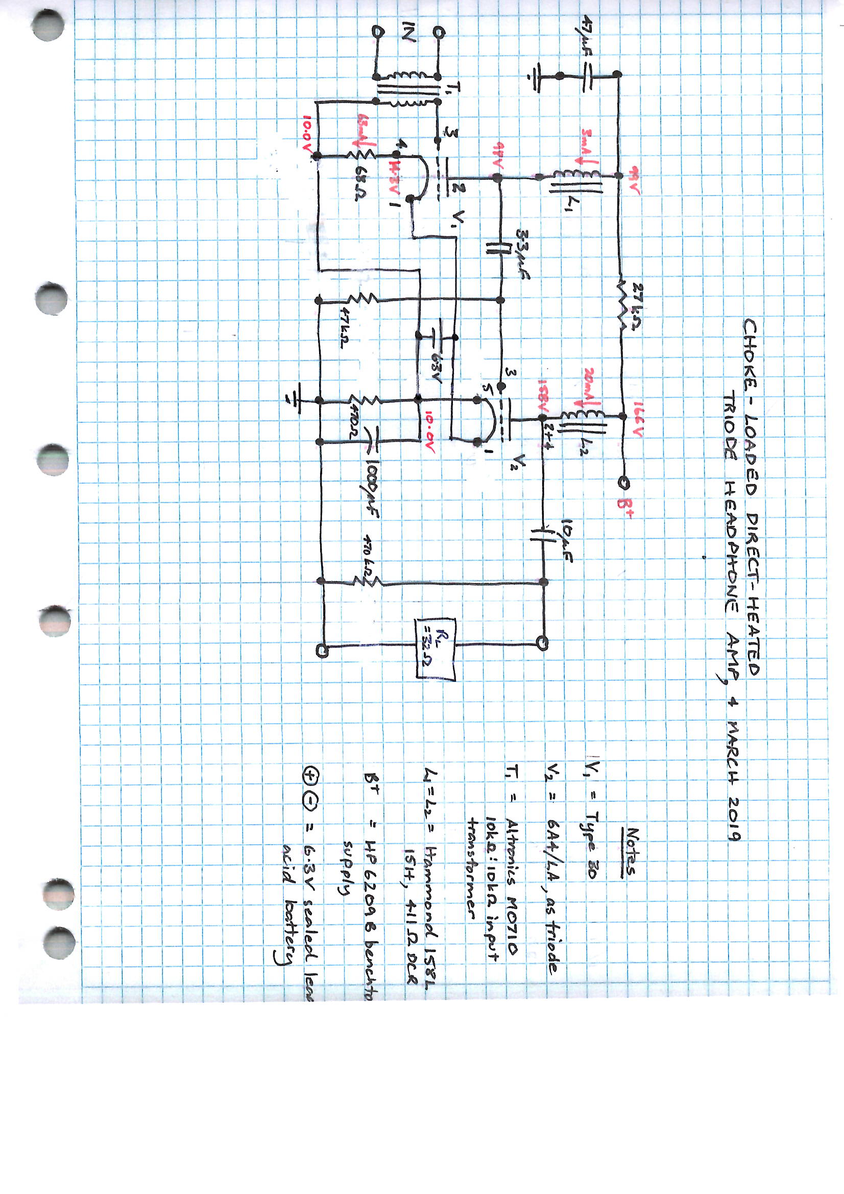

Hi TheGimp,
I've tidied up the schematic to show the 32 Ohm load and the sealed lead acid battery that powers the filaments. This shows more clearly that the base of the type 30's cathode bias resistor and the top of the 6A4/LA's cathode bias resistor share the negative terminal of the battery. Similarly, the positive battery terminal is shared by filament heater pin 1 of both valves.
This arrangement was very much a matter of convenience (I was experimenting, running through several topologies, didn't want to build heater supplies, was relying on the only battery I had, a 6.3V SLA) and serendipity (hey, maybe this will introduce a bit of negative feedback via the cathodes?). As you can see from the measured output, it's below the 1V rms input for a circuit that could probably deliver open loop voltage gain of around 50, so there is probably a bit of feedback lowering the gain and the distortion.
