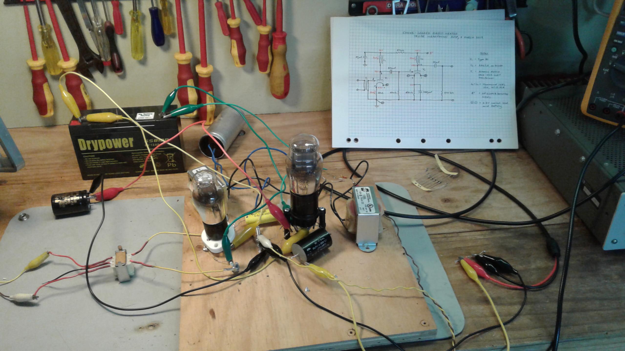

I encourage you or any other interested reader to experiment and discover my mistakes. To help, I have posted my schematic diagram, a picture of my rats nest test rig, details of the equipment that I used, and the basic results of the tests.

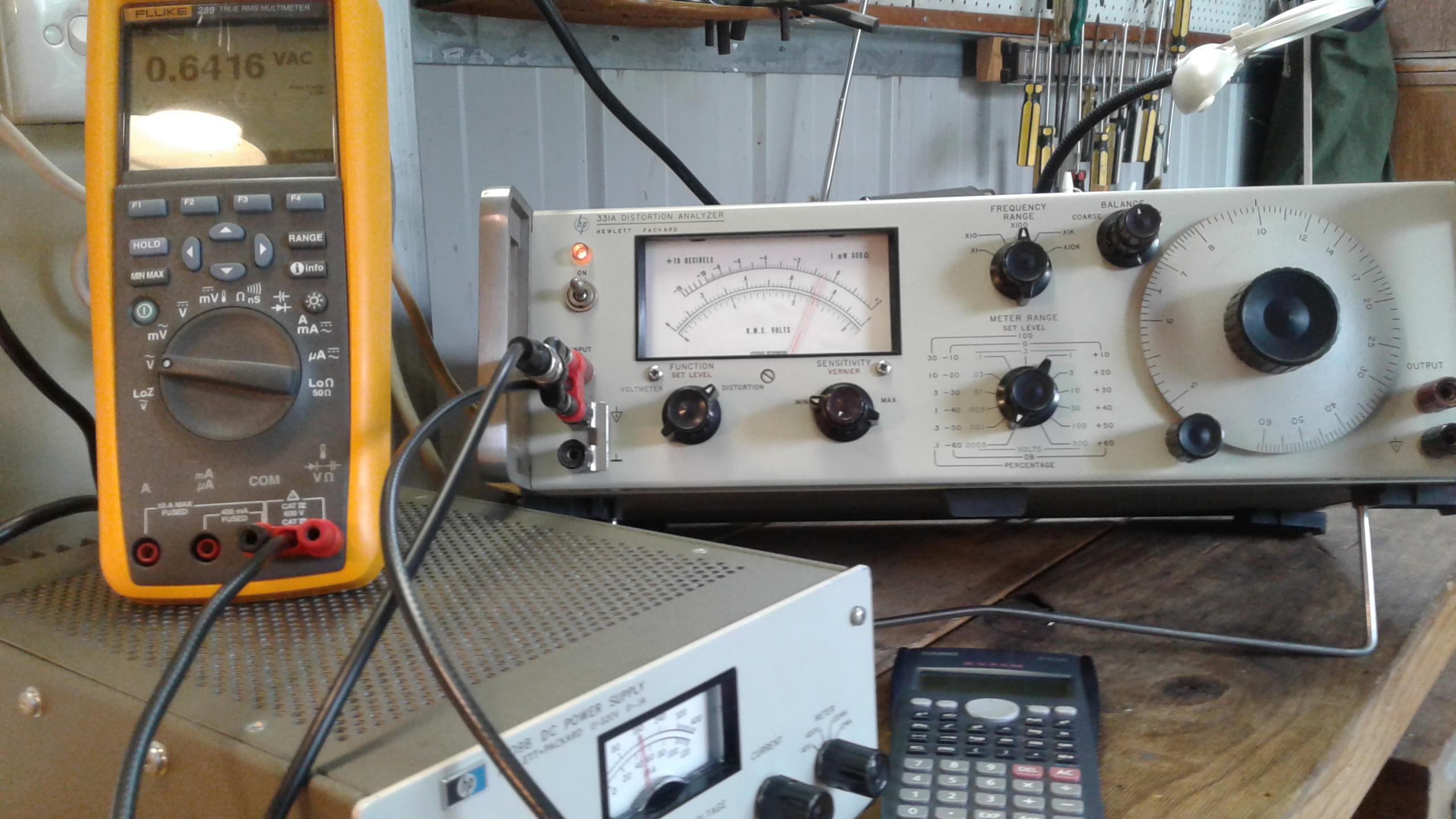

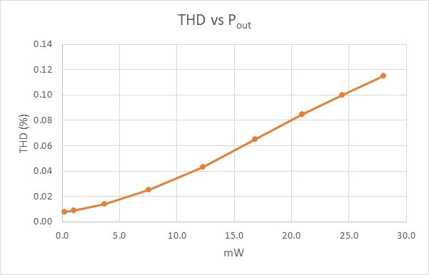

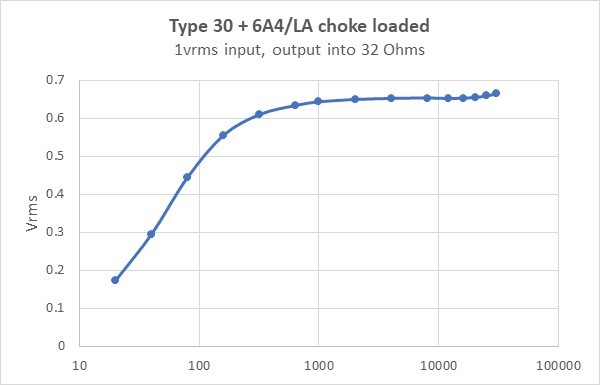

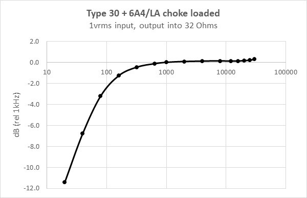

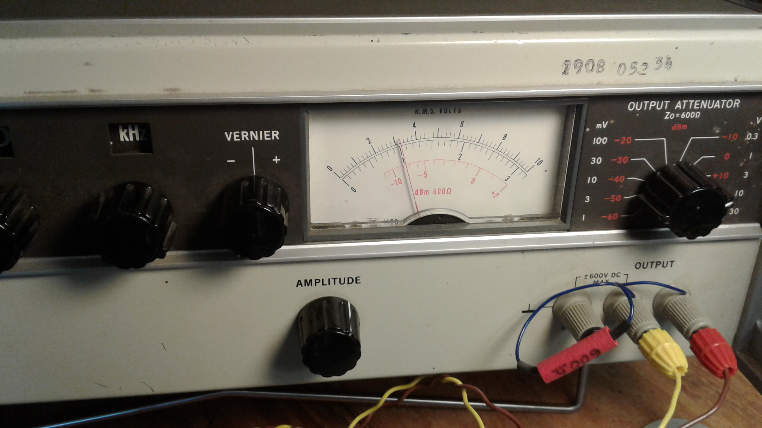

The results this time were that 1 Vrms in gave 12.3 mW into 32 Ohms with .043% THD. The frequency response was better behaved this time and is down 3 dB at 80 Hz.
I have attached images of the HP4202 input oscillator, the re-built rats nest, and the Hp331A with the Fluke 289 sitting on top showing the RMS output voltage. I have also attached plots of the frequency response (dB relative to 1 kHz, and Vout rms versus frequency) along with a plot of THD versus output at 1 kHz.

Wow almost 30 mW with 0.12% THD! Why don't you show the load in schematics and the test points for the signal measurement?
As it is your circuit cannot manage more than few mW's with acceptable distortion into 32R, IMHO. Certainly not 0.04% or so...... This numbers are really questionable and it is really unclear what you measure and how you figure them out even assuming that all your tools are ok.

Of my tools, I most trust the HP4024A oscillator and the Fluke 289 - the HP has been refurbished and Fluke is factory calibrated. I am confident that both are correct.
The RMS voltmeter of the HP331A gives readings very close to those of the Fluke. The distortion measurements have been good in the past, and I assume they are still good, though I have no instrument with which to correlate or check them. I cannot say for certain that they are correct.
