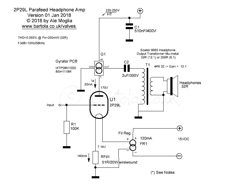

I wouldn't go for the 4P1L myself. After using it for many years you will suffer with it due to its microphonic noise. You are better off with the 2P29L. It sounds as good and has no microphonic noise at all. It's dead easy to implement in filament bias as it only needs 120mA
I've a pair of Sowter headphone OPTs which are great. You can wire it to 32 or 250R headphones. I have both. Both frequency response and distortion harmonic profile are great.
I love the sound of the Sowter. I've tried it with many DHTs and IHTs. My latest test was with the EML20A which has a mu of 20. Very detailed and great sound. A bit tricky as it can pick up hum due to its large mesh plate.
With the gain of the 2P29L which is about 8-9, you will need 4Vrms to deliver 250mW on your headphones. It'd be ok with normal line output levels as 100mW is already too loud.
Hope this helps to inspire your design
Cheers
Ale
It has a higher anode resistance, about 3K. It doesn't impact in a hybrid mu-follower topology as the output impedance is given by the lower FET of the gyrator (1/gm) which is generally between 5 and 50R depending on FET and bias current. You can open the 2P29L and see a lovely valve:

http://www.bartola.co.uk/valves/wp-content/uploads/2018/04/2P29L-Headphone-Amp.jpg

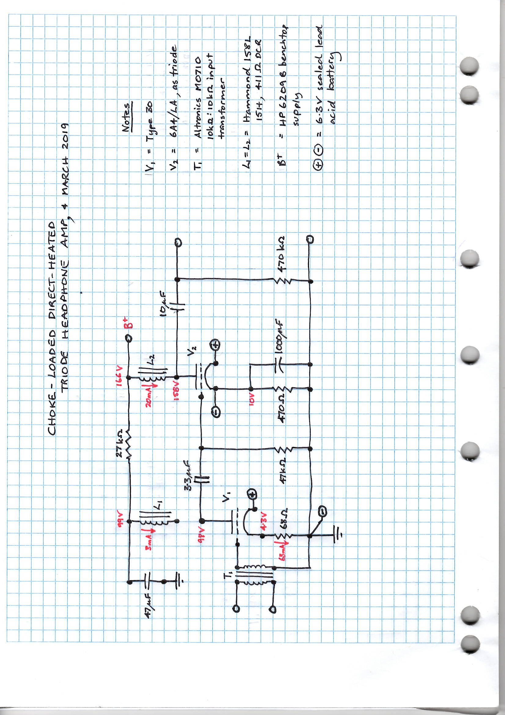

Type 30 + 6A4/LA headphone amp chock full of chokes

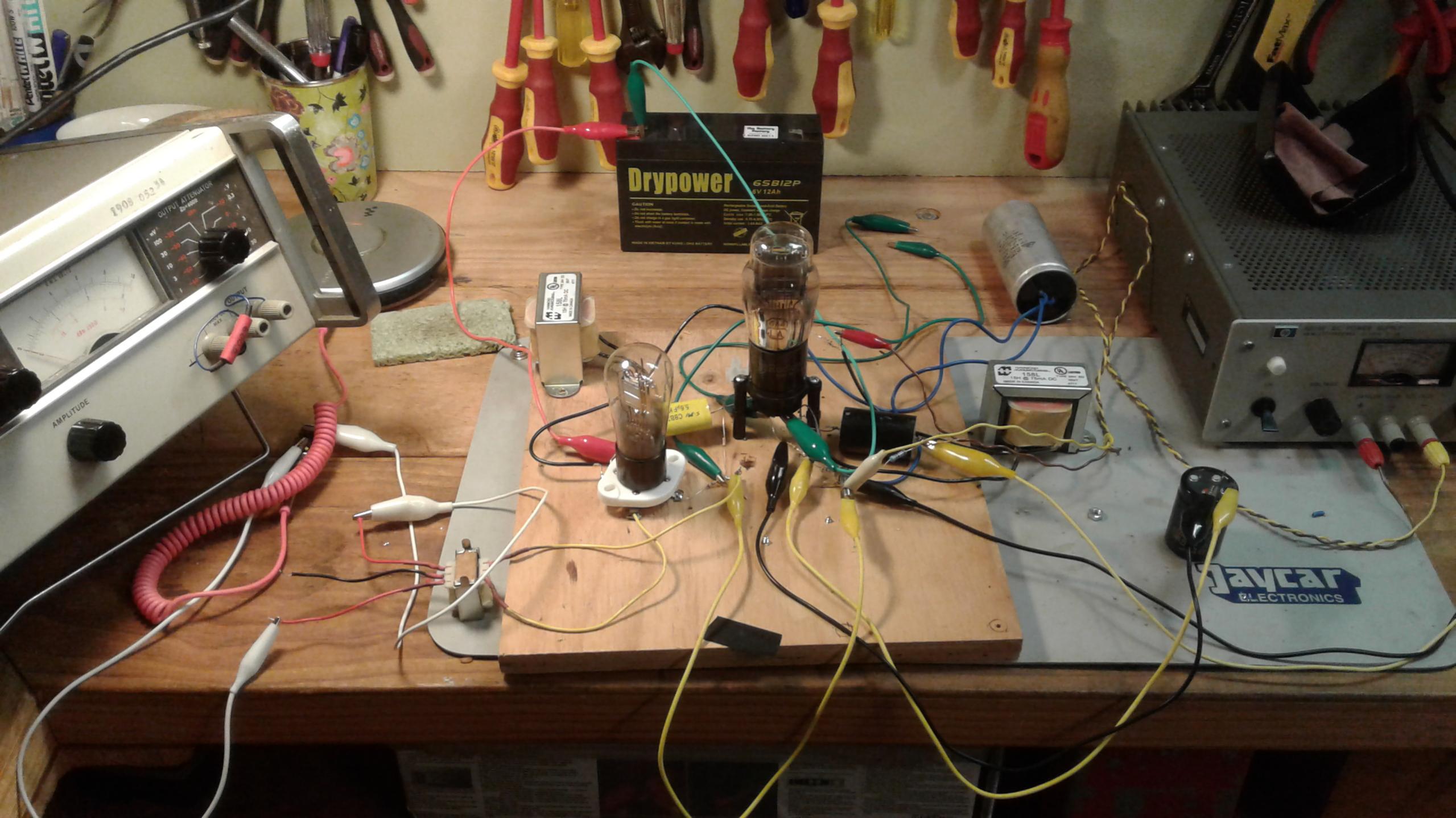

I read (most of) this thread and started playing with DHT headphone amps on my workbench with whatever was in the cupboard.
Without any suitable output transformers to hand, I played for a while with cathode follower amps. Hmmm .... not so promising. Maybe with a choke at the cathode load? Well, I had power supply filter chokes to hand, so I tried them too. Better, but not that much better.
Then I tried the chokes as anode loads. Much better! I fooled around with unsuitable inter-stage transformers too. Promising, but bass response was compromised.
So, back to RC coupling and a line input transformer. At last! Listenable! and not bad on the measuring instruments either.
The first valve is a type 30 - the octal equivalent is the 1H4G, very cheap - loaded with a 15H Hammond choke. I've used the heater current (60mA) to assist cathode bias resistor to give a convenient 6.3V total voltage drop across the heater and the 68 Ohm bias resistor. Keep it simple. The type 30 is biased at Vgk=-4.3V, with 3mA of anode current. Gain is about 9.
The output is RC coupled to the grid of a 6A4/LA wired as a triode, loaded with a second 15H Hammond choke, drawing 20mA anode current - the valve is idling and has voltage gain of about 6. The 6A4/LA is cathode biased to Vgk=-10V and fully by-passed. Output is standard RC coupling.
The 6A4/LA has a 6.3 volt heater, sharing the same sealed lead acid battery as the type 30. The B+ is my not-so-quiet HP6209B bench-top supply.
The results? 19mW into 32 Ohms @ 1kHz, output impedance of approx 100 Ohms and THD of 0.04%. The output is -2dB at 20 Hz then +- 0.5dB from about 150Hz to over 40kHz. Quite listenable through 32 Ohm Audio Technica AD700s and 600 Ohm Sennheiser HD40s.
Pros? Listenable performance from (relatively) inexpensive chokes and valves.
Cons? Bulky and will need a VERY Quiet power supply.
I think I will build this one. 🙂
