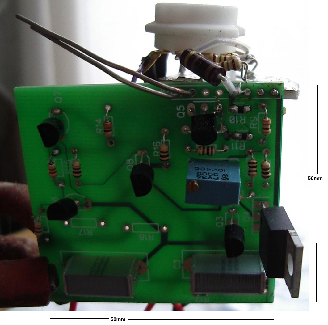

All we need is a PCB 😱
I agree with what you are saying completly but there is always the chance that .75W isn't enough, what if in a year the new HE6 takes 2W. After building the "perfect" SET for Grados I look for this DHT build to provide exponetially more power so the latest and greatest will "work". I like playing with designs and research, but actually sort of desipse casework, so I am after something that will last
It seems like your design goal should be for a case and layout that easily allows component changes and additions rather than for an omnipotent electrical circuit. Maybe that sounds a little smart-alecky but it is truly intended as something constructive and pragmatic about how you are approaching this mentally.
My PCB already exists for shunt cascode.... but this application would require some updates, and add the shunt regulation for the bias and cascode voltages.
The shunt regulator design is already laid out as a separate board. It's an ultra-low-noise design with discrete-transistor error amp.
A new PCB (or PCB set) is possible, but will need some development & 'productionising' work to make it suitable for widespread use.
One consideration is that surface mount parts are really needed for best performance - including chip ferrites and SOT23 transistors. This would also allow much smaller PCBs - eg the shunt regulator is only 78 x 32mm, as it stands, and looks rather like my filament supply boards!
Maybe I will need to assemble them.
The other consideration is that I am looking for a DAC myself, and don't like any I have seen so far. The I/V converters don't seem completely satisfactory either....maybe I like that DAC current-out design enough that I will make a PCB with this - and an ESS9018 added, if only for my own system. I design computer boards for a day job, so the layout problems are well understood.
Anyway, I'm working on the basic boards, and if they look worthwhile for manufacture, I can always get some fabbed up.
