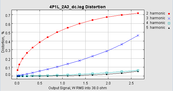

Serving suggestion for 4P1L - 2A3 dc coupled.
to keep Anatoliy happy, the 2A3 anode current servos the operating current of the shunt cascode, to give dc-stabilised operating point.
2A3 needs -100V bias supply (10mA), but this does give a startup voltage of -100V, to be kind to the 2A3.
Darlington connected PNP shown. NXP Semiconductors PBHV9040Z assumed for main PNP. others are -T package (SOT23) - so yes, PCB needed for correct layout.
To keep the 400mV (pk) sensitivity, the gain of the shunt cascode is increased to 62, to allow for the low mu of the 2A3. It's the beauty of shunt cascode - you can set the gain independent of the stage's triode current.

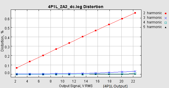

Thanks Rod, just now had a bit of time to quickly simulate this. For those interested in the harmonic profile here is a view of the output and the 2A3 grid (or the 4P1L output).
interesting to see that the shunt cascode performs superbly and provides H2 mainly from the 4P1L whereas the output stage obviously increases H3 as expected

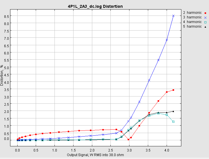

thanks for the plot, what is the max, can it take the 2A3 up to a higher output around 3-4W whch should handle the HE-6 and AKG 1k, then all the "top" 50 dynamic headphones would be covered.

Here you go. Interesting to see the H2 cancellation close to 3W but with an increased presence of H3 🙁

For 1W output this is remarkbly similar to what I got for real with the best 2A3's. Typically is a bit worse.

Maybe you'll get better results at low levels if you use a 4P1L as output device or use the 2A3 with higher primary impedance.
