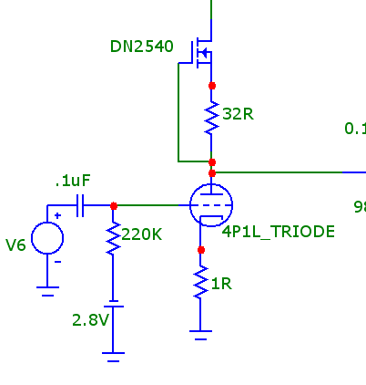

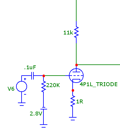

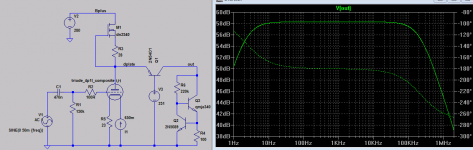

Running my input 4P1L with a CCS at 21mA does not seem to buy much gain. With an 11K resistor gain is about 7.5. With the simple DN2540 CCS gain is 8.8 Not much to write home about.
Perhaps I'm doing something wrong? See attached.
(note: I had to use 100R as Rset on the CCS to get 22mA, not 32R as shown)

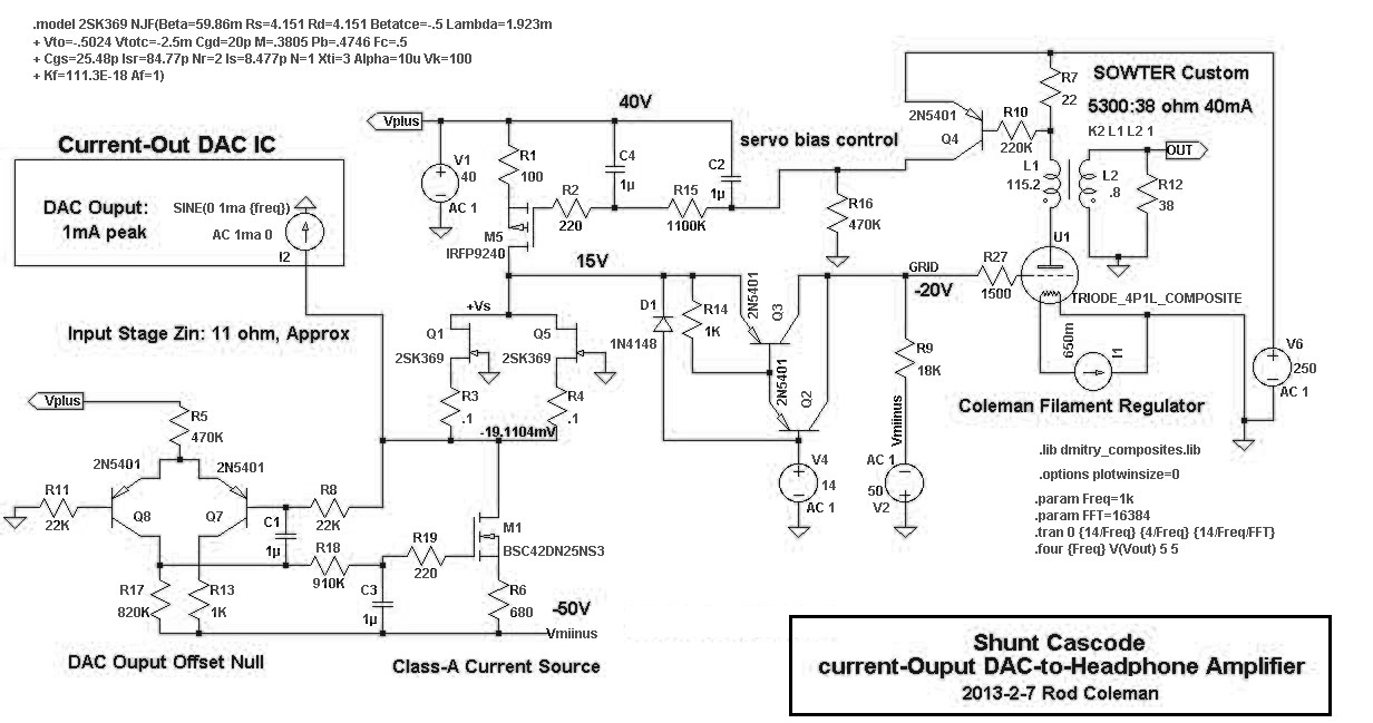

And if not for the 2A3, what do you think of a design where DAC (via high voltage opamp I/V circuit) drives the grid directly, eliminating the need for a DHT driver? No need for an interstage capacitor or transformer then, just one power DHT stage, whatever acceptable type it might be. I don't see the downside, but there should be a downside..

This is a splendid idea. And the HV opamp is not even needed...
Not only can the triode stage be eliminated, but the whole of the conversion from 1mA peak of DAC output can be dc coupled to the grid of the output DHT.
The circuit is, of course, shunt cascode. In this case, we use high-gm JFETs in common-gate mode, to present a low input impedance to the DAC.
The lovely 2SK369/LSK369, for instance, has a gm of about 45mA/V even for the Green grade, if run near IDSS. With 2 in parallel, we can get the dynamic input impedance down to about 11 ohms.
Shunt cascode does the rest of the work. The JFET drain voltage is fixed at 15V or so, and a nulling circuit balances the combined IDSS with a class-A current source, to maintain zero volts at the DAC ouput. (This can easily be changed to any value of offset, if you have a TDAxxx DAC).

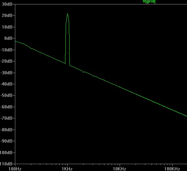

The best is yet to come: this circuit can deliver dc-coupled output to the 4P1L grid of 18V peak (from 1mA peak input).
The FFT is of this grid voltage shows no sign of any distortion - because there is no reason for any: the JFET gm varies less over the 1mA swing than any triode, and the drain current varies very gently with drain voltage.
The attached FFT is shown for 35V peak-to-peak grid voltage!
The output is just Idac x R6, so you can set the gain lower, if you like.
You're not doing anything wrong - it just highlights the difficulties with conventional design.
The 4P1L has reasonable gm (maybe 6mA/V), but the Ra is so low that the anode current (the signal part) is wasted in it.

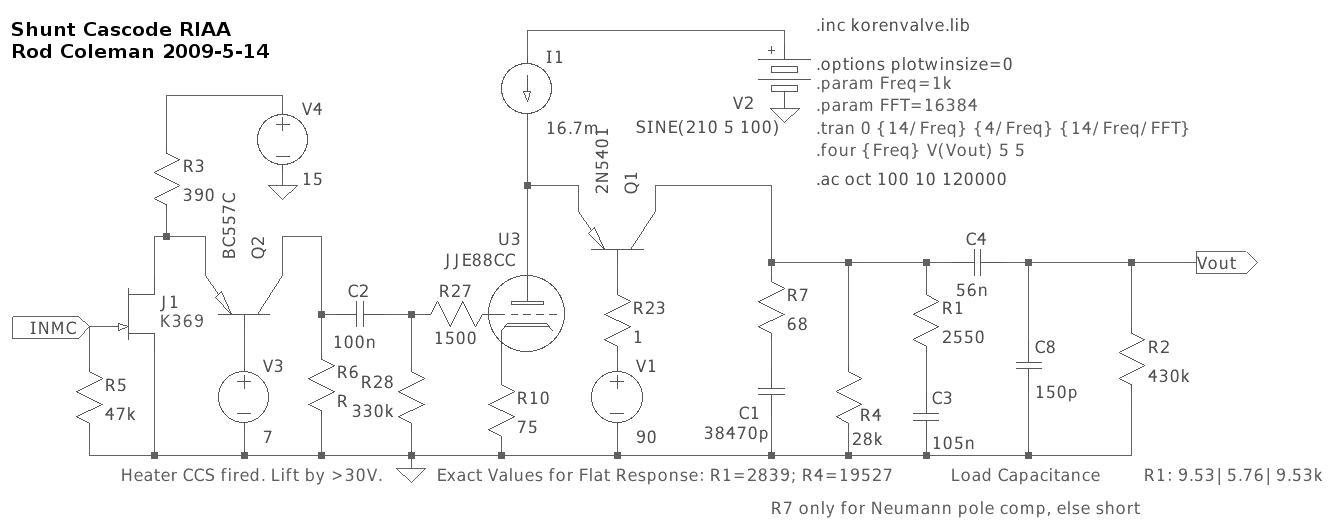

A gain of about 9 is the most you can expect, unless you shunt-cascode it - where the gain can be 50, 70, or even more.

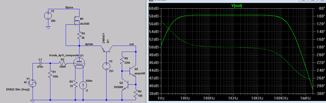

One stage that gives you a gain of 794 (58dB). One cannot deny that in the "shunt cascode" the bjt DOES amplify the signal. Whether this is desirable or not is a subject for another discussion.
With a current source load, the gain is somewhat uncontrollable (just the same as with a bog-standard common-emitter amp with CCS load). This circuit would have to be used in a closed-loop amplifier.
Nonetheless, you can build a shunt-cascode amplifier with a (say) E180F (6688?), and use its gm of 21mA/V and a 30K resistor, and get almost the same gain with low distortion (dc servo needed though).
In all cases, the transfer function is:
Vout/Vin = gm x Rout [gm = triode gm, Rout = load]
In any properly implemented design, the BJT does not figure in the output - since the miniscule voltage and current errors it introduces are negligible.
you can calculate, or SPICE into the small hours, and you can build and measure, and you will find that this relationship is always true for any triode.
What's happening is that the problem Pano found (Ra reducing gain to only 8.8) is being solved by the BJT.
The BJT does not amplify the signal - it simply isolates the signal from the Ra of the triode. This isolation allows the load resistor (eg 6.8K) to develop high voltage without being molested by the triode Ra (eg ~1.5K for 4P1L).
So for a 4P1L, we can get a gain of -
6mA/V x 6.8K (= 40.8) ..............for shunt cascode
instead of the -
6mA/V x 1.5K (=9)....................for CCS load
