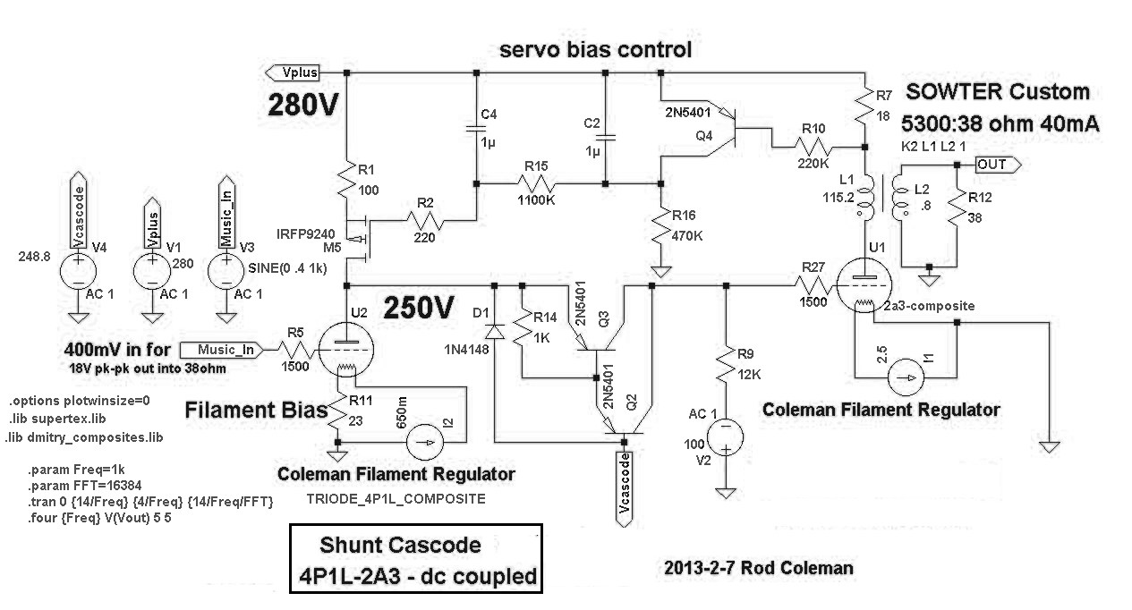

Serving suggestion for 4P1L - 2A3 dc coupled.
to keep Anatoliy happy, the 2A3 anode current servos the operating current of the shunt cascode, to give dc-stabilised operating point.
2A3 needs -100V bias supply (10mA), but this does give a startup voltage of -100V, to be kind to the 2A3.
Darlington connected PNP shown. NXP Semiconductors PBHV9040Z assumed for main PNP. others are -T package (SOT23) - so yes, PCB needed for correct layout.
To keep the 400mV (pk) sensitivity, the gain of the shunt cascode is increased to 62, to allow for the low mu of the 2A3. It's the beauty of shunt cascode - you can set the gain independent of the stage's triode current.

although I'm sure a basic schematic from this thread could be adapted to use other output tubes, as different transformers suiting different headphone impedances could be employed (has been said before).
The thread is most interesting, almost a perfect match with what I have in mind. There is one unusual option not considered yet (unless I missed it). Sorry if it crosses some unseen lines in the sand or is plain silly.
If the DAC is made an integral part of this design, and its I/V conversion circuit (with HV OPAMP) set to swing the required grid voltage precisely, the DHT part could be reduced to a single 2A3. Also the interstage capacitor could be eliminated.
What do you think?

I thought that's been covered. A classic two stage 4P1L->4P1L should be fine for most headphones, provided you use the right output transformer. The first stage can use a gyrator load like I showed earlier, or a choke load, or the primary winding of an interstage transformer if you have the financial motivation to buy a good one. The output stage is simple, a 4P1L and the output transformer. The operating points are easy to calculate once you decide which parts you want to use. If you want it DC coupled, that's doable too, as I've shown earlier in a schematic. I've left some details out, but it's easy enough to figure those out.
To improve on that, keeping it simple, one can use 2A3 or 6S4S in the output. Or, if you can find it, the 307A. That's what I'm planning to build 4P1L->307A, first gyrator load, AC coupled, output transformer, and then later try an interstage transformer.
What do you think?
I think that the 2A3 in general is not linear enough for this application. Regardless of the overall gain, at low output level distortion will always be a bit too much in you don't use feedback. Maybe you can find some 2A3's that are better than average but this means you cannot buy just two of them or two of them without tight selection. More likely you will get a colored sound. Pleasant as you want but not truly High Fidelity. 4P1L is better.

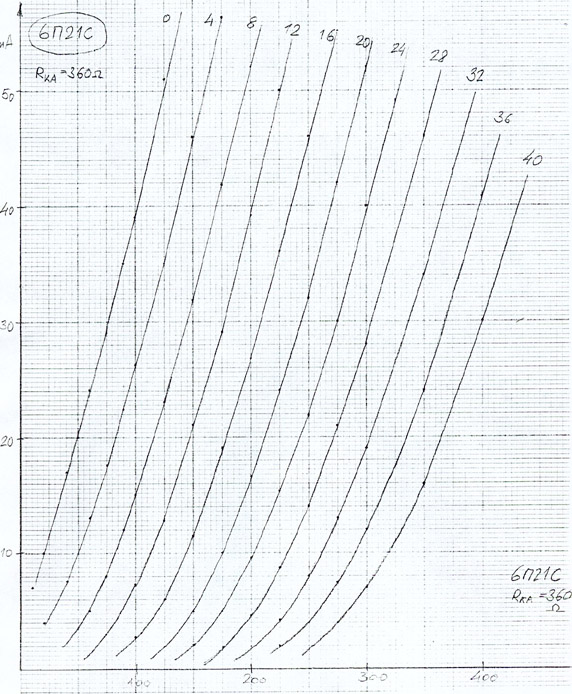

2A3 are extremely linear! I've seen such beautiful curves measured of them!
I have measured average 0.5 % THD for 100 mW output rising to 0.8% at 1W.
There is some irreducible distortion. You need tight selection to get a really good tube.
Best tubes were 6C4C's! The worst was the old 2A3 single plate!!
