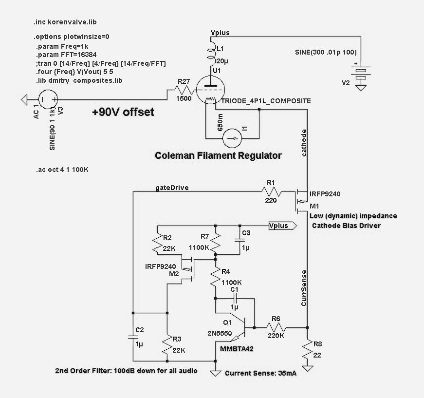

With the 3A5 we only need ~90V's on the plate. So say we DC couple to a 4P1l output. That would sit the 4P1L at 90+16=106'.
Why couldn't we filament bias the 4P1l at 106V's (that's 16V + the 3A5's 90)?
If we wired the 4p1l filaments in series that would be 110/(350ma+35ma)= 285 ohms. We would need to dissapate 42Watts if heat, could use T-220 Caddock or Vishay thick film resistors in series/parallel.
This would be one way to DC couple without resorting to an electrolytic bypass or ultrapath cap and the amp would be a true improvement in power over the schematic I posted on the first post of the thread.

3A5 with dc coupling could be quite promising.
however, even with 4P1L, filament bias will not be effective. The voltage and power handling are unmanageable, and we will need a ~180 ohm resistor - high enough to need bypassing, anyway.
No problem, though. Here is the circuit to allow dc coupling, with 90V on the output's grid. It works equally well with 2A3, and only burns 3-5W to achieve it.
The dynamic impedance, seen by the cathode, is only a few ohms - so the output DHT keeps all its gain.
Best of all, the current is established automatically - 35mA in this case.
The second order servo filter cuts all audio out of the bias circuit at 100dB+ from 20Hz.
And, unlike the usual fixed bias circuits, there are no noisy reference diodes or zeners required.

I'm sorry but it makes absolutely no sense to DC couple and filament bias via a high dissipation resistor. The whole point of filament bias is to bias the tube via a low impedance path to ground. I really see not other good way to DC couple except via a low impedance supply beneath the output tube.

dc coupling of this pair can be achieved with the auto-bias circuit I just posted.
