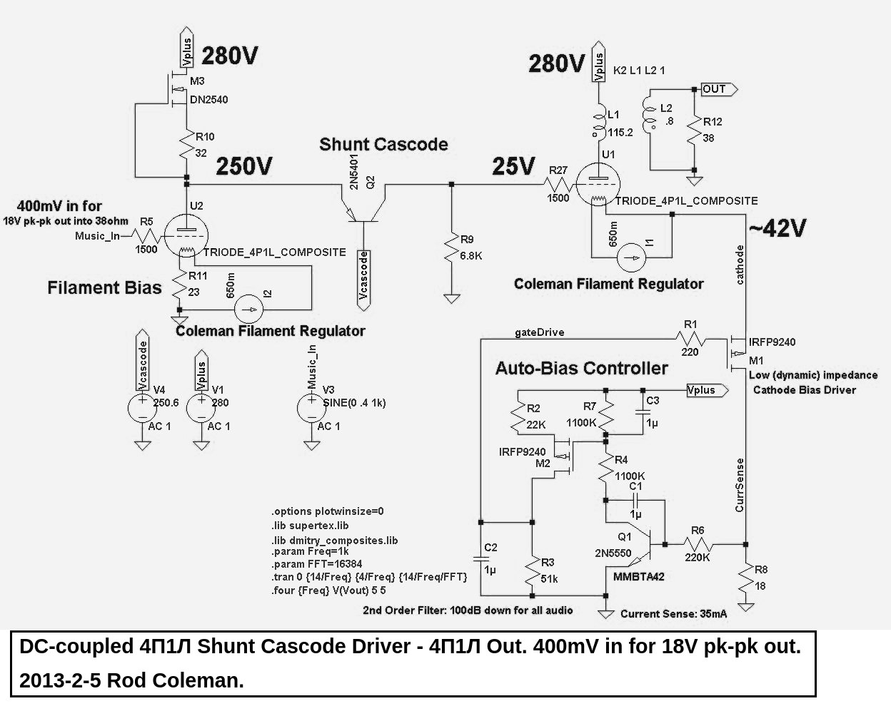

4П1Л stage can achieve much more gain with shunt cascode arrangement. This works even better if you like dc-coupling, and want to remove all the coupling capacitors.
shunt cascode removes the power supply cap from the signal path, too, since there is no signal current in the power supply with this circuit.
All that remains is to remove the input cap. That's easy - filament bias works especially well with 4П1Л.
here's an example circuit, to assemble all these features. Filament bias in the first stage, shunt cascoded to give a gain of 35. the output stage has the automatic cathode bias circuit - with dynamic impedance reduced to a few ohms, to allow full gain from the output 4П1Л.
No negative supply needed either - just a single 280V rail.
As an alternative to the cathode bias controller, we can just use filament bias for both stages, and couple using Russian teflon 100nF.
The whole circuit can give the 38 ohm headphones a pk-pk output of 18V, for 400mV pk-pk in.
