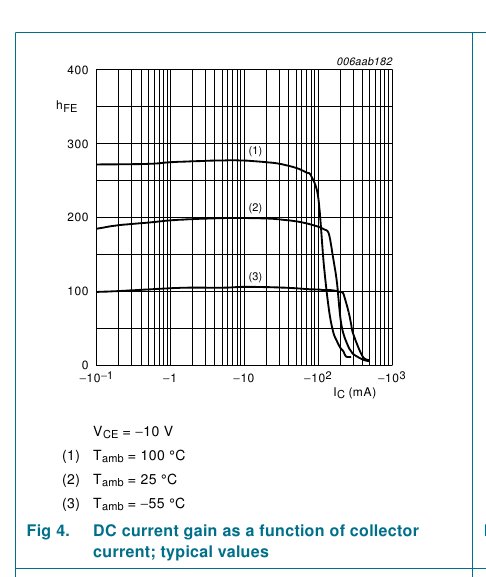

Pardon, mistyping. Of course collector current is the difference, but base current depends on collector current non-linearly. Look at curves of dependence of beta on collector current.
Rod, I would never use such "steering" without negative feedback, and I would suggest you to close servo loop through the 1'st anode current source. Such a way you will keep all together under control.
Try it in non-virtual reality and see what I mean.
Please see the Hfe characteristic of the 500V PBHV9040Z. This excellent new NXP transistor has effectively constant Hfe across the full range of current required in our driver applications.
http://www.nxp.com/documents/data_sheet/PBHV9040Z.pdf
And with darlington connexion, the base current error is almost totally removed.

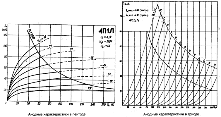

About the sound I cannot say anything. But I cannot agree that the 2N5401 in the circuit you posted is not used in amplification. From a 4P1L you can get about 20dB gain, max. The gain at the collector of the bjt is about 30dB. If the bjt doesn't amplify you have to ask yourself where the extra 10dB is coming from? The output stage can be safely left out.
4P1L in his device has current output driving emitter of the "common base" BJT stage that is loaded on resistor. Both devices amplify the signal. However, if Rod likes the sound of his setup, and is satisfied by it's stability of parameters, it is his choice. But as I said, I would stabilize DC parameters of all directly - coupled thingy together, and definitely would add negative feedback around it. Religious people then would have a chance to compare and decide, which one is better according to their religion, by sound only, without knowing what ius inside.
And here is set of 4P1L curves: compare constant current load (horizontal load line) versus load on emitter (vertical load line) and see the difference:
Seems to me it's a classic transimpedance amplifier.
I completely agree. I was just pointing out that it's not a two stage amplifier, rather it has three stages, the first two being formed by two DC coupled active devices: a tube and a bjt.
