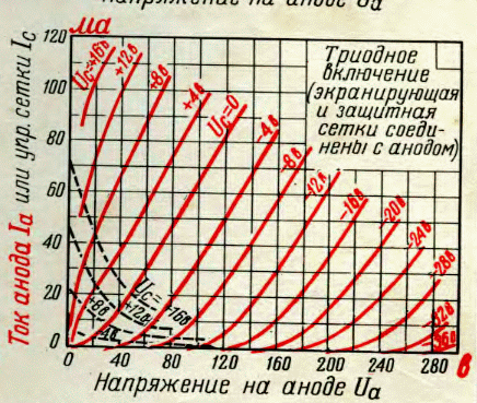

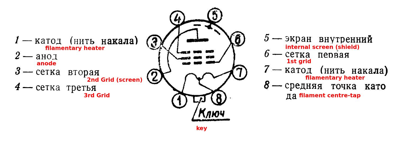

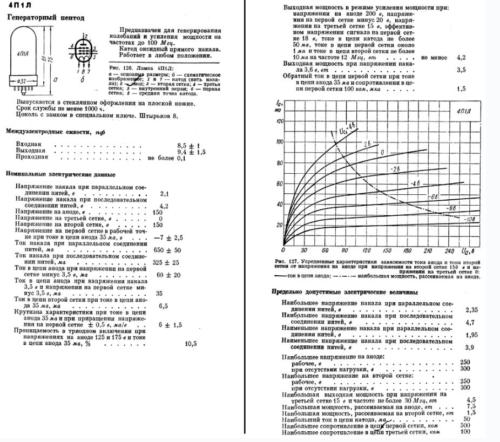

Can't open the archive, I have the attached file but can't read it is very small and is also in Russian. Sorry my ignorance still can know how to understand the curves but I need to know the pins connection.

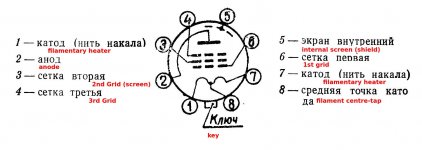

Thanks regal but still don't see the pins connections.
See attached.
