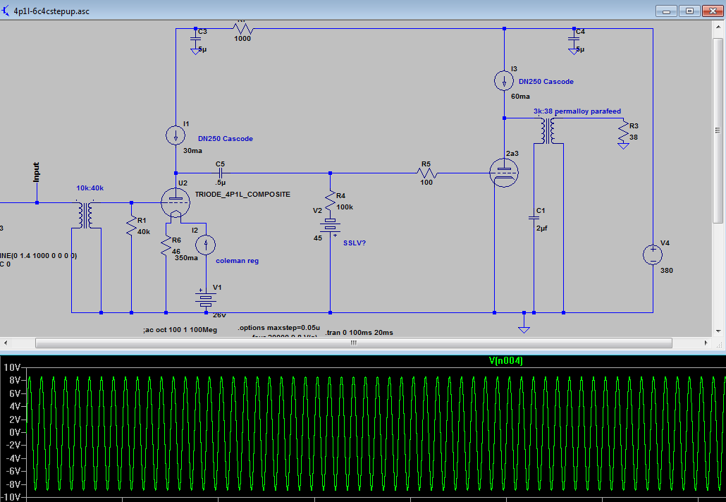

So far I've explored in simulation a simple two stage design with the following DH driver tubes: 26, 4P1L, 3A5, and 1S4, and the following output stage tubes: 300B, 307A, 2A3, 4P1L (single and paralleled), PX4 (traced the curves from the Sofia PX4). I have tried output loads of 8, 30, 50, 100, 300 ohms. My aim was to get 1-2W relatively clean output. Don't ask for exact number, because I don't really believe the number 100%. But it's a good way to roughly compare the different tubes, at least on paper. Combine that with people's experience and you get some sort of impression and possible motivation to put effort into building a real circuit with a particular set of devices. This is where I'm at as far as this project is concerned. I have my agenda, of course, but am willing to explore ideas that others put forward as well. Help others, if that is possible.
I appreciate the input greatly. I have also simulated several scenarios. I think the 5W/50 ohm HE-6 are "utopia" but the 1W/38 ohm HE-500 are a more reasonable goal.
When I do the sims what I keep coming up with is the importance of low Ra.
I compare my WE417A Singlefeed Spud. I could throw a 6c45p1 or a D3A in its place and probably get nearly the same power as a 4P1l.
So with my sims I find the 2A3 an incremental step-up in power over what I have now, due to the fact that it runs at a higher plate voltage (more linear swing) and the fact that it has a much lower Ra allowing a lower turns ratio.
Unfortunately I don't necessarilly see the two stage 4P1l as much more than a few decible "better" than a spud 6c4pi. For 1 Watt with the 5k primary we need 71Vrms across the primary. Thats 200Vp-p, my sims just show that the 2A3 does a beter job with this much and we can use a 3k primary (squared relation), is that what you are seeing ?
So far I'm seeing that the 4P1L is a very good choice for the driver. In the output stage, indeed, 2A3 is one of the best, but PX4 and 307A are better. Do you think Pete Millett chose 307A and PX4 at random? 🙂 My sims tend to agree with his choice. That is, if we're to trust simulation at all.
Iko, could you post the schematic with 4P1L as driver & 307A as output stage and post your sims.
Sure, in a minute.
But I must say, according to my sims, 4P1L->GM70 kills them all. 😀 If that would actually translates into good sound is something to debate forever.

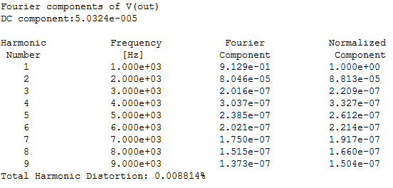

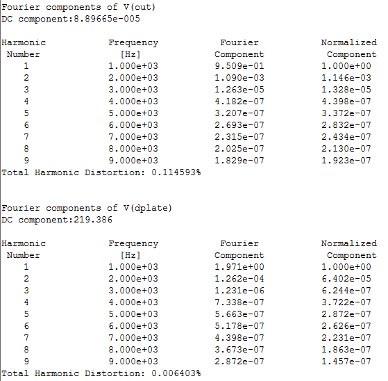

Still, some people do have some 307a, so here's the draft I have, in which the 307a is biased a bit on the hot side. The thd simulation is a case scenario that's interesting to me. A relatively realistic volume level for my headphones.
Compare that with having gm-70 in the output stage. :/
The question is, would anyone ever hear the difference?
