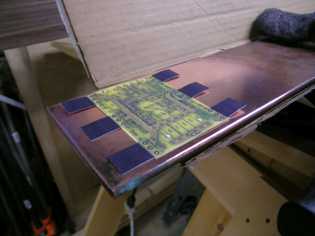

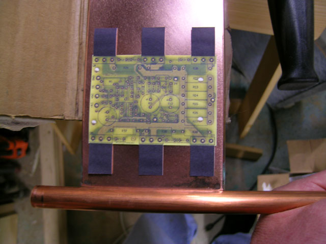

The Aleph30 PCB layout

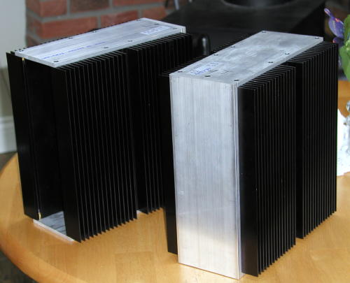

For the final version, I might use those chassis (2 amp channels in each).

hifi 2000
Hi guys.
Hope this helps, because i know the hifi 2000 stuff.
This is my impression, having used for various projects these cases, that IMHO are not wonderful because they tend to bend under heavy weights such that of big trafos needed for aleph 30 and similar.
The so called "pesante dissipante" case of the firm hifi2000 I think will fit an aleph 30 only on the 4units depth 400mm version. This is something that i tell after a rough evaluation of the thermal resistance of the dissipating fins. These are just 4 cm depth. Moreover i can remember that somebody (don't remember who actually) here in the forum has used for his aleph 60 mono such case, with acceptable results in terms of dissipation an temperature.
As a terrible drawback for such cases, I would mention that the base bottom and the covering are made of a very thin 1mm steel, very prone to ringing anytime when trafos are less than perfects in terms of vibrations.
I would rather go with custom aluminium cases.
It's much more work to do , but there is no comparison between a good custom case and the hifi2000 ones.

1. Thanks Pamaz for sharing your experience with this case, but what do you think of replacing the top and bottom parts with 5mm aluminium ?
It would be still cheaper than buying 2 heatsinks (Conrad Australia) and building a case ...

Basically, the PCB are really small, but we still need BIG heatsinks, so a big enclosure too...

cases
replacing the top and the bottom of the case is quite easy, but pls do it with aluminium at least 5mm thick.
Regarding the trafos, I've built my aleph 30 with 2 trafos 300 va each. I think that a 250va is a fair choice anyway . Regarding the voltage, of the secondary, it all depends on the filtering system that you're going to use. if it's just a simple bank of capacitors, go for 18-19V secondary, if some clc or crc arrangement is made, stay at 22-23v secondary.
My recommendation is to crank up the bias current, instead than raising the rail voltage.
Ciao
Paolo

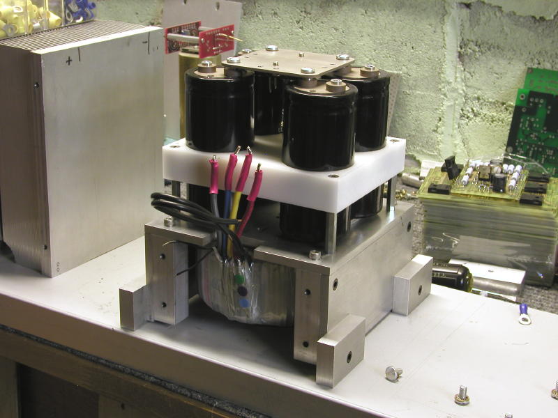

Before I start sending the boards out, I have to test them, so today I was working on a power supply. Here what it looks like: 500VA Plitron is on the bottom, in its own enclosure. The Sikorel caps above (22,000/50) have ground terminals connected by 1/8" copper plate. This PS is for two channels, each channel having a pair of caps connected directly to a bridge.
You can see heatsinks in a back.
