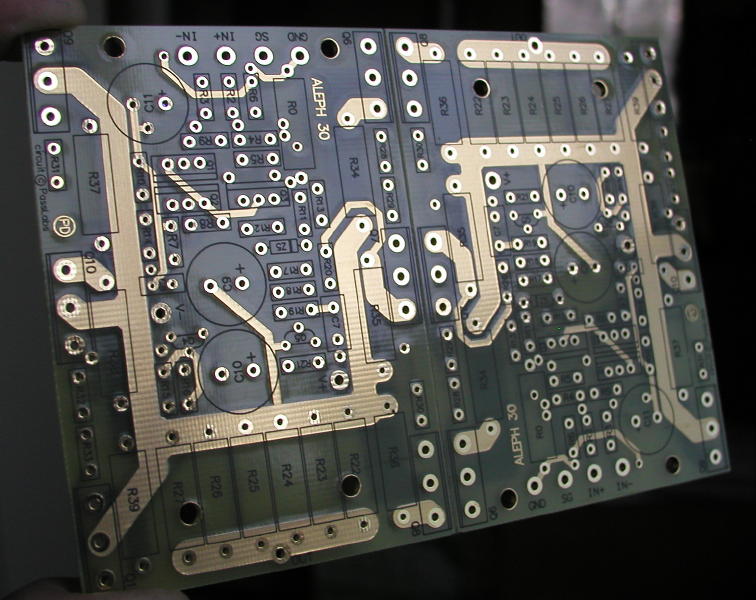

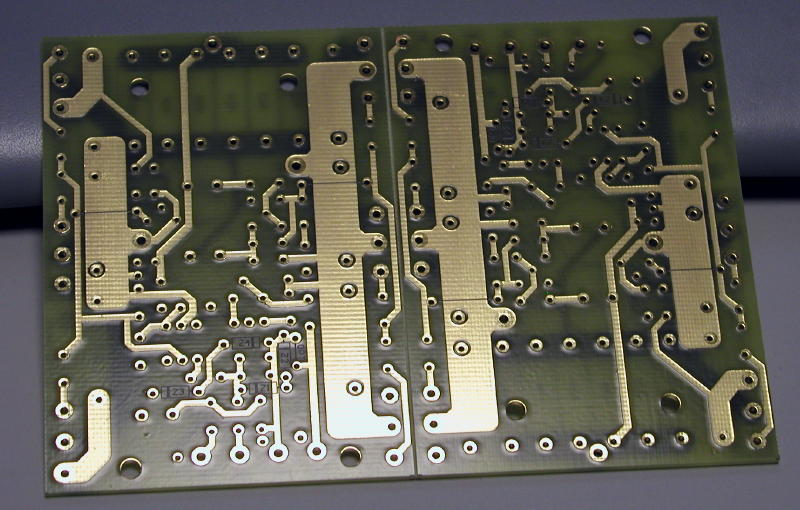

I just received the call that the boards are ready for pick up today. I don't have to tell you that I'm quite excited 😉
Peter Daniel said:So this is how it looks:
Boards look great! Can you put one next to a gainclone board, to provide an idea of the relative size? (separated would be good also)

Thanks, here how they compare, pretty close in size actually.

IMHO, this is a particularly good layout, and I have great expectations with regards to performance of this little (class A) amp. I will build the final version with Mills and Caddock resistors and Black Gates N type caps 😉

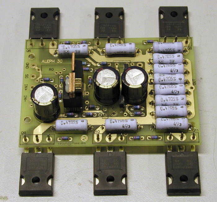

Peter Daniel said:Will try to run some test tomorrow. The spread between devices is about right, and I don't imagine the heat dissipation could be a problem (with a right heatsink).

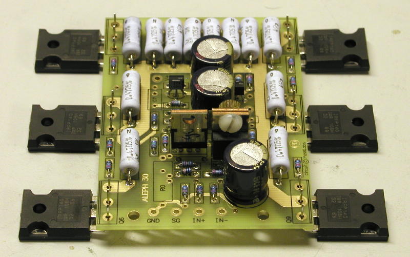

I think I did play a part in pushing you to remove those few 'compromises' as you called them a few days ago. I still have a different vision for the whole think something with really-real short signal path.
I am looking forward to your measurements and listening tests, I seem to remember Brian interesting square wave ringdown findings when comparing his smd layout with the newer version.
Hopefully, you remembered to put the fuse and the zobel in this time. 😉
The only concern I have is if input differencial can run without a heatsink. I borrowed the layout from Aleph-X here, so Paolo, what do you think?
PS: We had this discussion one day, and apparently Aleph do not need a Zobel😉
I think they can, but one can always put a long and thin strap of copper in between them
That what I was also considering, like for instance a copper foil strip from inductors. There is enough space around to implement it.

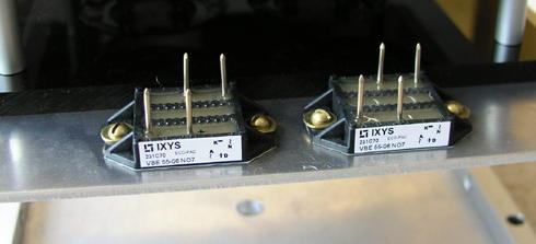

Somebody asked me if I will come up with a PS board. Well, personally, I don't see a need for such a board. Presented below (F1 amp) is a best example of an efficient implementation, so learn from the Master himself 😉
All AC wiring is done p2p, with receptacle, fuse holder and power switch mounted directly to a rear panel. The bridges, attached to the bottom, don't need any extra heatsinking, and because bridges are used, wiring is very simple as well, so no need for additional PCB traces. The capacitor's bank, consisting of 4 caps per channel, can be easily mounted on protoboard, or any board for that matter, with heavy gauge wire undeneath creating connections. 5 resistors (I'm guessing 1ohm ea.) do the filtering, and those can be wired p2p as well. Worth noticing is that the PS output is not taken after the second caps bank, but directly after the resistors. This creates shorter and more efficient path.
More info here: http://www.6moons.com/audioreviews/firstwatt/firstwatt2.html
So by doing it in this way, you save your money by not paying for PCB, extra heatsinking, and shipping. That money could be invested into better bridges, like those IXYS available from Percyaudio. 😉
