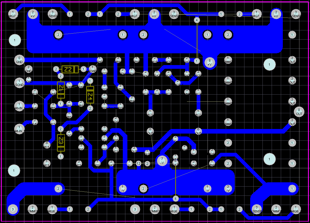

Peter Daniel said:I will make sure that there is enough boards for everybody. I did some trimmings since the last time I posted the layout and here's the final look.
The top layer with components. Main traces are 160mil and 200mil.
Short on R8 ?

Peter Daniel said:R8 is connected through bottom layer trace.
So, Jason, what happened with Canadian boards production? I called Ashok today and he was a bit disappointed 😉
He was going to charge doubble what brian got them for. And insisted that i get them checked for errors.
If you look at R8 it is a little close to the pad either it being on top or bottom.. I could be wrong but the pad might short against that track ? Just helping is all some times a second eye help's..
is it suppose to be Connected or not ? Im Confused..
J'😀
The upper pad on R8 is actually connected to red trace. I don't always run traces through the pad centers.

PS: At the last moment I did some further modifications to the input ground layout, so few different options exist: you can separate signal ground from current source reference ground and run them separately to the main star ground point, you can connect them both together on the board, or you can do exactly like Aleph 30 has, with protective diodes and 3R resistor on board. There is also onboard option to ground (with a jumper) inverting input, for single ended operation only.

Here's the final layout (how it went into production). As you see, the power traces width has been increased to almost 300mil and output traces are 160mil. There are no compromises anymore 😉
Component placement looks like that:
