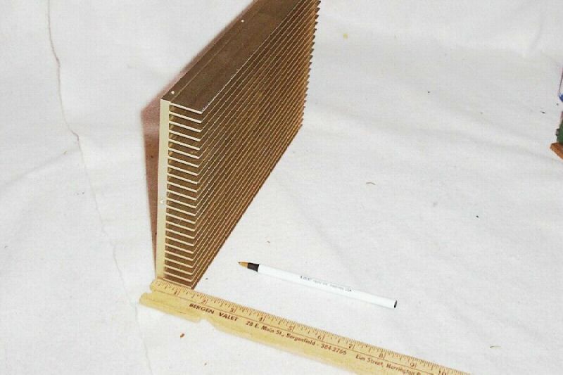

Two of those might be OK for one channel, although depending on supply voltage, it may still run pretty hot. Aim for 24V maximum (which requires 2 x 18 V trafo) 😉
Last question. How about 2 of these per channel?
5 3/8 wide x 12" (could be longer), 1 inch fins, 21 fins, 3/8 base thinkness, 4.4 pounds/ft, .75c/w per 12" or better.
So I would use two per channel (10.75x12) with a 1/4" think copper heat spreader to join them and mount the mosfets.
I could make them as long as needed actually, maybe 15"...

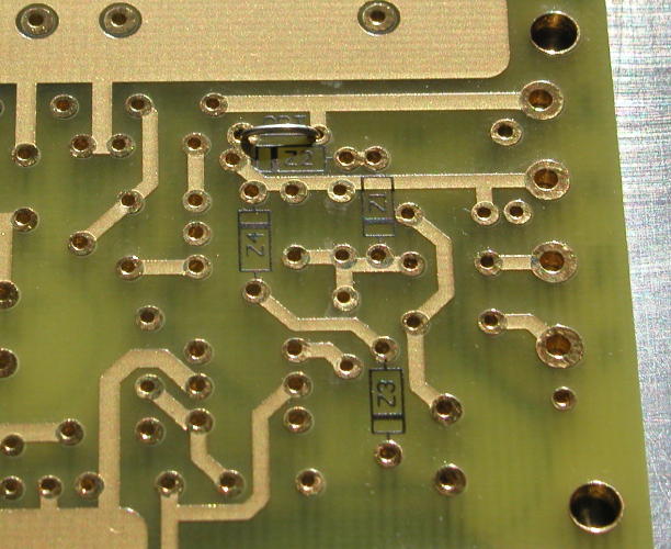

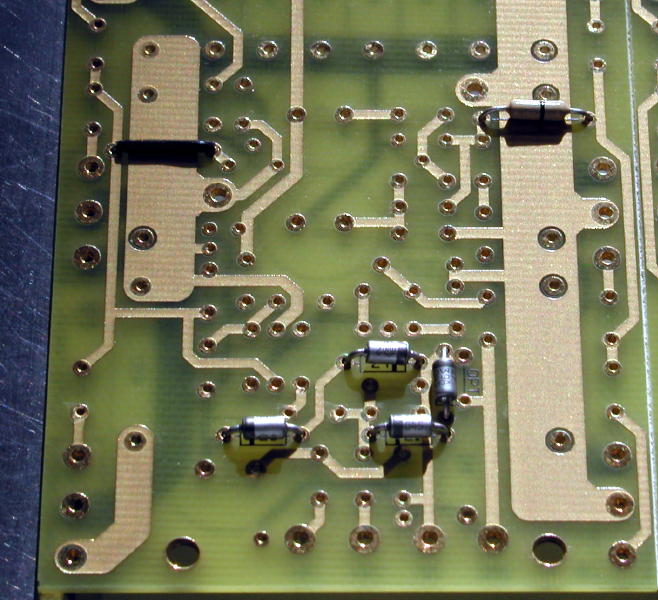

If you wish to install protection diodes, they mount underneath, and should be installed first. Also, install 2 jumpers. Use either zero ohm jumpers (available from DK) or insulated wire in order to provide some clearance from the power traces (although the mask is there, it never hurts to be cautious).

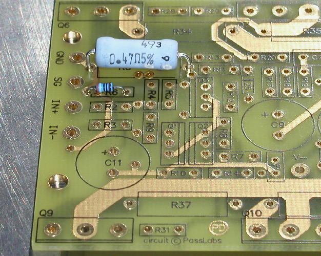

The grounds on board are separated and this allows individual connection to main power point. Some reported improvement, so I decided to make this possible. GND stands for constant current circuit ground and SG marks input ground. In case you don't want to run them separately, install jumper in place marked OPT (optional) and connect both grounds. In this case main ground connection is taken from GND point and signal ground (from from the input) connects to SG point.
I configured my test board following recommendations from 2 previous posts (OPT jumper in place) and it was working fine.
There is also an option to configure grounds exactly like in A30 schematic, and here you mount R0 resistor (3ohm) and install R6 with a wider footprint (see the pic, and additional hole for that resistor). There is only one ground connection point on the board now (GND), you don't connect anything to SG, R6 connects directly to GND, all input shunting resistors from positive input connect to GND through R0.
There are 4 mounting holes in case you want to move output devices further away from the board. Use plastic standoffs to make sure you don't short any traces.
