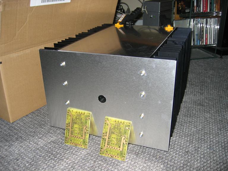

A30 boards
Got mine today here in Denmark - looks very nice indeed, but d*** they are small. I find the holes for the resistor spaced to close for normal 1/4 watt - is it the idea that they should be mounted with the legs bended inwards ??

Those boards were designed with miniature resistors in mind (like Phoenix or Panasonic line, 1/2W, from Digi Key, or Caddocks MK132 and Vishay S102). If you want to use regular resistors, they have to be mounted vertcally, which should not affect anything much, considering rather tight layout.

- The Aleph30 PCB layout
