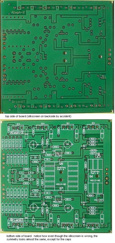

I am thinking of getting boards made by a manufacturer, and you can save a bit of cash on the boards if you skip the solder mask. I am considering keeping the soldermask, but skipping the silkscreen. The boards still will cost a bit, since they are 6" x 6".
I don't like boards without a soldermask, as it causes too many soldering problems. Also, without a soldermask, components aren't as insulated from the traces, which I would see more problems caused by this. If I am not careful on my leach amp board that I had made without a soldermask, then I can have the heatsink short my signal and ground trace.
I like the way that Joze's boards came out, and look much better then my boards (seen a few posts above). My boards are just a doubled sided milled copper pcb board dipped in tinning solution. I had a board etched without the tinning solution, but I like the ones with the tinning solution better, as long as it is fresh and it doesn't sit too long. I had to scrub the pads, then apply flux paste before soldering to the bare copper board.
Brian
Nelson Pass said:
That's a good reason!
why not 🙂
here is another picture that he sent me of the board. Notice how some of the pads were covered in silkscreen, since he got it on the wrong side of the board.. but it is interesting to see how the symmetry is pretty close, so you hardly notice that it is inverted...
Brian

kiwi_abroad said:
Brian,
Good looking board, who made it and how much did they charge? Did your friend only get one set made?
Thanks, Adrian
I don't know the details. I mailed him the files about a week ago and he mailed me pictures of his boards today. He is located in Slovenia. I think that he just got one pair made, and wanted to try out all of the Aleph-X designs posted on the forum.
I had my boards made by the school. There are two bulk pcb orders going on now on the forum for Aleph-X pcbs, so I won't organize one myself also. I also want to do another revision of my board, once I make sure that this version works good. My parts are here tommorrow from digikey, so I can start populating the board.
Brian
