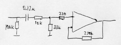

I used 220k in feedback loop and 33k input to ground resistor. Initially I had 68K, but Nelson suggested that it's too high and optimally 10k should be used. Interestingly, changing input resistor's value didn't affect much low cutoff frequency when using cap. I'm using 0.12uF for 120Hz high pass filter. When I had 2uF at the input -3dB point was at 8Hz or so. I don't think thtt anything more than 10uF is required. If I go full range with my next amp I'll be using 4uF for input caps. Even though my preamp is AC coupled, when I shorted either cap, I had DC offset at the output. I also added 100k resistors to ground before caps and there is a sonic difference. They somehow clean the sound and everything becomes more focused.

Peter,
is your input layout the same as the one published, with input-10k-68k to ground and feedback resistor connected in between? Wich resistor did you change, the 10k or the 68k one and what gain do you get (unbalanced)?
Would it be possible to put two dc blocking caps in the way they are placed in an Aleph, so (seen from the input) after the 10k (r18/28 and 68k r19/29) or is the dc connection to ground neccessary?

This is how I did it. The gain is 26dB single ended. I used 220K for feedback, because I just had Holco resistor in that value (and not 100K). The 100K resistor before cap cleans the sonics somehow and make everything more focused. The negative side is exactly the same and input is connected to ground through 60ohm resistor (which is my DACs output imp.).
With this low input caps I have a sort of very low volume resonance at turn on, which lasts about 4 sec. When I tried bigger caps (2u), I didn't experience that.😉

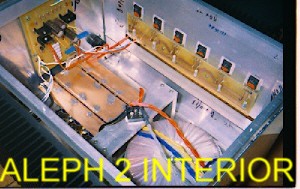

Here's a thought on the fly, could the Aleph 2 be re configured to an Aleph X in the practical sense? I realise the transformer would be different as would the central board but the power fet count would be the same wouldn't it?
macka
Yes, I would be pleased to provide feedback, of course it will need to be apples vs apples so the macka Aleph X will need to be 100/100 watts @ 8 ohms.
However, I think my initial buy in on this project will be somewhat more modest so I can understand and tame the creature before I go down the road of the Forbidden Planet.
That is of course unless Peter Daniel and the others can persuade me otherwise.
macka
I converted my A75 into Aleph X, yet, it wasn't practical. Converting Aleph 2 would be easier. You just have to replace front board (which gonna cost you $5 BTW😉 ) and separate output fets bank in two halves. You have to change transformer and double capacitance (at least).
Output devices count is the same for both amps.
