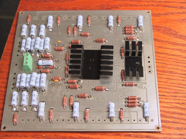

I got my parts today for my boards. I ordered the wrong caps... surface mount caps for the electrolytics... don't know how I managed that.
Here is a pic of the board. The components look pretty good on the board so far. I should finish it early next week after I get back from thanksgiving.
I have a real hard time getting good pictures of these boards, since they are so reflective. I can't use the flash, or put bright lights near it, so I have to hold the camera still for 1/4 of a second, which makes the pictures blurry... It does have image stabilization which helps a bit. (canon pro90is digital camera) Anyone have any tips for decent indoor pictures with a digital camera? I am used to outdoor photography.
Note on layout, I am currently using the 10pF caps from digikey that are used in the zen v4 article. I have more, and will series them to get 5pF later and try both on a scope once it is done. For the resistors, I meant to have 6 for each bank, but I ordered the wrong values (calculated the .22 ohm bank for 3 resistors, so I ordered .68 ohm resistors...).
As far as my next revision goes, I am going to make the device mount correctly on both sides (lose the symmetry, but not too bad), and make an allowance for Fred's CCS (allow both). I am still trying to decide if I want to make room on the boards for input caps. I will see about this later, once I find the caps that I want to use for sure. For now, I am going to use a pcb that mounts to the xlr jacks.
If you run this amplifier with a single rca connection, what do you do with the other unused input? ground it?

Re: Long Exposure
What a great nickname... I hope that you stand up to the task for the ladies.
I will see if I can borrow a tripod for next time. The board looks soo much better in person.
The thick traces are soldering quite well also.
Brian

Some questions from a newbie to 2sided PCB's. I see you solder the components at the toplayer, are there also solderjoints at the bottomlayer?
