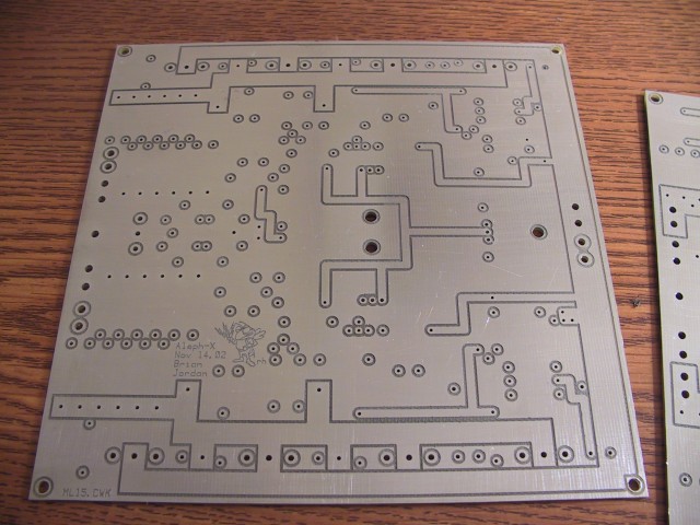

I got my boards yesterday, and will start populating them next week when I get my digikey order of parts. The guy made a small mistake milling them, but it can easily be fixed with a exacto knife.
(boards are 6"x6" square. the fisheye effect is from the close positioning of my camera)
Brian
Brian

"I got my boards yesterday, and will start populating them next week"
Brian, your boards look good, but your gunna need a big soldering iron to solder some of those pads properly.
In my experience of long term reliability, do not be fooled by solder taking instantly to the pre-tinned surface - it takes an appreciable time for the solder to alloy into the surface of the copper tracks properly, and soldering and then desoldering and then resoldering helps to ensure a long term reliable and sonically good joint, and preheating (cooking) with a hair dryer helps a lot, especially for heat sucking fibreglass boards.
Also vias are not to be trusted long term on hot running pcb's - good to fill them with solder or a short wire stub in my experience (unreliable hot running high power pro-amps with double sided boards).
Solder masking would be a great asset on your boards, as it limits the the area of each solder joint, and this greatly assists solderabilty and helps greatly to eliminate solder bridges.
Good luck with your new baby,
Eric.
(I'm In for a low power, lower cost version using a PC SMPS.)
Hint - if you ask your pcb maker he might give you some solder resist laquer that you can apply around pads with a small art brush and then bake the board in a bench top toaster-oven.

Re: Some Advice From An Old Hand....

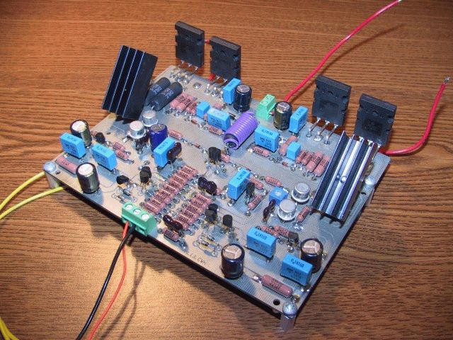

Thanks, my last boards that I got made didn't seem to have any problems soldering (picture attached).
I am using a weller wpcpt soldering station, that seems to keep the tip at a constant 700 degrees (i have an 800 degree tip also). It should work alright, but if I have problems, I have a friend with one of those high voltage solder gun looking things that I can borrow.
As for the board treatment, he had no suggestions. He just changed the tinning solution, so it should solder well. I will keep extra flux on hand for this also.
As for the boards, I might get a couple of pairs made. I think that I can get a pair made for $50 if I get a few friends in on it (heavty copper, soldermask, silkscreen). I am going to finish these prototype boards first and see what kind of revisions that I want to make. I think that Peter was right about the orientation of the output devices, while near perfect symmetry is good, mounting won't be as easy as hoped.
Brian

Doing It Right.....
Use of plenty of good solder and a varitemp iron are mandatory IME.
Also clean (polish) the solder wire, component leads and the pcb to remove oxides with tissue and solvent (isopropyl) before you start.
Do this properly and it will never let you down.
Eric.
