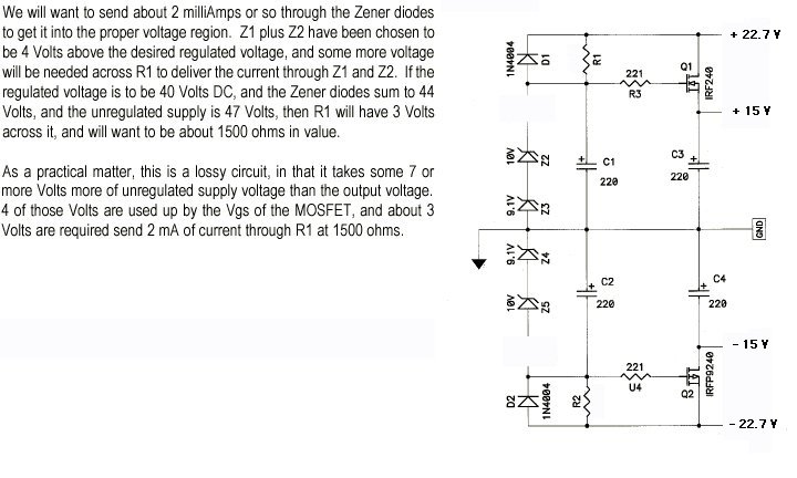

22 VAC with a full-wave bridge, lightly loaded, will give about 22*1.4 = 30.8 VDC. Accounting for the load you should still get (maybe) 26VDC; with the LC and 4 volts for the FET you'd still be up around 20VDC. You can regulate it down to 15V but you're just throwing away power; better to start with a lower voltage transformer.carpenter said:Working with one side of a dual in/out transformer, I took 22 volts x 0.9 (LC power drop) = 19.8 volts - 4 volts (FET drop) = 15.8. I missed the first calc by 0.2 (called the final voltage 15.6), my mistake was caused by quoting the figure from memory.

Carpenter has it correct. Because the inductor is the 1st element after the bridge, the resultant multiplier is 0.9 not 1.4 assuming that the inductance is equal to or greater than the critical inductance for the given circuit.

R1 question on Z4 p.s. (still trying for that 15 volts)
It seems to me (correct me if I'm wrong) that Nelson knows that there's a need for 3 additional volts to drive voltage through R1. Now, in my case, I have 22.7 volts after LC filtering. I adjust my zener layout to sum up to 19 volts (15 +4) and then subtract it from 22.7 to get 3.7 volts. This 3.7 volts is divided by 0.002 (as in milliamps) to arrive at 1850. Now, is this the size resistor that I'd use in R1?

That's right John, basically you want to give the zener slightly above it's voltage rating and let it do some work, the zener will sink some current to bring the voltage down to 19V. Too much over voltage will kill the zener because it won't be able to handle all the current in needs to shunt. If you go below 19V the zener becomes useless. How much current it can sink depends on the zener power rating.

Oh right, the LC doesn't give you 1.4x. AudioFreak says 0.9x, okay (I would use the PS simulator to do this; I've never used an LC).
7 volts drop at 4.5A is over 30 watts. John, you might also consider a bipolar transistor-based capacitance multiplier. It has far less voltage drop (and therefore power wasted) than a FET regulator.

The point is ripple reduction; I think actual regulation of voltage is only a secondary concern with a Class A amp.

After finally figuring that 3,000 ms means 3 sec and not 3.0 msec, I had quite a bit of fun with the power supply simulator. I think it's a essential too in understanding things like ripple current, where one's biggest cap should be for maximum noise reduction etc. In essence, I think I narrowed it down to 13-14Vac transformer, and a pi filter made up by 2 100mF and 0.3-0.5 ohms (thermistor or whatever). It will end up burining 10-25W channel to get a clean DC with 5-10mV ripple, there is nothing for nothing.
I think L is way too big and expensive for what you get in return.
I think CRC is better than RC or LC, the ripple current is a little bit better distributed.
