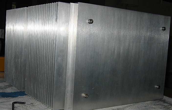

Under this 'Pax Pass-iana' I feel bold enough to show the future home of my alephX. Will be painted black, front panel screws will be changed to socket flat head. All screws are 321 SS (non magnetic) naturally.

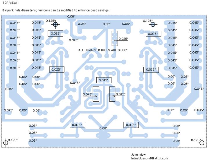

Hi everyone,
I've sent off my artwork and hope to hear from them next week. I haven't the ability to create gerber files, but they do. I've asked them to give me a price quote as well. I'll pass along any info as it arrives. Here's a pic of the drill sizing. All positive suggestions welcome. Any Trolls out there, please, go play with the fairies.

Looking at your artwork, Q5 and Q7 make differencial pair. They both should be thermally coupled. What kind of heatsink do you have in mind? Also, to make the traces simpler would it be better if Q11 gate connected with Q7 drain and Q2 gate with drain of Q5. You would have to run 2 traces under R22 but it's possible and the artwork would be less complicated. Just my first impression.
If it works, leave it alone
Hi Peter,
Wessol's board works. Therefore, I'm not planning to modify a pcb that's been fabricated and tested.
The differential pair has been layed out in such a fashion that the transistors can be coupled back to back. To fill the span between the two transistors, I plan on using a small piece of aluminum, or copper, with a heatsink mounted on top.
I can see where your idea for the redesign originates and it is clever, assuming the traces were renamed. I also can see where confusion would creep in with the hard wiring and someone gets Q2 and Q11 mixed up. We'd lose the X configuration.
