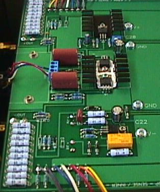

There is a relay on the original XA board. I was wondering what it's used for? Is it for remote on/off switch?😉
Could be for a soft-start, no? In my a-x power supply I run the secondaries into resistors until the capacitor bank voltage comes up to 12V, triggering a normally-open relay to short out the resistors. The one on the Pass Labs PCB doesn't look much like a power relay though.
Could be for ext. switching the amp.
Didn´t Nelson wrote that they switch off only
the amp and not transformer incl. powersupplycaps.
So they want to eliminate formatting current in the cap.(This cause the bad sound when "heating" up the amp). Or so??
😉 Andreas
Hmmmm. It seems to be connected the the current source for the front end diff pair.:idea: I suppose it could be related to the power sequencing for🤐...............🤐* with respect to the output stage current sources. Don't worry about it as you know how Nelson sticks all kinds of extra parts in his designs. :Pinoc: Besides I knew nobody would be irresponsible enough to go offer PCBs to less knowlegable people than themselves without fully understanding the circuit in term of power up and power down transients, short circuit protection, and protection from short circuits from one of the outputs to ground. :crackup: I'm sure they tested it during power up and fault conditions also.:smash: I wouldn't worry about it for one minute.:worried: It probably is not important.:no:
