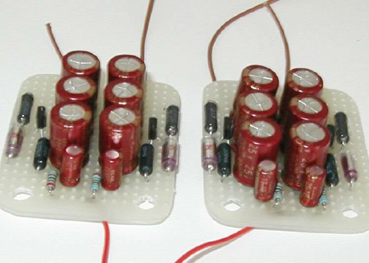

View of Zetex ZTX 450 boards for active current sources. Elna Cerafine elkos, Seimens polystyrenes, and Resista and Corning RN60D resistors.
