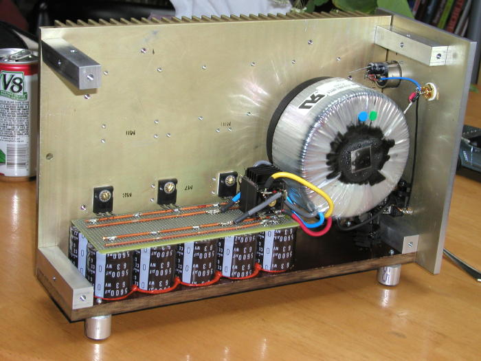

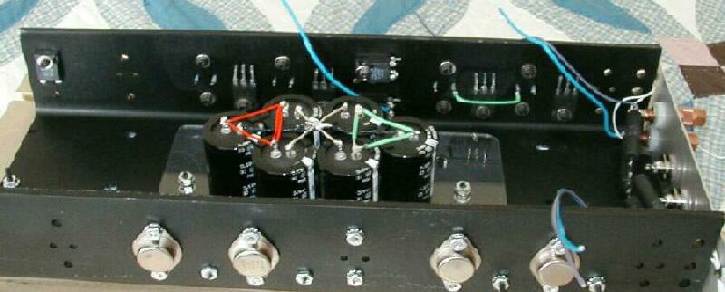

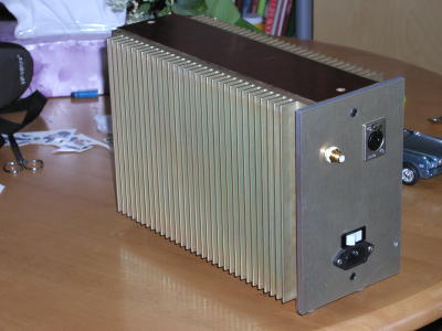

Tex-X status
Tex-X amp progress report. Picture shows surplus U channel from 350 watt mono block amp for mounting transistors to surplus heat sink. IT was already drilled for T03s and I drilled a few more holes. Caps for +/- 15 volt supply mounted on piece of plexiglass to insulate from heatsink temperature and allow easy removal. Vishay 0.25 source resistors in TO3 cans are mounted on outside of the U channel. The IRFP 150s and Caddock 0.05 ohm resistors are mounted on inside of U channel. I wiill build front end, front end current sources, and Ouput current source ZTX bipolar circuits on small vector boards that can be removed for test, mods, and parts update. This also makes things a little more rugged mechanically. I hope this gives some ideas for point to point wiring and layout for short signal path while still allowing easy access for soldering and testing. Will update as I make more progress. Planning the layout carfully will save alot of labor and headaches later.
Here's what I'm thinking about for my X...
Use the Volksamp 30 output stage and basic front end (with Greys modifications of course). From what I can tell, this should be good for about 150 Watts into 4 ohms, or 120 into 8 ohms (I take it that the Volksamps aren't biased for full current 4 ohm operation at the same voltage level).
Any suggestions or warnings? This really makes for a comparatively cheap amp when you consider the 25V rails allow cheaper filter caps, it only has 12 output Mosfets per channel, etc. I am speaking in comparison to the A75. I will try to come up with a schematic soon for everyone to pick at, if they are willing.
Steve

All my heatsinks, except the ones I used for flagship A75, come from surplus. Those for instance I bought 5 years ago and had the chance to use them just now. I didn't know I will have much use out of them but due to clever idea it looks like it's going to be the cutest amp I ever built that's why I give it a priority over GAX. How do you mount your caps to plexiglass: with silicon? As you see on my previous picture I used red RTV used on aircraft engines.
- The Aleph-X
