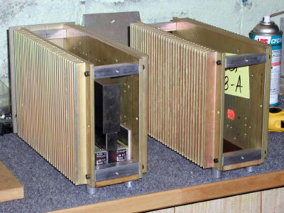

I would go with a transformer of 500VA or more. The more, the better.
http://www.victoriamagnetics.com
makes custom transformers for a reasonable price. You can get transformers anywhere between 50VA up to 2kVA, for the voltage that you need.
I have ordered several transformers from them:
pic of transformers from them for my aleph2s and bosoz
Good luck with your project.
