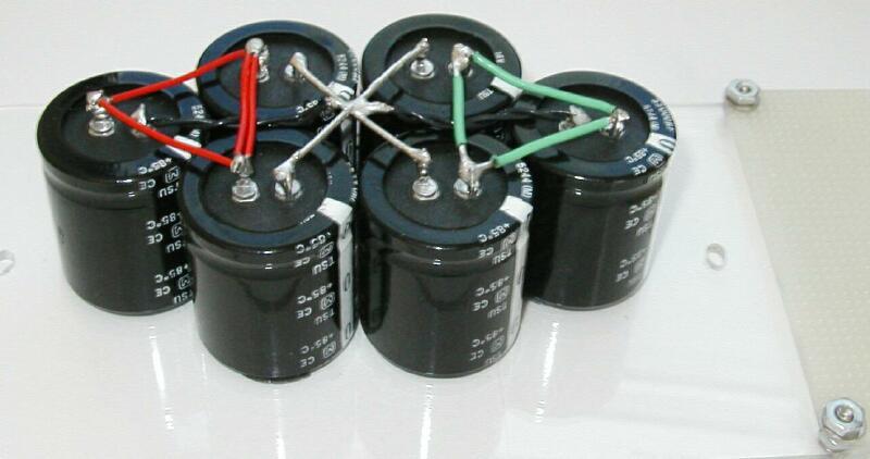

Glueing caps
I used Black RTV and drilled a few holes for the excess RTV to escape and aid the adhesion to the plexiglass. I would have mounted the caps inverted but I might add more caps and it would be a hassle to pull the board later for that. I also wanted easy access to the terminals to ease wiring and bypass changes I am trying real hard to make sure I can get at everything easily for later mods and parts changes. My stuff seems to evolve later and I hate taking everything apart to change two capacitors. The Passlabs Aleph 3 is great since you can pull a heatsink with three screws to get at the PCB. One of the easiest amps to mod Ihave ever owned... Thanks Nelson.
H.H.
H.H.

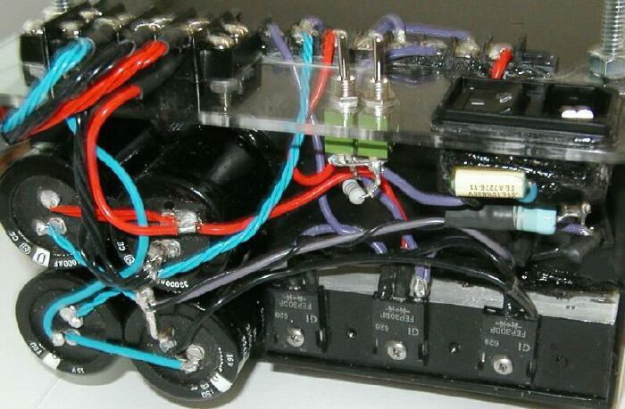

Tex-X outboard supply
I have about finished the outboard supply for the Tex-X balanced Aleph type amp. I used a potted Bicron 1000 VA Torrid transformer that was a cosmetic reject for an famous audio designer friend. The primary has four winding that can be configured for 220, 115, or 100 volts AC. I put the 100 V windings in series and used the low voltage primary windings as secondaries for about +/- 15V DC. The Brige is made from 3 Dual high speed soft recovery diodes mounted on a heat sink. Caps are 4 X 33,000uF. Toggle switchs are for soft start. Earth ground is connented to signal ground by 50 amp bridge with jumper so that two diodes drops in series appear between ground for either polarity fault condition. Thsi is paralelled with a 150 ohm resistor. Wiring is silver plated OFC with teflon insulation. Solder is 4% silver reflowed with 36/64 Alpha since the transformer wiring is hard to heat for lead free solders. Another plexiglass strip will go over AC terminals. About a full days work.....
Why using 3 double diodes and not 2? (looks like two of them you are used as singles). I didn't thought about ti,but to get lower voltage from a transformer you can actually connect primaries in series (as for 220V) and get lower secondaries. Any drawbacks to that (same power?). It may just save me $200.
The Bridges of Haller County
The fullwave bridges could be done with a common anode and a common cathode dual but I was not that lucky. You could use four and parallel the diodes in each for more current capacity. Series connection has more winding resistance but is not a big deal for a transformer this big. Lower flux densisty too for series connection which can be an advantage for a torroid. Bypass caps will be next to output transistors with a 100,000uF per rail. 0.05ohm resistors between outboard supply and local caps will filter higher frequency components of ripple voltage.
H.H.
H.H.
