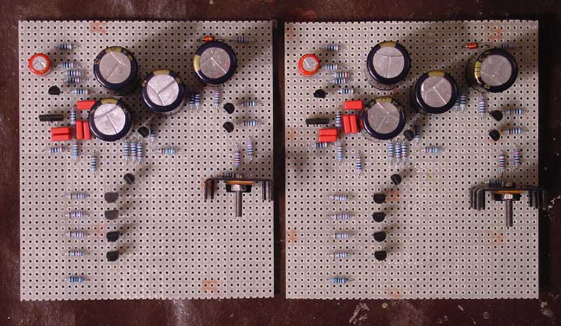

I believe I will go ahead without the cap, but will try to make room for it on the PCB. Once all this is on a board, the environment will change and it may break into oscillation once deprived of whatever stray capacitance I've got on these push boards. If I can get by without it, I probably will, but others may need to be aware of it. In my case the load is purely resistive, albeit low (about 2.5 ohms), so I don't anticipate any difficulties in operation.
Grey

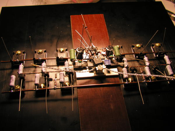

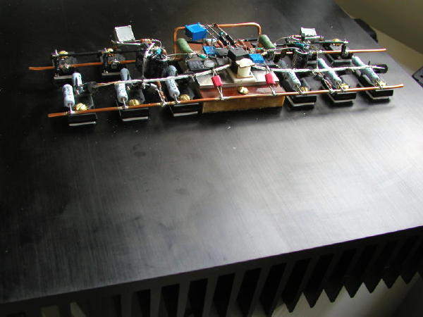

I have just finished prototyping Grey's Aleph X. I would like to thank Grey for sharing his work here and make this project available. Actually I had a good excuse to bult that amp: I wanted to prove to everybody that it's going to work in real life.😉
I might as well say I did it for you, Grey.
It's just one channel but second one will be coming soon. For more detailed pictures see: http://www.diyaudio.com/forums/showthread.php?s=&threadid=3840
If that amp is really close to the production unit, which is the the best from Pass so far, and my circuit is done p2p, using exotic components and silver wiring, correct me if I'm wrong but there is a good chance I soon might be the owner of the best SS amp out there.😉

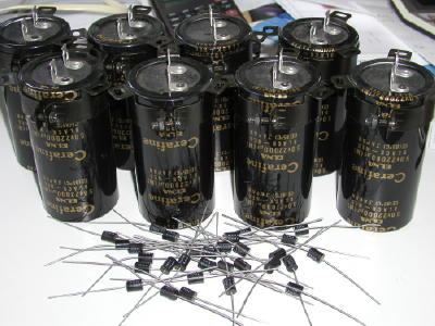

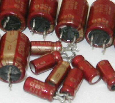

except for the caps
There was not room for my 10,000 uF 100V RIFAs. The Panasonic TSUs actually sound good in my Aleph 3 with Cerafine bypasses as I plan to do. I see you are using Panasonic (HFQs?) for the smaller value caps were I will use the Cerafines. I guess we will call it a capacitor stalemate. The Mills wirewounds are great for source resistors and that is what i would buy new. The Vishays I am going to use are over $40 a peice new and probably custom order at that. I have done some REALLY LUCKY surplus shopping as of late. If I told what I paid for the Vishays we would have a riot on our hands. I sent some to a friend and he thinks they are drop dead good sounding also. A case of when good things happen to bad people I guess. So I guess this means you are not done yet.........

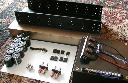

Please can we have some more photographs of piles of components and capacitors etc. since we don't know what they look like.
- The Aleph-X
