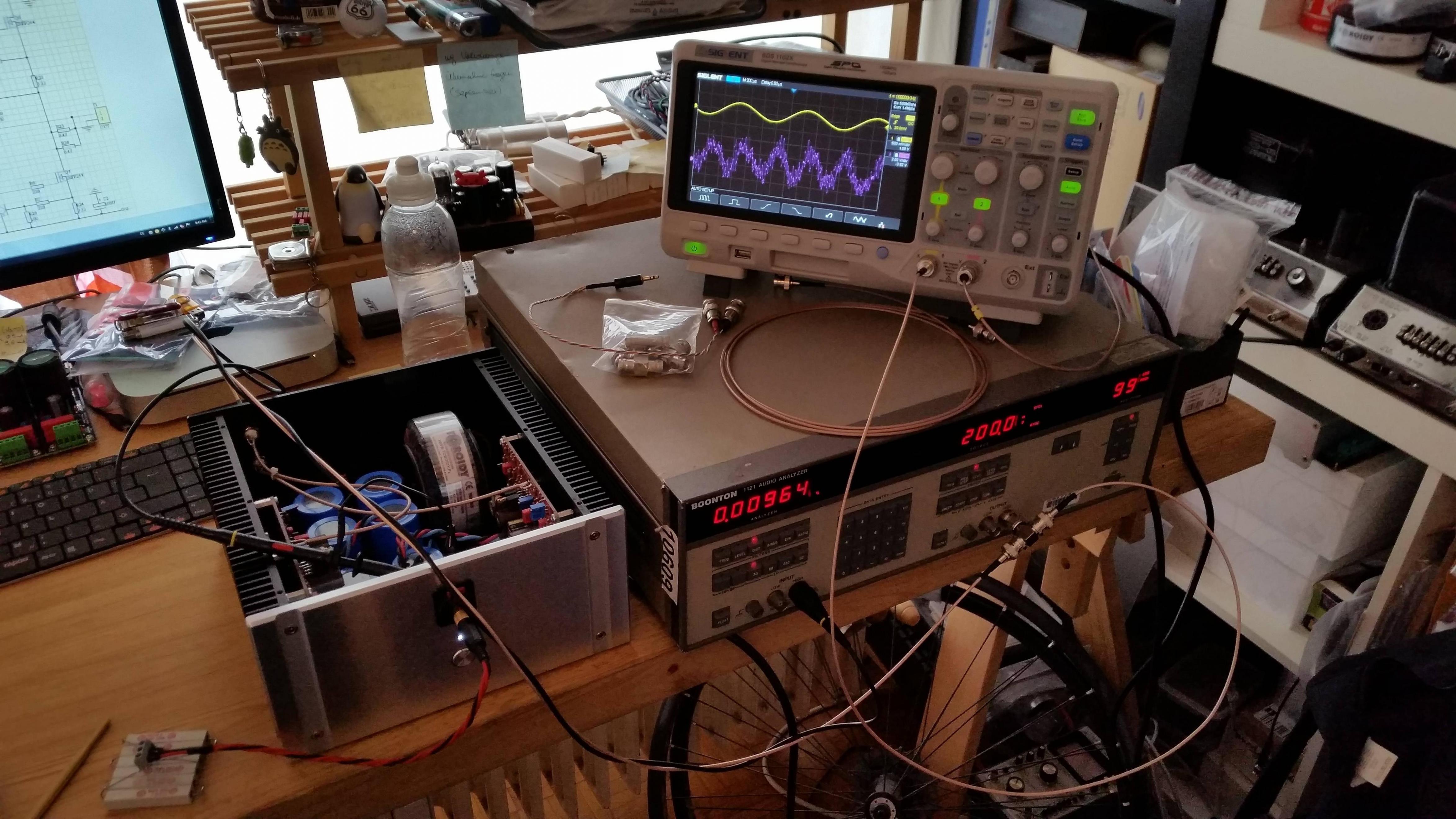

I recently got myself a Siglent SDS1102x, 8 inch color screen, 100MHz, 14Mpts memory, down to 500uV/div sensitivity and a small footprint. There are a few Chinese scopes on the market that are quite interesting, namely by Owon, Rigol or Siglent. Check YouTube for numerous reviews. I'm really happy with mine.
Attached you'll find a pic of the scope showing the input signal to my Aleph headphone amp in yellow and the residual distortion signal (2nd harmonic in character) in violet, taken from a test load at the amp's output. The residual distortion signal was generated by the bulky Boonton underneath the scope.

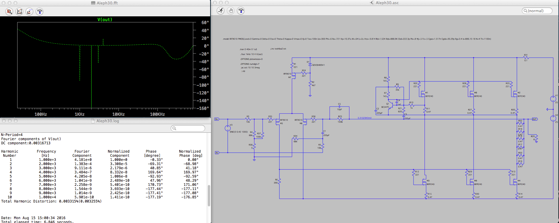

I occupied more with Aleph 30 and Aleph 3…...🙂
Aleph 30 is running and sounds fine as you know.

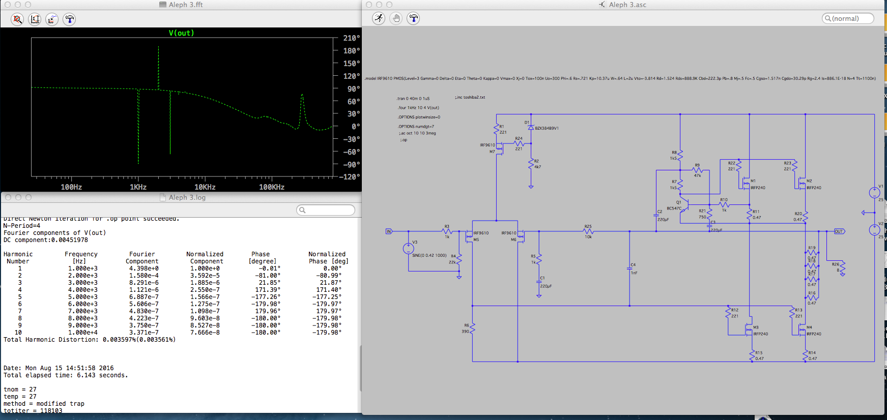

Of course I wanted to build now not only the small case Aleph 30 with 40W at 4 Ohm but also the "real" thing, the Aleph 3 with 60W at 4 Ohm and the bigger PSU.
Parts are ordered…. meanwhile I spiced a bit….. 🙂
The first pictures shows the Aleph 3 data, the phase diagram from the THD and the Spice error log showing the distortion and the phase degrees.
The phase diagram shows what I thought would be negative k2 phase because the peaks goes in the inverse direction of the 1kHz peak.
But I also learned that the numbers shown in the Spice error log correlate with the picture in a way I seem not to understand fully.
The degree value shown in the picture where the 1kHz peak ends, seems to be the "zero" point for the degree numbers of the higher distortion peaks k2 and k3 in the column presentation.
So the column seems to say that the k3 peak ends in a value 21° more positive than the k1 value.
But the k2 peaks goes to nearly +180° and the difference to the k1 peak is more than the -81° mentioned in the column. Neither value nor numbers seem to fit
May be someone can help me or is the culprit Spice?
Let us go to the Aleph 30 picture and data.
Here things between column and picture are more consistent.
K2 and k3 points at the end of the peaks correlate with their values well with the k1 zero point.
But here the k2 peak is only more negative than the k1 peak or longer downwards.
Now the final question…. 🙂)
Is this behavior of the Aleph 30 showing "negative phase" in the sense Nelson was using when he explained the F6 distortion tango? Because the k2 peak value is more negative than the k1 value?
Or it is a must that the peak of k1 and k2 must be going in inverse direction to have "negative phase".
Any comments welcome!

... Is this behavior of the Aleph 30 showing "negative phase" in the sense Nelson was using when he explained the F6 distortion tango? Because the k2 peak value is more negative than the k1 value?
My understanding is the later: when the fundamental has a positive peak, H2 should be near a negative peak. It you examine the residual waveform V(out)-K*V(In) (unfortunately not corrected for the minor phase shift of the output), you will see negative H2 phase when the LTSpice log file shows H2 Fourier normalized phase or near -90 degrees. The value of K is very near CLG, but must be carefully tweaked to about 5 or 6 decimal places to properly null the fundamental. Try it.
