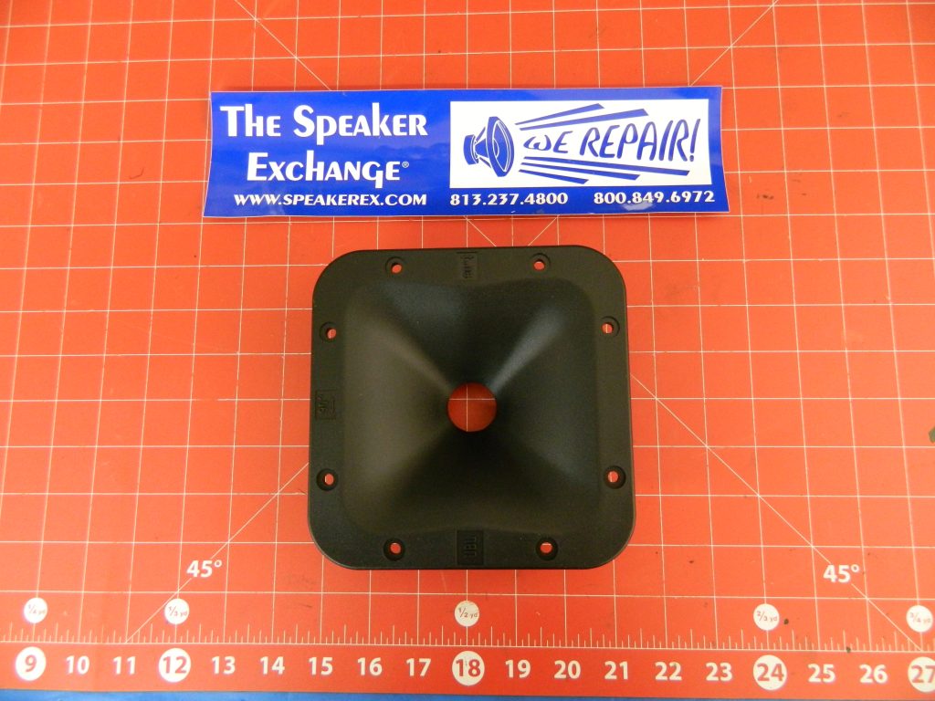

I have a pair of JBL 6x6 horns and a pair of Dayton Audio DT250P-8 Compression Driver.

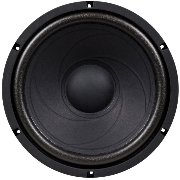

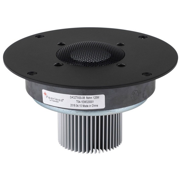

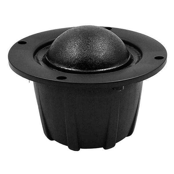

Best Three-way? Fifteen inch RS Mach-One replica, in a 1010 liter bass reflex enclosure, Three-inch Tangband softdome midrange, Peerless 1.25 inch Corundum tweeter.
An 800 hertz & 4500 hertz crossover....all three drivers perfectly matching at 90 Db sensitivity...the giant enclosure getting to an F3 at about sixteen hertz...all the "tricks of the trade, driver spacing, absorbent materials, radiused baffle edges, etc.
Not for "party" volume levels, but more for precision.

I like where your head is at…..but that’s quite a distance from the mid dome to tweeter center for 4khz, no?…..you picked a monster flange tweeter! Lol
Yeah, I noticed that one too....with those drivers in hand, I'm sure one could shave down those flanges to approach that cross-over frequency.
------------------------------------------------------------------------------------------------------------------------------------------------------------------------------------Rick...

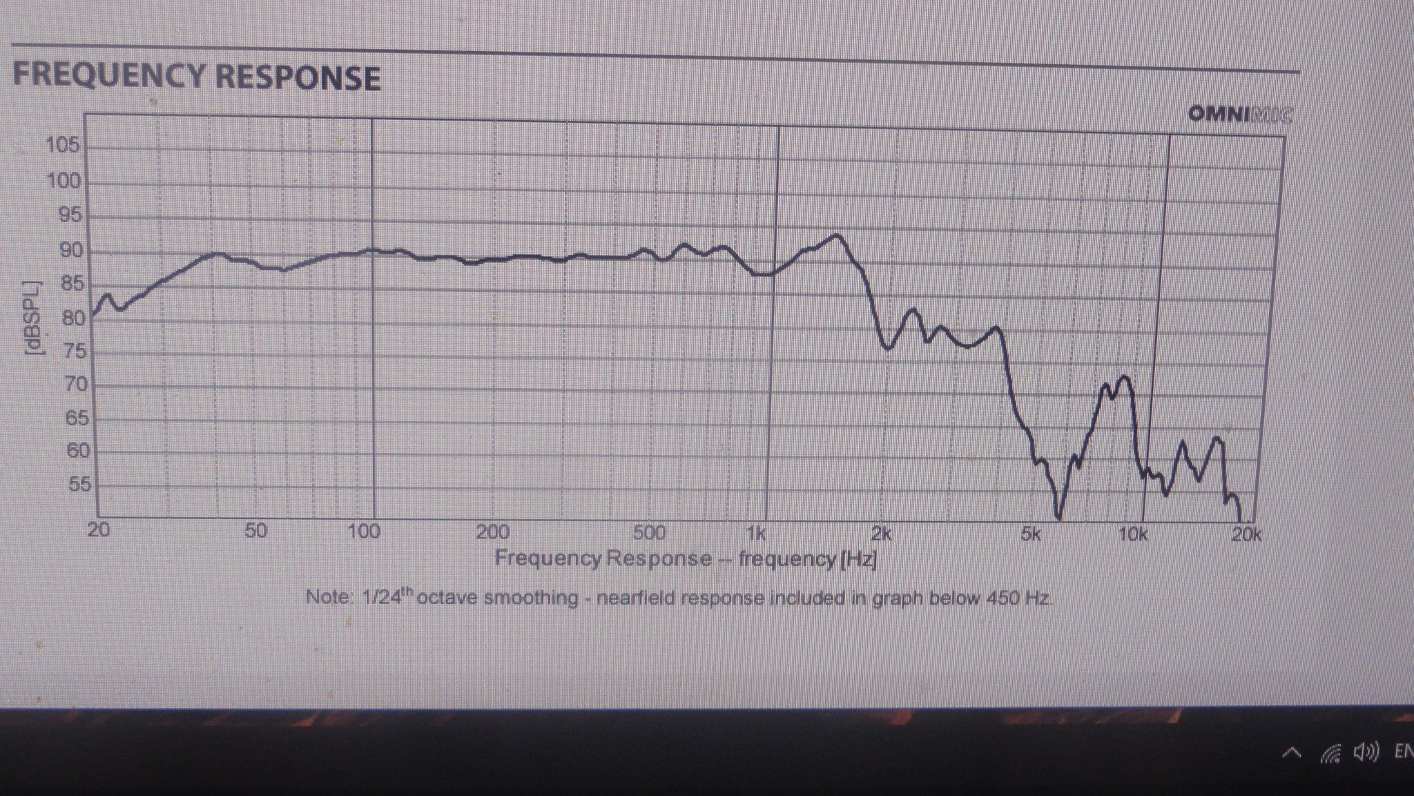

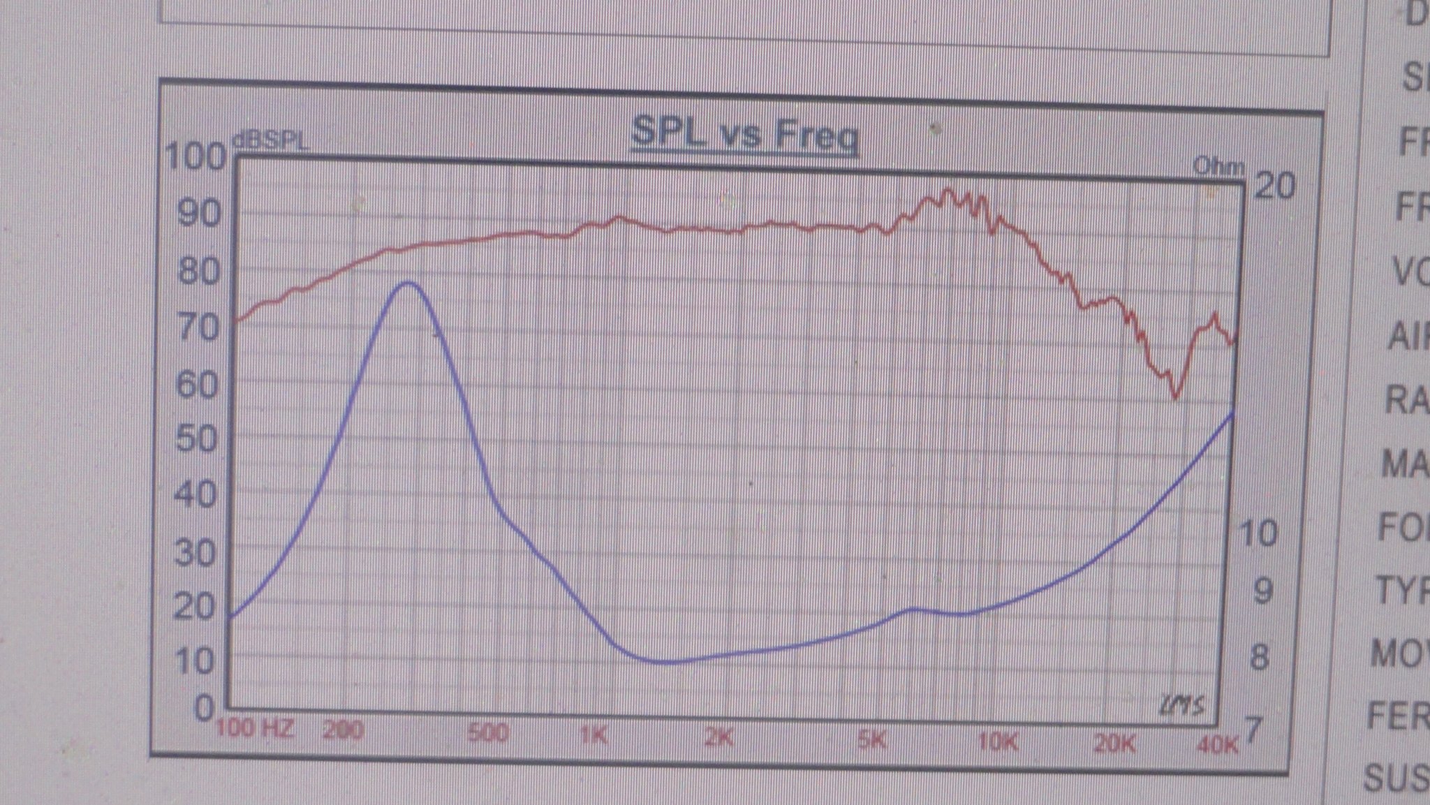

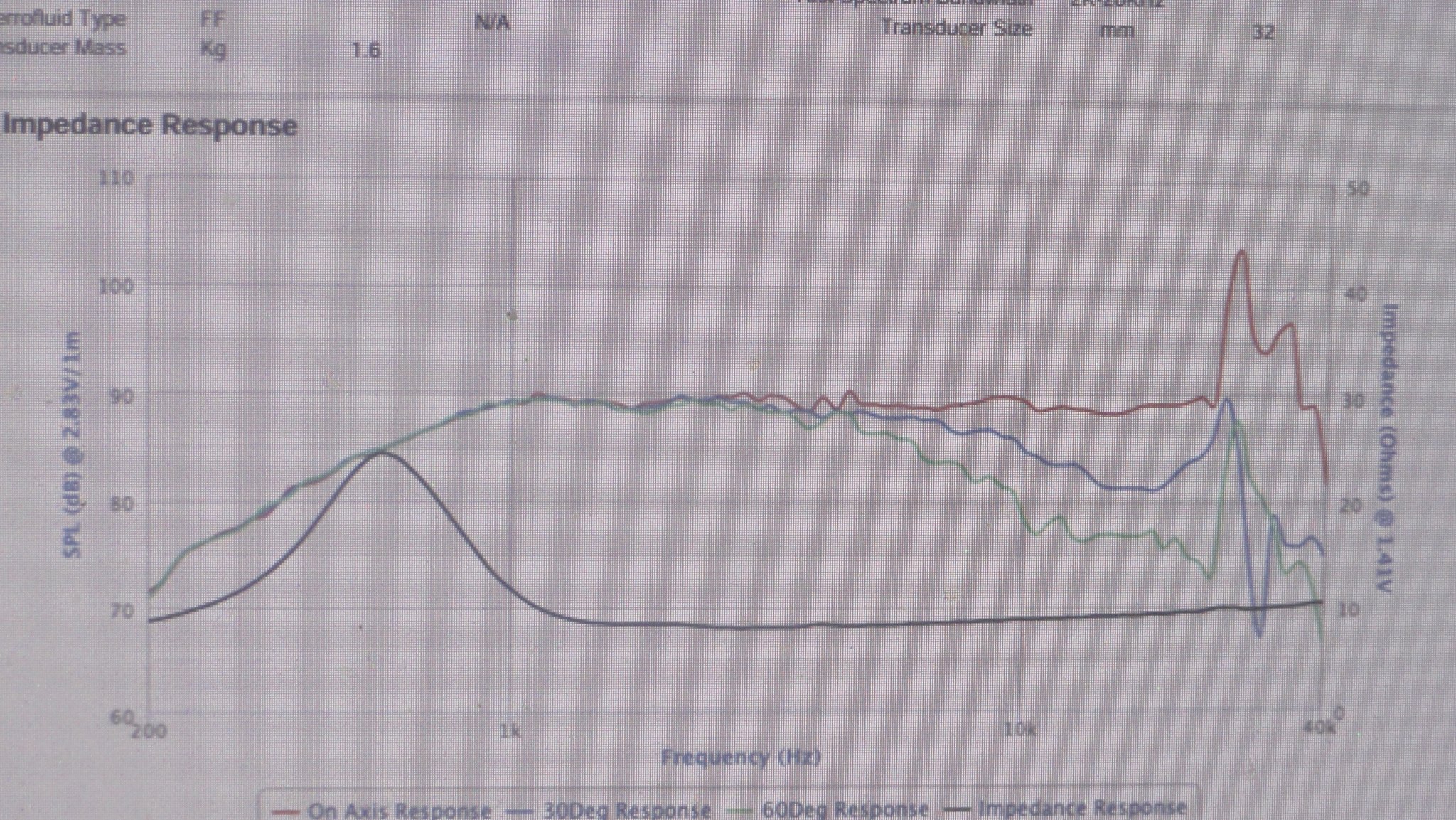

Looking carefully at the sensitivity values of each driver in the graphs...at 800 and 4500 hertz they match up...
