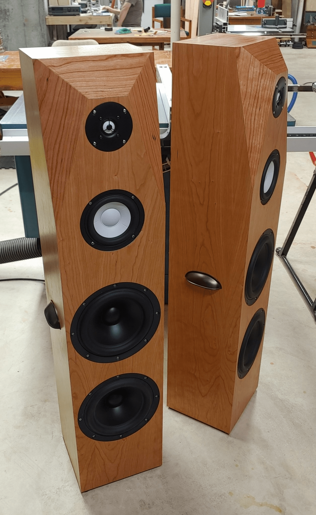

This 3-way active system can be built for $500 per side in drivers, plus another $550 for the hypex amp.
https://www.diyaudio.com/community/threads/new-project-tower-3-way-with-twin-8s.378223/post-6816455
The cherry veneer adds a bit of cost, so a painted finish would keep the cost down. Hypex fusion amps are not the least expensive option for DSP filtering and amplification, so some cost could be saved with a different electonics/software package.
Since the crossover filters are DSP-based, the end user can adjust the response to favor a flatter on-axis response for near field situations, or a smoother PIR response for a more typical listening distance. Bass levels can easily be matched to the room. It is even possible to tailor the DI curve to some extent by altering the mid/tweeter filter slopes.

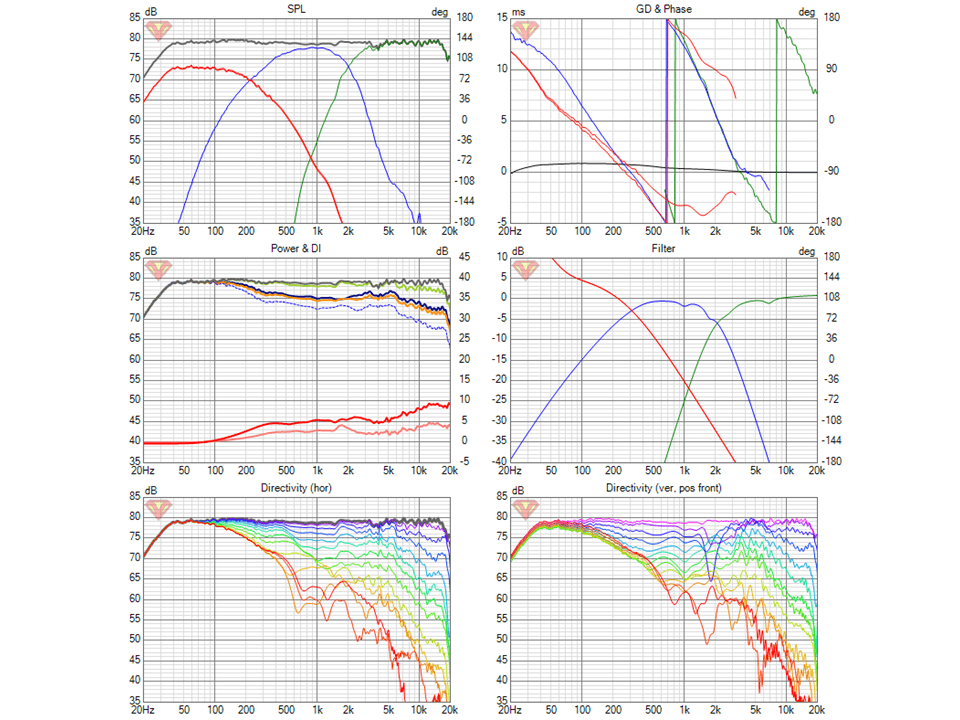

SB 17CAC 26CDC 23NRX 3 way - 550 bucks two years ago - before The Great Inflation time. Today around 750 bucks, but still under 1000, so something remains for crossover parts and a box...but nothing more for fancy finish... 🙂
Revel Performa MiniMe of 90 dBW is possible...

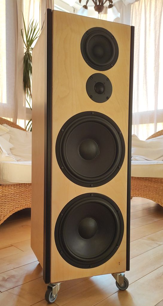

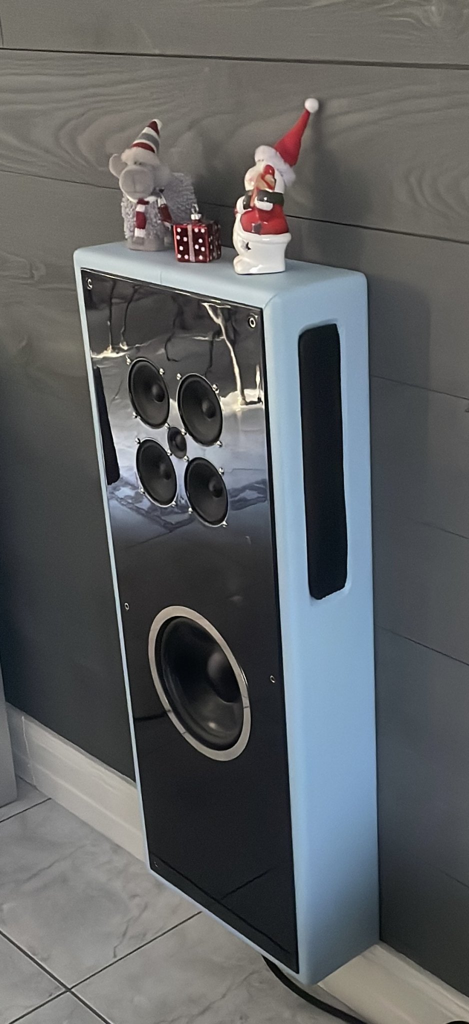

A different approach running active (maybe not a real 3 way):
  • Dayton DCS-205 (actively filtered and corrected)
  • 4x VIFA TC-9 (8 Ohms, series parallel) (actively filtered and corrected, running full range)
  • Dayton ND20-FB4 (first order filtering + passive attenuation > 4k)
  • 2 x (Wondom "Gremlin" AA-AB32313 + Wondom 1701 DSP)
  • SMPS (1kW for both)
Upper part is open on sides (stuffing on back panel), lower part is closed.
Total cost 340€ for speakers (4 wire speakon connectors), 130€ for laser cut faceplate, 50$ for tolex => < 600€
Less than 200€ for Amp + noisy 1kW printer power supply (plenty on resale) modified with PC fans (150€) + 50€ custom alu faceplate
Total 850€, less than 1000€ with wood and glue
Reactions: pelanj and mayhem13

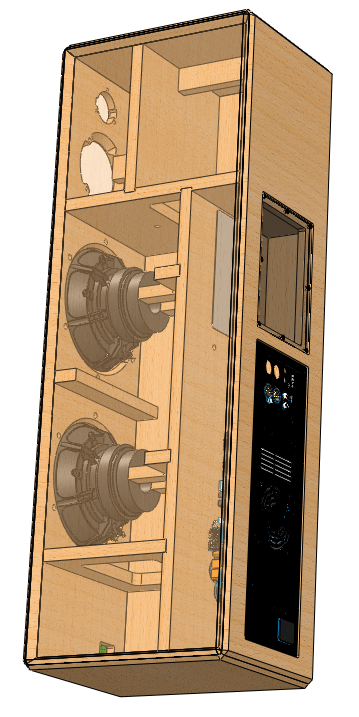

I propose classic 3-ways with simple concept, good HiFi drivers and cuboid encosures for easy build!
(Overall price for drivers only is stated, from the cheapest sources easily available to me in Germany that I could find, incl. all shipping costs)

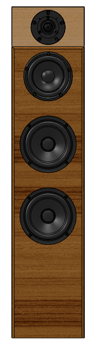

1) CLEAR:
Scan Speak 26W/8534G00: https://www.scan-speak.dk/datasheet/pdf/26w-8534g00.pdf
SB Acoustics SB15NBAC-8 https://sbacoustics.com/wp-content/uploads/2020/02/5in-SB15NBAC30-8.pdf
Seas TAF/GB: https://www.seas.no/images/stories/prestige/pdfdatasheet/H1825-06_27TAC_GB_Datasheet.pdf
Diver procurement: 570.- €
Monkey coffin, CB 45~50L, Xover ~280Hz / 2,2kHz LR4
Bucking magnets for woofer + mid, serial notches for mid+tweeter breakup resonances in xover.
Similar to this, without the lower woofer, cut enclosure somewhat below the upper bass driver, make little wider:

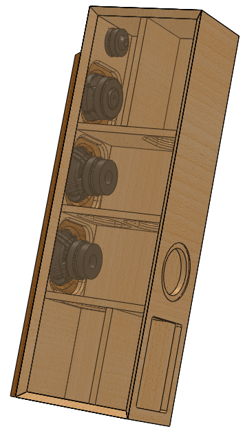

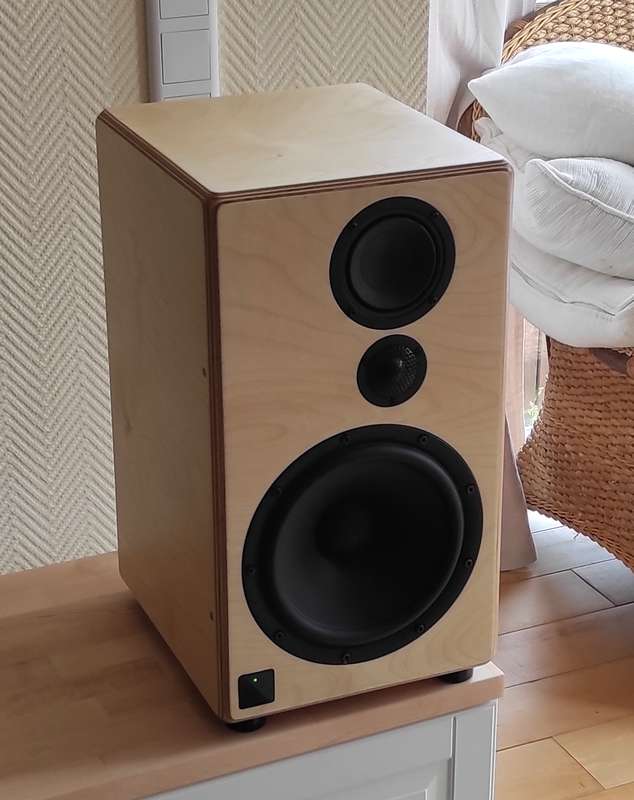

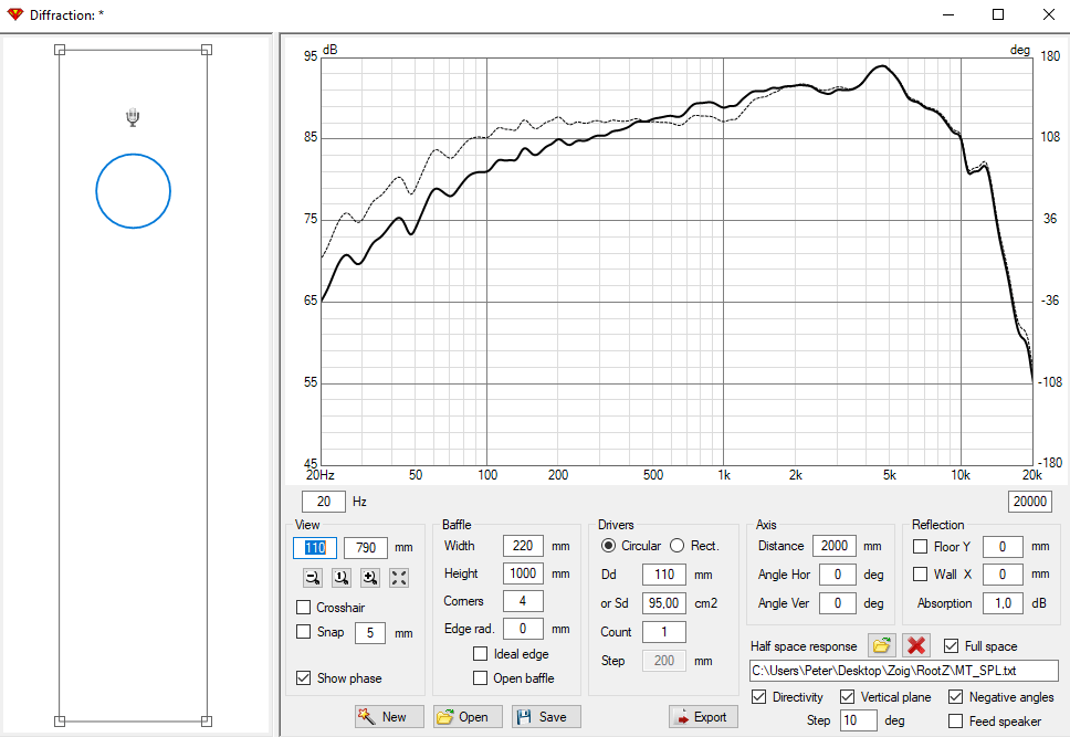

2) DRY:
Scan Speak 22W/8534G00: https://www.scan-speak.dk/datasheet/pdf/22w-8534g00.pdf
Kartesian Wom120_vMS: https://www.kartesian-acoustic.com/copie-de-mid120-vhe
Bliesma T25A-6: http://www.bliesma.de/Datasheet-T25A-6.pdf
Driver procurement: 690.- €
Floorstander, vented 35-40l, Xover ~ 330Hz / 2,7kHz LR4
Bucking magnet for woofer, serial notch for tweeter breakup resonance.
Driver downsize and passive variation from this active speaker, prolong enclosure to get a floorstander, make little slimmer:
Enclosure similar this, with only the upper 22W woofer and without the Hypex Fusion, maybe then a bit lower and less depth:
(Obsolete CAD + Sim concept, the speaker in the pic above will stay in its current physical configuration)

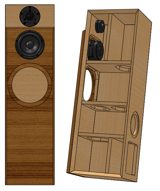

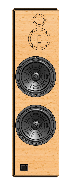

3) SMOOTH:
SB Acoustics SB23NRXS45-8: https://sbacoustics.com/product/8in-sb23nrxs45-8-norex/
Scan Speak 15M/8631G00: https://www.scan-speak.dk/datasheet/pdf/15m-8631g00.pdf
Scan Speak D2604/833000: https://www.scan-speak.dk/datasheet/pdf/d2604-833000.pdf
Floorstander, vented ~40l, Xover ~ 280Hz / 2,7kHz LR2
Bucking magnet for woofer, stepped baffle for tweeter better LR2 phase alignment.
Thinking about something comparable like this as my next project I aim for, still not decided for the woofer section as I don't have that strict budget restriction:
(With 2x SB17NRX2C35-4 in series per side)
As I own something like proposal 1) and 2) which is more or less finished now, it makes sense to me to build and have 3) for different, but good living room sound, and also the experience to develop a passive 3-way, it's my hobby and somewhat I have to build speakers, maybe you know that. I had a speaker as my very first build ~23 years ago with a Revelator 15W, a Vifa XT300, a coil, a cap and a resistor and I remember it to sound very sweet. Should work good with those drivers as LR2 with few xover components, when you optimize the baffle shape:
