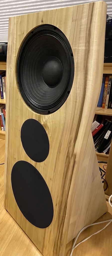

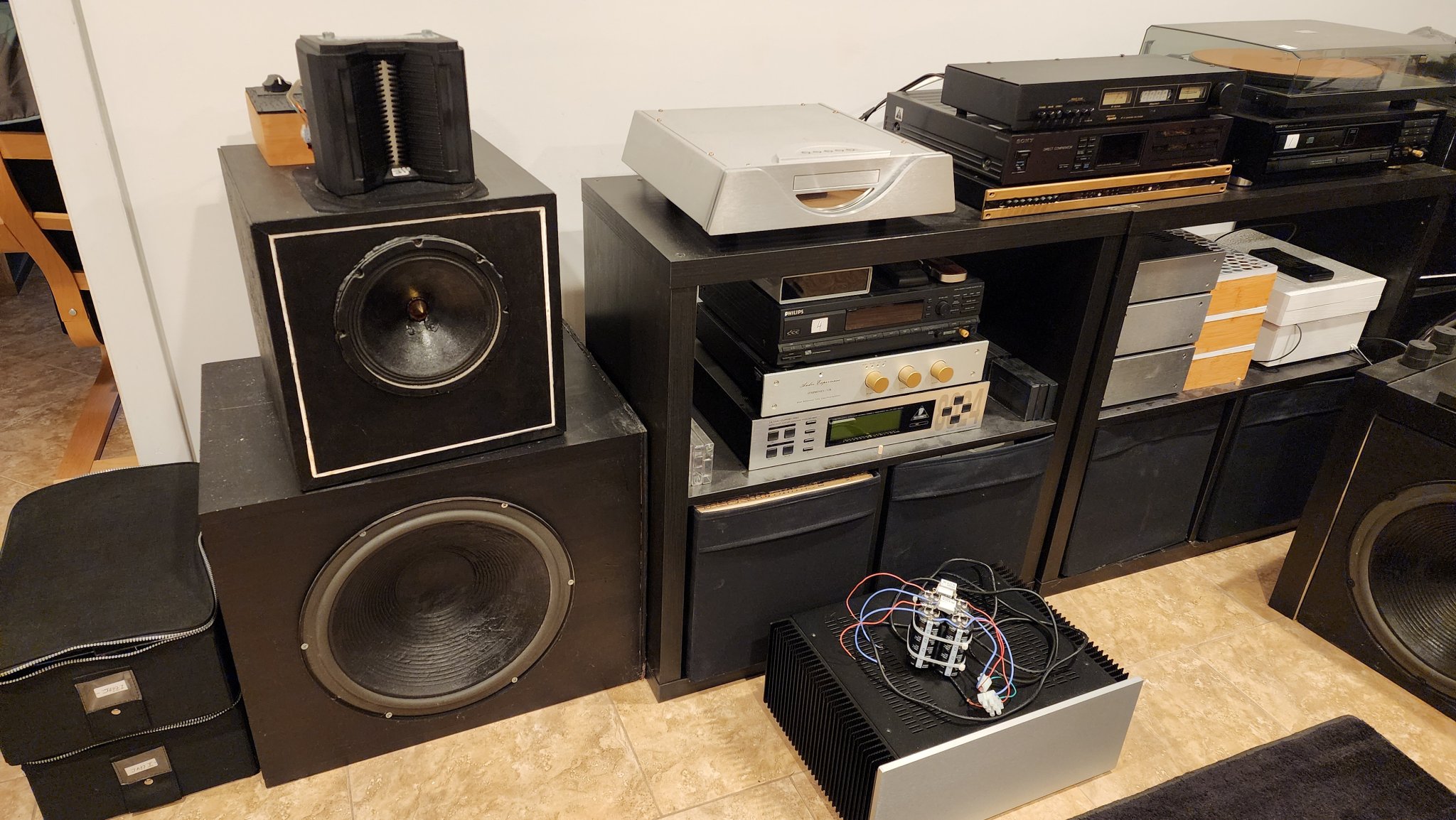

Tweeter big Heil, mid Betsy wow, woofer 15" Jamo.

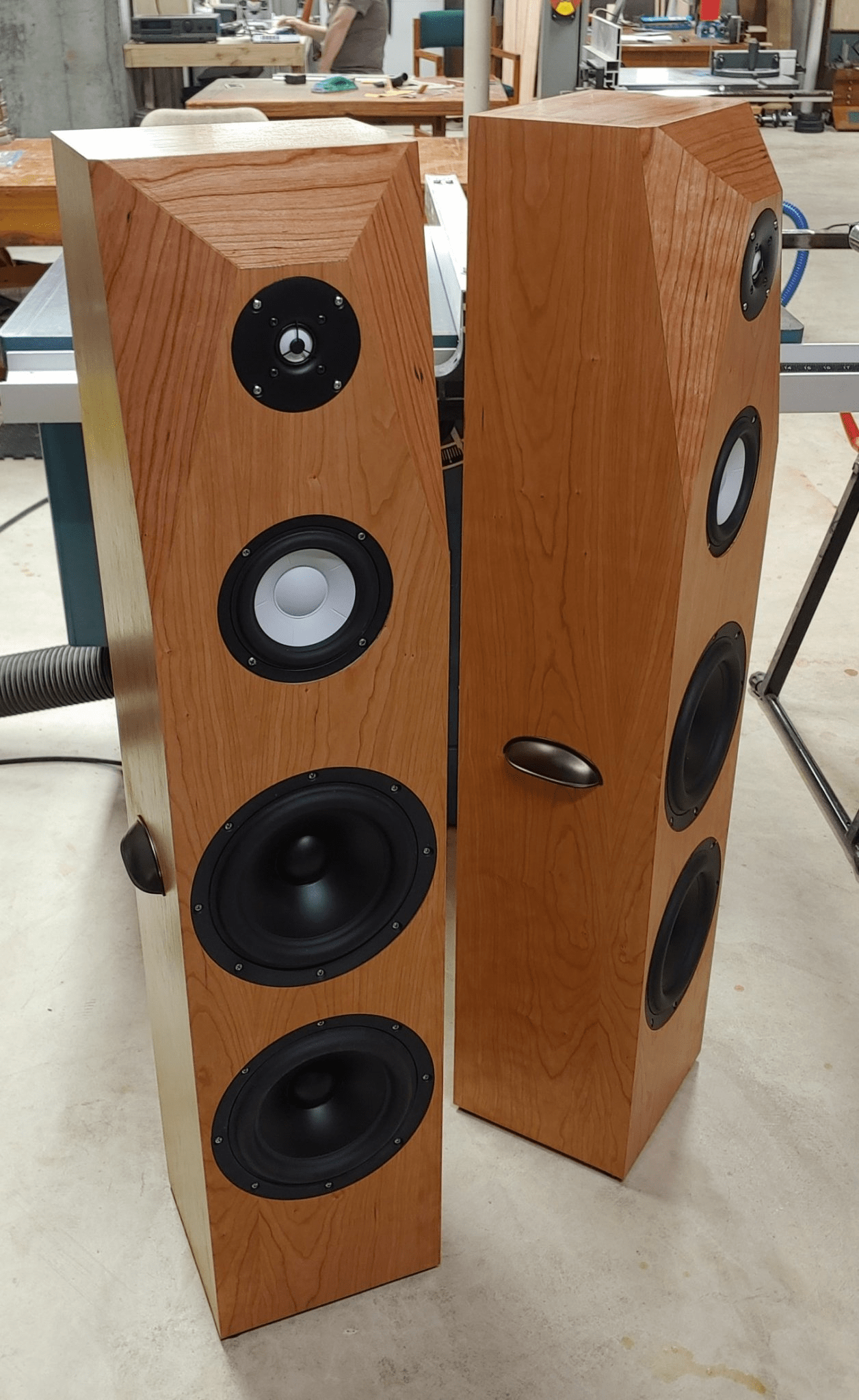

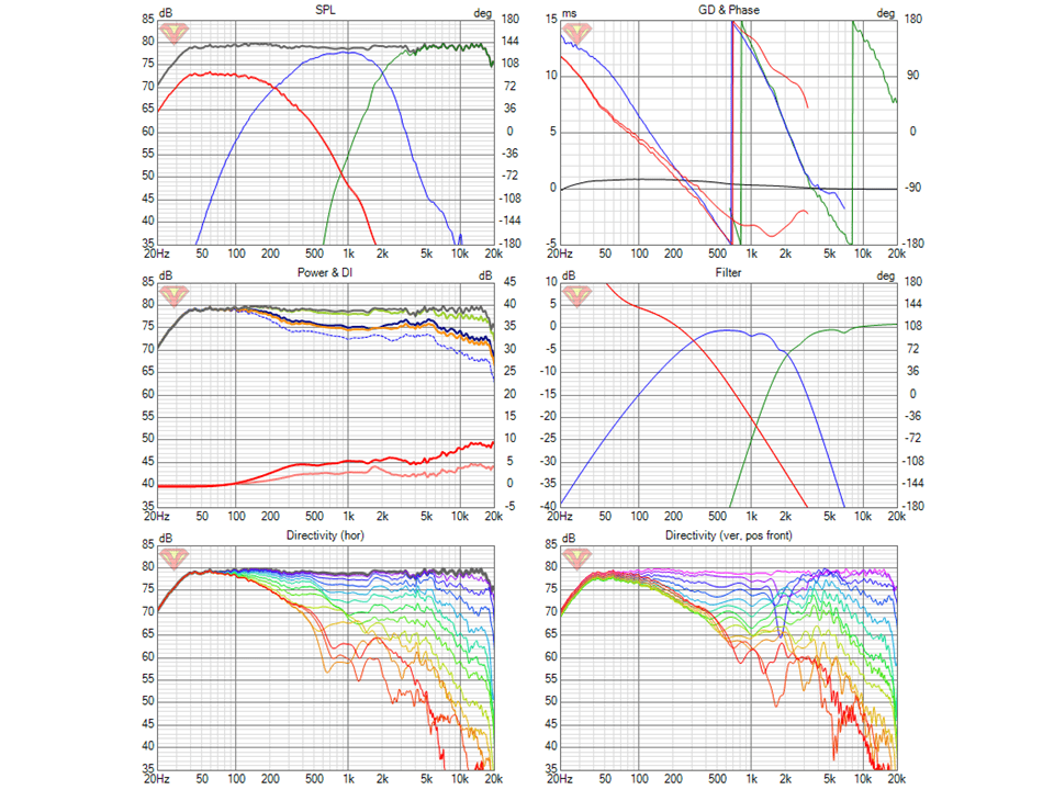

This is a 3 way active biamp dipole, where woofer and midrange are both $110 Dayton PA310. Total component cost including DSP is $1100. You could shave cost to below $1k by using a less expensive woofer ie $60 Dayton DC300. You would give up efficiency with that choice. You could also switch to a less expensive tweeter and a waveguide like the Visaton WG148.
https://www.diyaudio.com/community/threads/open-baffle-bass-reflex-hybrid.393837/
Constant Directivity, hybrid Open Baffle, linear phase, high efficiency, and live edge wood.
