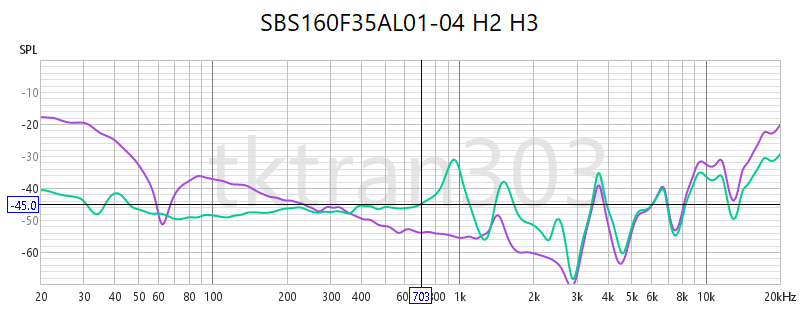

Btw the SBS160F35AL01-04 well behaved as far as 6" woofer goes:
Reference: https://www.htguide.com/forum/missi...but-ruthlessly-simplified?p=950083#post950083

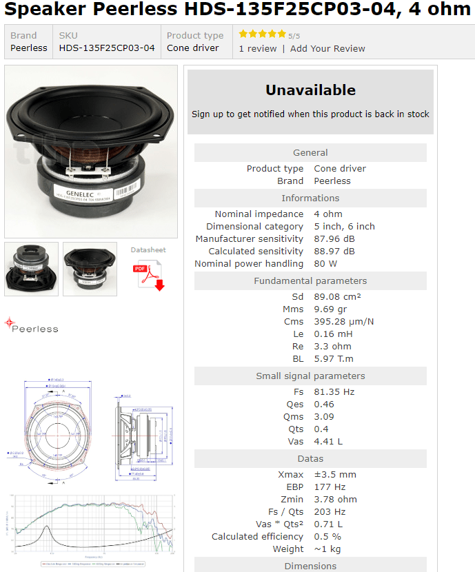

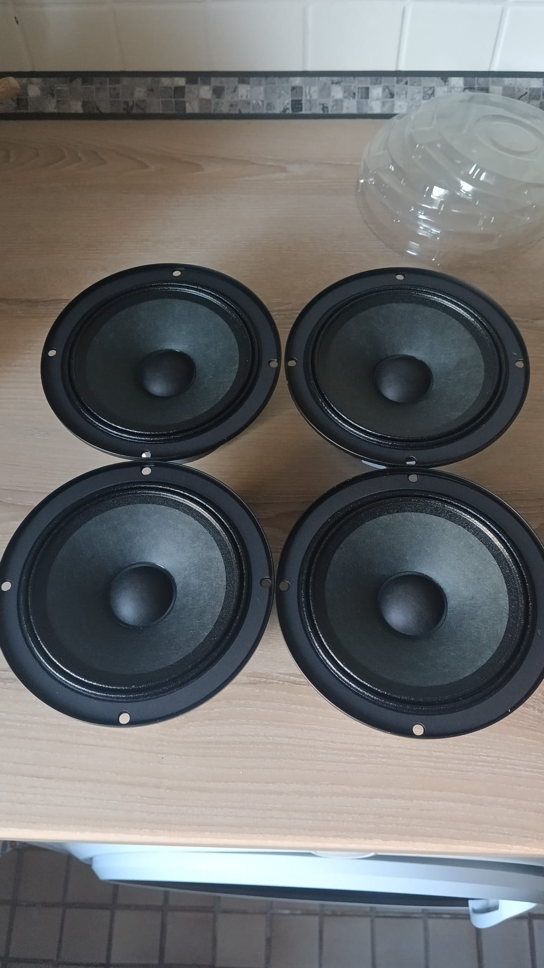

While i might try two midranges in some configuration, it will probably not be this one. I've bought 4 of these and will probably use only two. Other two will remain in reserve. I don't want to find myself in situation where i really like the sound of speakers, something happens with one of the midranges and i have to dig for another pair of transducers that fit and completely redo the crossover. Price is right so i decided to buy 4 of them. I listened them multiple times and i really liked the midrange.
On the price matter - it seems that TLHP is one of the last sane dealers of transducers in Europe. Those price are with VAT.

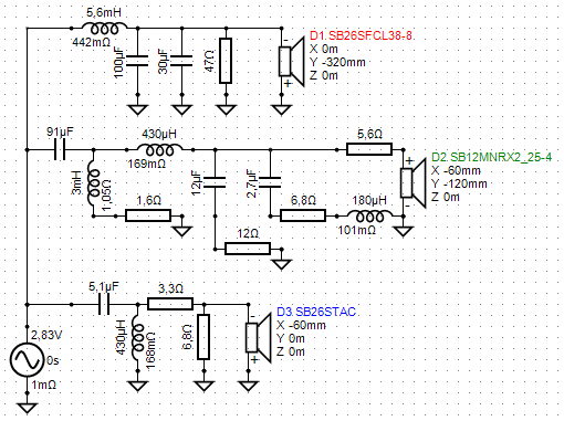

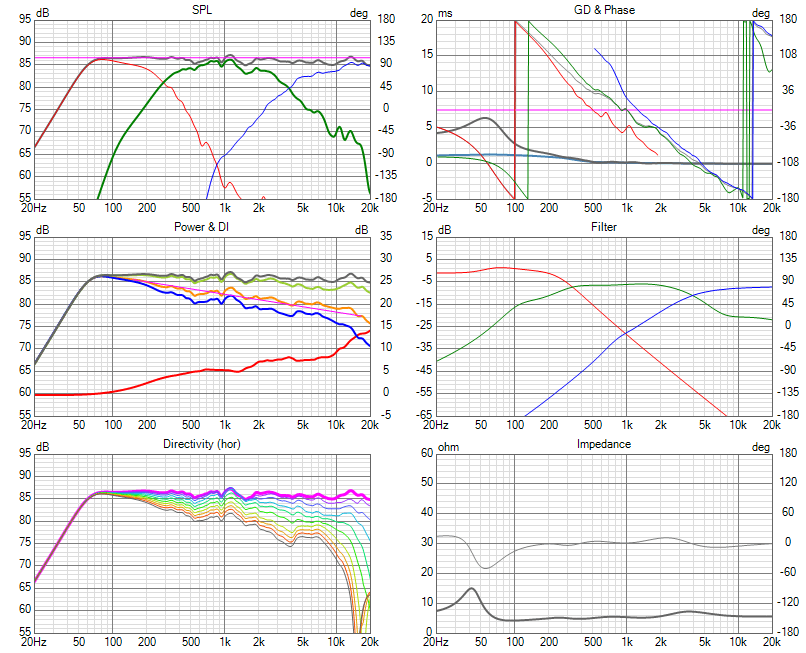

SBA 3-way floostander on a budget (less than 300€) I have in mind: 30*80cm baffle, closed box 60L, x-over frequency 300/4000Hz
SB26SFCL38-8
SB12MNRX2_25-4 or Peerless TC9 / maybe in a D'appolito config...
SB26STAC-C000-4
Preliminary simulation
You can improve the directivity in the HF area with using the SB19…..a remarkable but overlooked tweeter……with a 3.5” mid crossed at 4.5k as in your sim, the little 19mm is more than up to the task and the off axis response is crazy good!

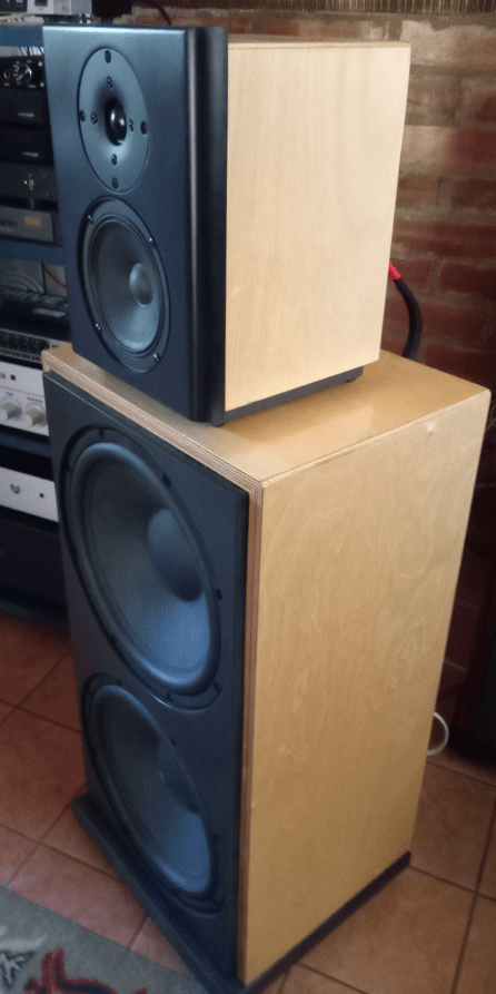

Another variant on the theme: Twin Beyma 12BR70 in a damped back OB with FSL-0152 + BC25TG15 in 6L closed top box.
Hybrid: active bass/top box. Top box passive, measurement at 1 m after final x/over test.
