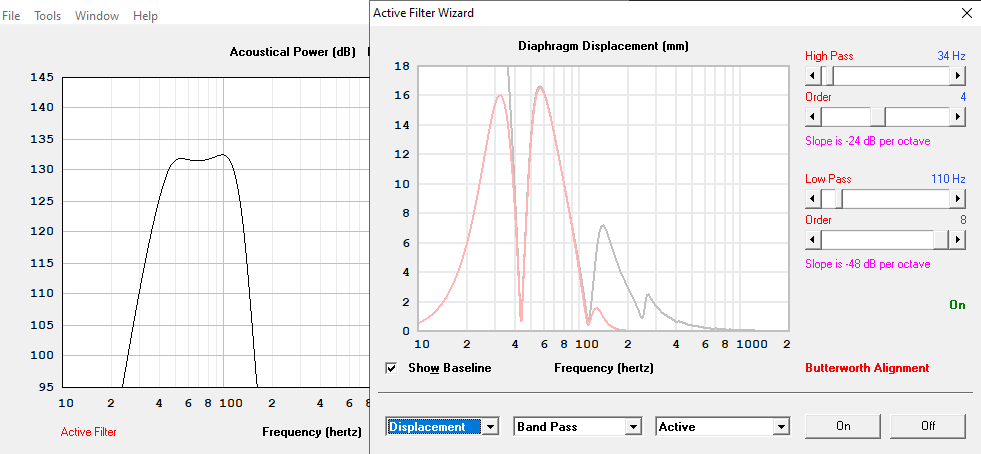

I have two THAM 15 mk2 with B&C 15TBX100 drivers (8 ohm). At which power will they reach their Xmax? Each driver has a 2000 W amp (bridged Yamaha P7000S); do I need to worry about destroying the driver?
What you need is a highpass filter to limit excursion- What sort of crossover will you be using? A quick check suggests 8th order at 33hz or so should work.

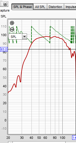

I have a Yamaha SP2060 DSP. I currently have highpass-filter at 40 hz (24 dB/oct BW). I have a 48 dB/oct crossover (LR) at 110 hz. In the attached image you can se the frequency response just a feet in front of the sub.
I would say 35Hz hi pass 24db would give a bit more excursion, which can keep the driver cooler and allow a bit more bandwidth. The Yamaha processor seems only have one limiter per channel . I would of thought that a longer attack & release characteristic would provide adequate themal protection for the driver as long as clipping was avoided. Top range speaker processors have Peak (max power or clipping limit) - Thermal (longer atack & release characteristic), and excursion limiters operating only at lower frequencies.
In this case I think that voice coil overheating would be the primary failure mode!
Displacment seems a bit high at full power but is not allowing for any compression or other losses - Xmax is exceeded but I am not sure what Xmech is with your driver & only at this level with transient peaks if hard limiting or clipping is avoided. - The lower Hi-pass allows a more balanced excursion above & below the minimum.
