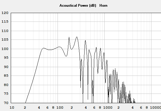

Is the reason this looks disproportional towards the base frequencies due to wave length actually falling into theThe THAM15 with B&C 15TBX100 probably has a bit more output than the SUB 8004 in it's pass band.
"Coverage" is simply a matter of using the inverse distance law, sound drops at 6dB each doubling of distance, -20 dB at 10meters from one meter outdoors.
If you are happy with the output of a pair of subs at 10 meters, another pair will make you about that happy at 20 meters.
Indoors, all depends on the room modes.

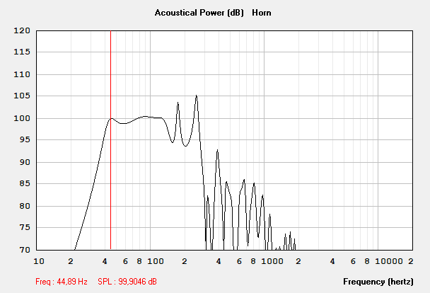

Hello, has anyone loaded a Tham15 with a B&C 15NW76? I already have the driver and I'm about to build the enclosure... should I stick to the original Tham15 dimensions (specified for use with B&C 15TBX100)?
