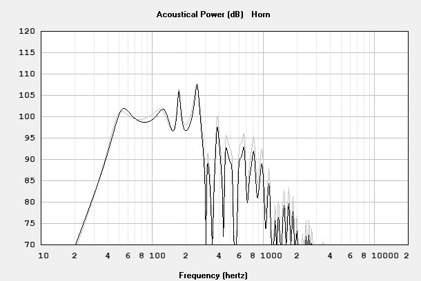

The SB Audience NERO-15SW800 looks like it sims fine but I would avoid the Pyle Pro PDW15125, that thing does not sim very well. Very peaky.
Grey: B&C
Black: SBA
The SB Accoustic driver should work fine. impedance, group delay are all within margins.

Thanks for your view. It looks like the SB Audience Nero is the way to go.Can you get a hold of some Oberton 15XB1000/15XB700/15B500 or 18Sound 15LW1401?
This is great information and gives me the confidence to go ahead and buy a pair of the SBA'sView attachment 1037876
Grey: B&C
Black: SBA
