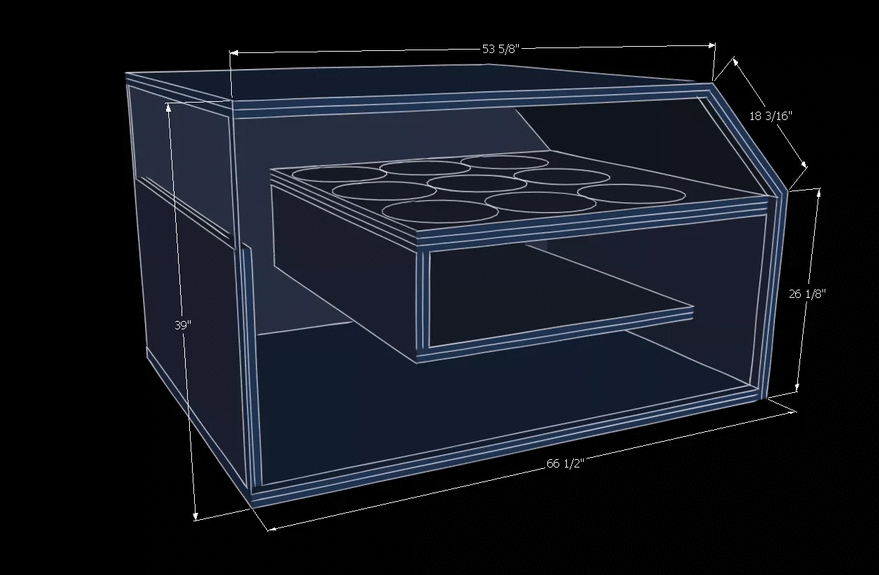

Lol, why the model looks like a BASS guitar!
In a dual opposed roar I enter the squeezed down CSA to mimic the real aftect slightly? Between the magnets the occupied volume as CSA missing in that areas length (fudging it) sorta...
this is important. because VAS is a lie in these instances otherwise. we must promote the ability for the sim to 'see' the area of air its feeling and displacing into surrounding. its two sides of the cone... its cone control, its not moving to cool so much either... we must protect our equipment to play hard safely. VAS is already a horribly misused, mismeasured TS parameter thats not in our favor as a high order vented. not the sealed in any way or lump summed casualty of vented qw.... i believe certain parts of a frequency played in a variety of music and the output level used can and will cause helmholtz or otherwise in the sections of the ROAR, HF in a PARAFLEX, especially the alternate offset version, and in a translfex, amongst even folded and twisted MLTLs its all dangling in the musical output level the response only hints at the bulge or the void.. (phase vector sums at the collision in SPL, crack or bulge,constructive/destructive interference...we both have seen lots i imagine?) in higher order cabs it shows up on the amp end at frequencies in particular too....efficient is a great look at one aspect of many, but on real scenario i create an under powered source that will go into protect even... testbench is what it is... and sling a tone generator not a sweep or pink noise at these things... its dangerous and harming equipment is not something i can say i didnt do... but you have an awesome cabinet design(as you know) and if tuned too low(as you know) the smell of excursion isnt just a voice coil adhesive, if its not a bad tune (too low), its time for a proper powersource to be given to a proper driver for these. its a real sign of something special when you can se the acoustical magic transfer it wants in energy at areas in the cabinet makiing them!! roar can be crazy in aggresive layouts and holy shooot is it fun to look!! or dream! baby steps were the plan. this is my fourth high order 8th cab. one transflex and two para. a isobsaric 6th and now i will ROAR 😛
all of that to lead up to a roar question: would it bealright if i run a few sims by you for approval and at your leusure? maybe you select the 'best' and make any changes youd suggest?
all of that to lead up to a roar question: would it be alright if i run a few sims by you for approval and at your leisure? maybe you select the 'best' and make any changes you'd suggest?

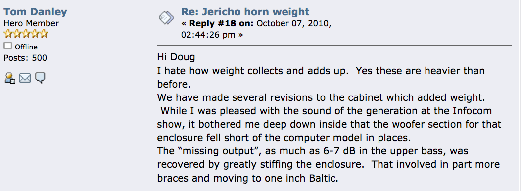

Ad bracing: my own tests and those of others show little influence of bracing on max. SPL - somewhere in the area of less than 1 dB even with much stronger chassis than the 15LB075.
Any difference would actually show itself in the area around the resonator's tuning, where there is the most pressure on the enclosure. Your assumption that bracing would mostly benefit upper bass frequencies is, again, ridiculous.
(That is not to say I would not recommend bracing in general - it can/will reduce annoying creaks and such, and the box might subjectively sound a bit more defined at higher outputs.)

Regarding the bracing, a loss in SPL is given as the energy is transformed I to vibrating the panels rather than.moving the air, but one should also see a distortion increase, correct? That in a measurement like this may limit the SPL prematurely, or have you measured this and found that it is not the case?
That's a pretty good summary actually. You do need equipment as well as space as well as a whole lot of time - rushing it is NOT compatible with producing accurate results.
For distortion limited SPL measurements, you have to confirm every single element in the signal chain does not add its own distortions. With the pre-amp for example it's tricky to get it right - set it to too low a level, its noisefloor will influence the measurement - set it to too high a level, it will overdrive / clip. Similar with the soundcard used. Similar with the amp.
The German magazine Production Partner regularly measures boxes with a 3% vs 10% distortion limit. They have some free tests available on their website. If you're interested in the subject, look them up.
I actually did add one brace to the (inner side of the) back wall of the THAM; after taking the picture, but before testing. That's a very large unbraced area otherwise, so I just pro-actively put a brace there - just because it doesn't hurt 😉 - and because it might sound slighty better in listening tests.
I've done comparisons. The difference between braced and unbraced is more audible than measureable, and is more that of a more defined sound than higher maximum output. It seems counter-intuitive, but there's almost zero difference in measured max. SPL, even with a relatively unstable material such as chip boards.

Regarding my "ridiculous assumption" about bracing, tests done by Tom Danley (the inventor of the "Tapped Horn" designation we use for the Tham15, SS15, etc.) support my statement.
Jehrico horn
Reply #18:
“I hate how weight collects and adds up. Yes these are heavier than before.
We have made several revisions to the cabinet which added weight. While I was pleased with the sound of the generation at the Infocom show, it bothered me deep down inside that the woofer section for that enclosure fell short of the computer model in places.
The “missing output”, as much as 6-7 dB in the upper bass, was recovered by greatly stiffing the enclosure. That involved in part more braces and moving to one inch Baltic."
At any rate, it would be interesting to see the difference in 10% distortion limited output using a driver that has over double the Xmax of the one you chose to measure.
Keep up the good work!
Art
