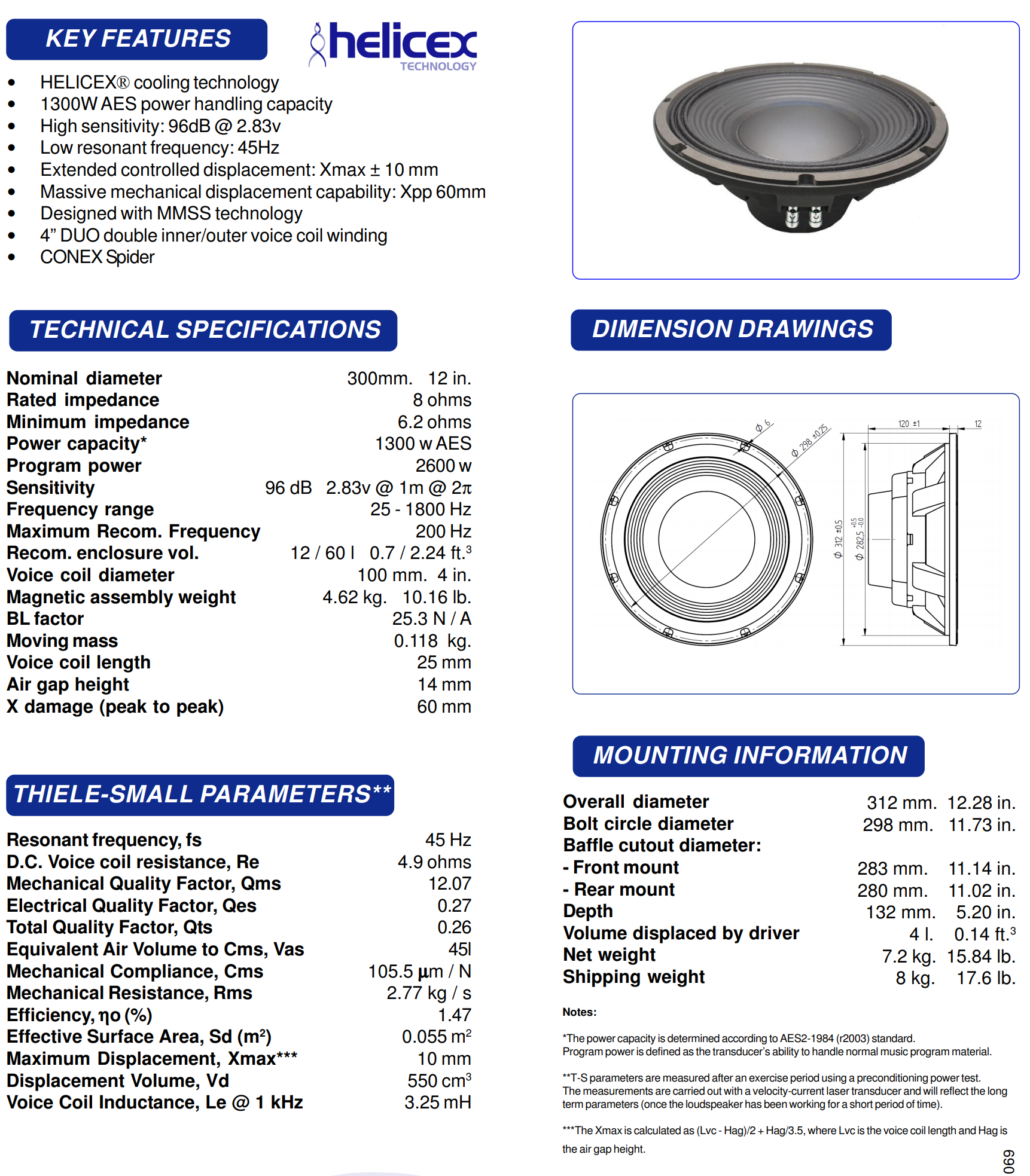

THam 12 is without any kind of adjustments. "Martinsson original". The internal is without any other improvements like we know at Tham 15 ...the MK I to Mark IV. simple Tham12"
Who can make simulations for liniarity. Xmax. power.
https://www.beyma.de/fileadmin/seiten/download/pdf/Beyma2009/12SW1300Nd.pdf

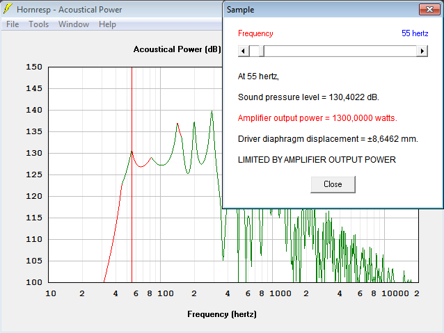

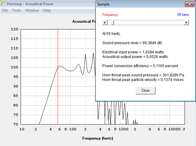

Here are two simple simulated comparisons between ROAR12 (grey line) and THAM12.
Spl at 2,0 Pi one watt (2,83 volts), and max spl based on 1300 watts and 10 mm xmax.
Most of the energy in the bass region is centered in the midbass around 80 Hz. The ROAR12 will have about 3 - 10 dB more output in that region compared to the THAM12.
One ROAR12 will match two THAM12 with ease - according to my experience. Then there are a whole lot of details not seen in a simple Hornresp comparison. The split path symmetrical loading of the driver, the plane loading of the driver diaphragm etc... Those details often do much more difference at real life high power levels usage then simple simulation graphs indicate.
The THAM12 does sound a little more "easy going" and joyful then the rather dark, serious and brutal ROAR12, but the ROAR12 does have a much more pronounced midbass attack and punch. I would personally prefer the THAM12 for indoor usage and the ROAR12 for outdoor usage. The ROAR12 does excite walls, windows, floors and everything that in any way can rattle and buzz, which is something to consider when choosing the design most appropriate for you.

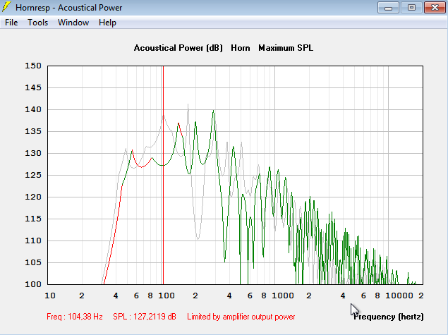

I said it before, but Circlo what do you get if you extend the path beyond the tham fold?
A version of roar right?
Add 30cm to tham15 using detachable “barndoor” extensions and make the finishing area to full front area of the tham15. (Practical)
This will fill in the dip at ~150hz and also lower the tuning some.

I agree, but this shift in dips in this case is quite favorable.
I have four tham15 with B&C 15PZB40 and of course I simulated before building them.
And using the original simulation input I get the solid black response. And by adding another segment 30cm long and ending area to 3400cm2 (the full front area of the original design).I get the light gray response with this mentioned “barndoor”

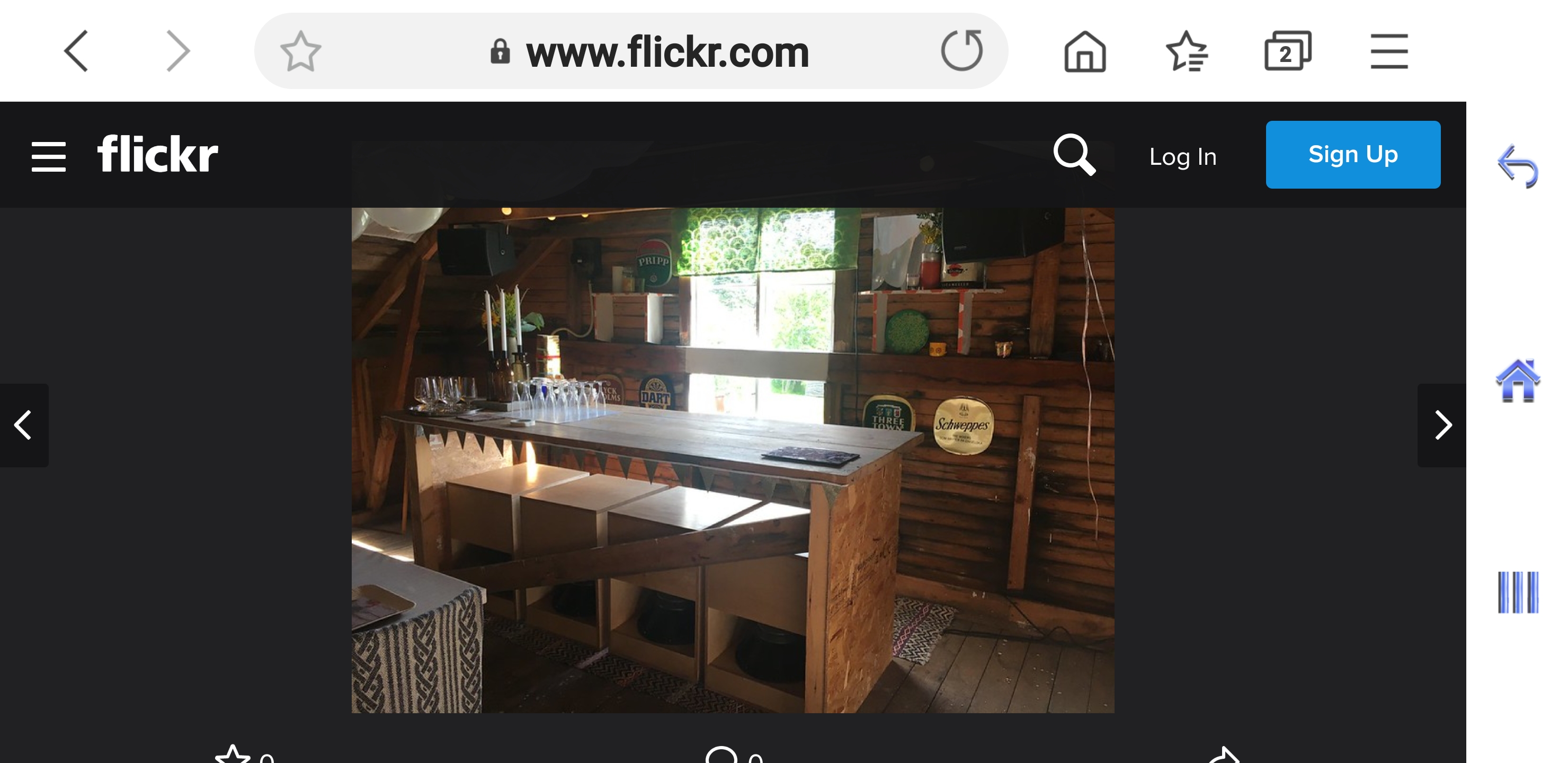

It’s a small barn where the first floor have been rebuild to a garage and a hobby-room.
And I stole the garage for my wood shop.
But the top floor is only for parties. Not that I have a lot of them. But it was for my wedding party I built this set of horns.
