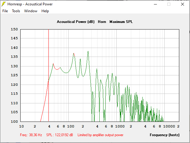

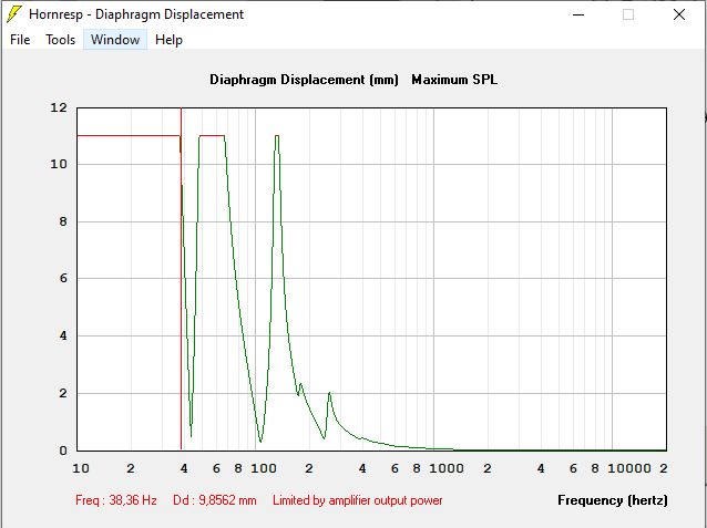

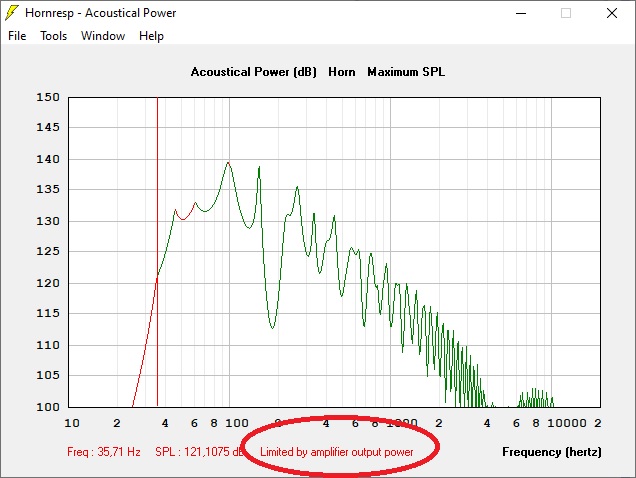

The THAM15 is 40 Hz capable without modifications. Look at the cone amplitude at 1000 watts and 11 mm (XVAR) with a B&C15TBX100. It is clearly amplifier limited below 45 Hz. Not xmax limited.
With the right processing the THAM15 is 40 Hz capable alone in 2,0 Pi.
The lowest resonance frequency of the THAM15 is above 40 Hz - check your first image. Typically, the only processing you want to do with a high-order alignment below its lowest resonance frequency is high-pass filtering to prevent over-excursion.

That 15TBX100 is an interesting driver btw. Did you use the semi-inductance parameters for it in your sim? They can make quite a difference.
This is an example of a 42 Hz tuned THAM-style fold that could work for the 15TBX100. Box size is 18"x25"x30" and CR is 3:1. Problem is that while the response looks decent with semi-inductance turned off, turning it on (using some parameters I derived from its published impedance curve) results in something quite different.
