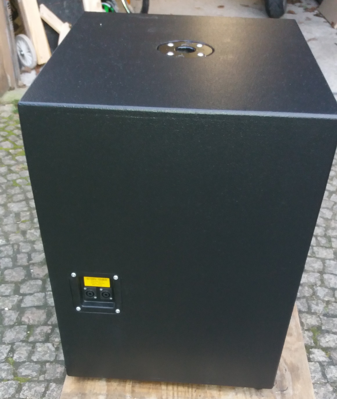

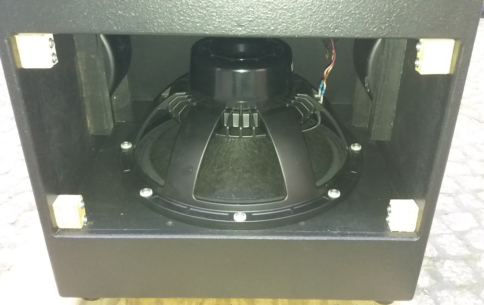

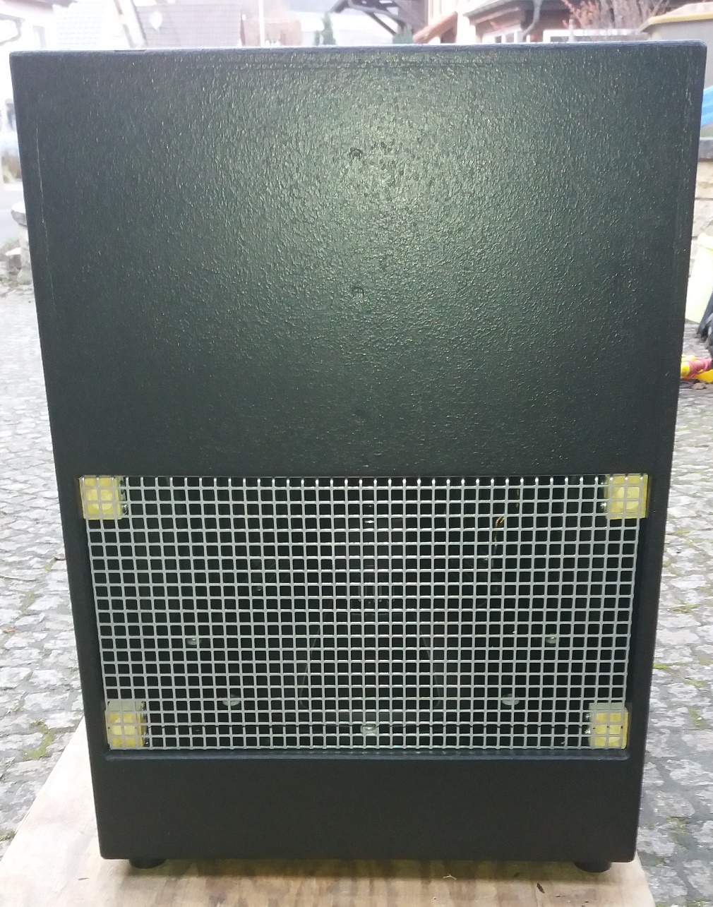

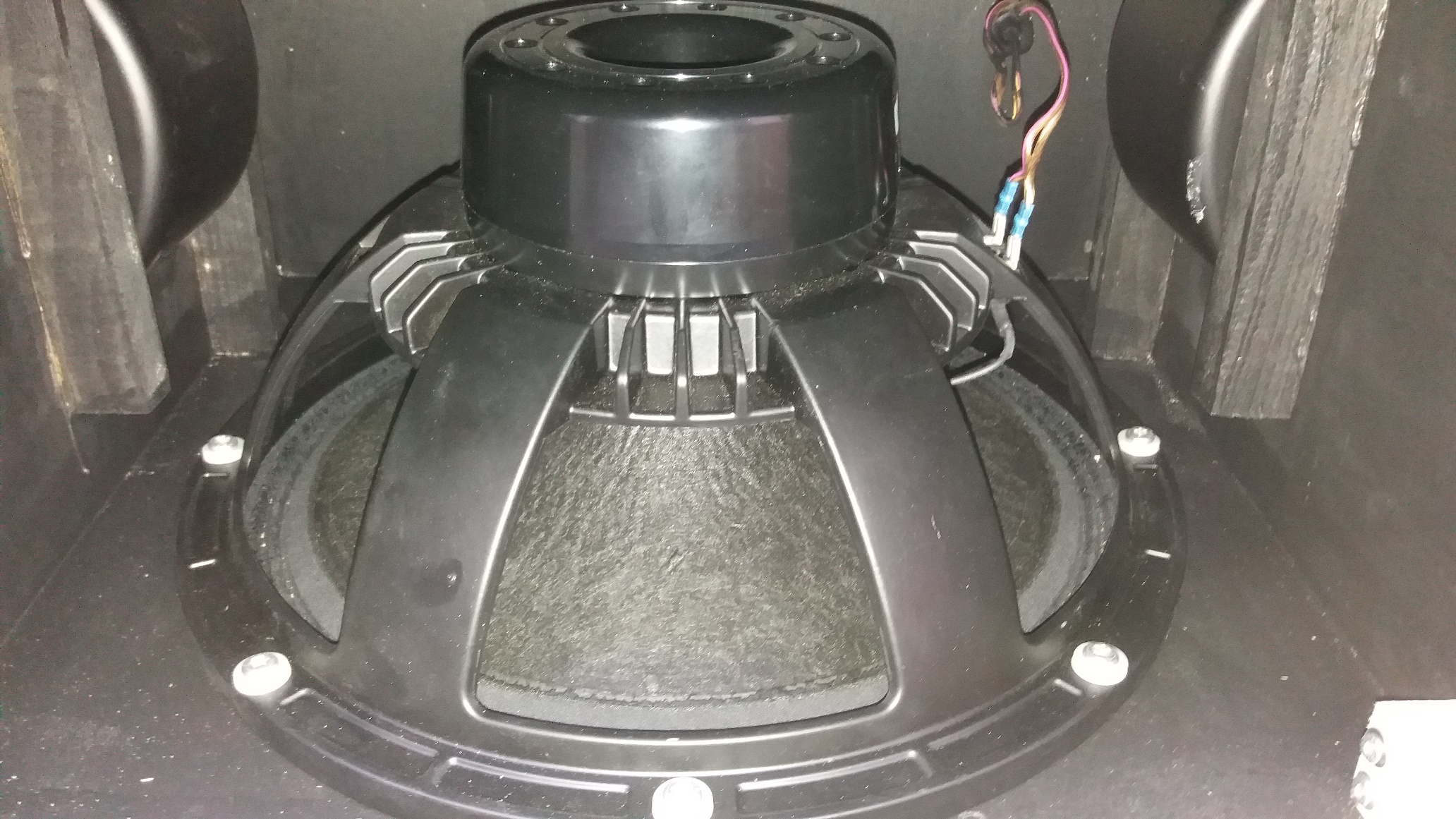

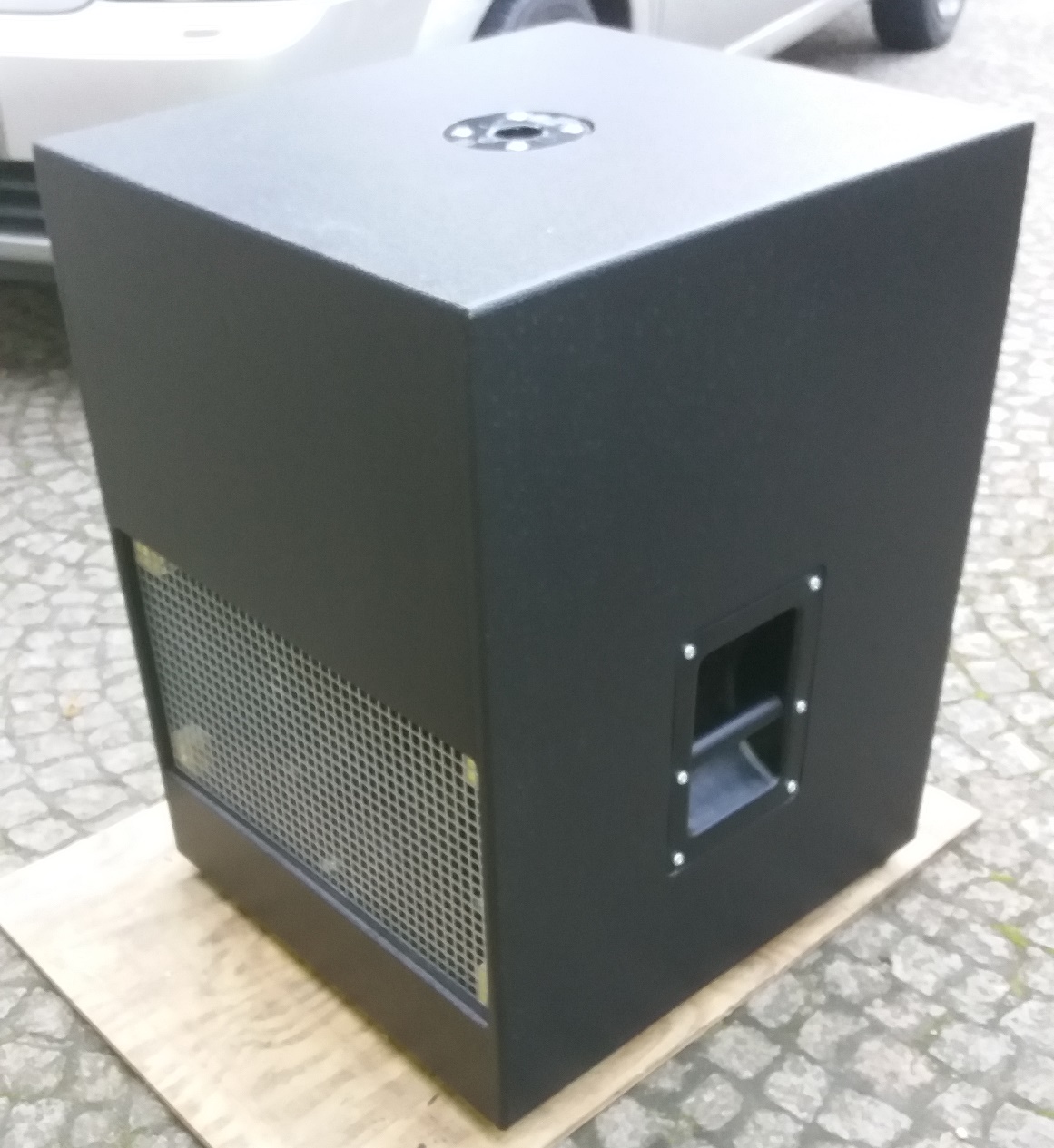

At least 6 Years later I built the Tham15 with the B&C 15NA100.
Foam and neodym magnets for holding the grill are still missing.
Amp for testing was Apart Champ 3D with DSP and only 400W for the Sub, can easily keep up with two 10" tops. First impression was very good. Hope to find time to test it in the next days with more power.

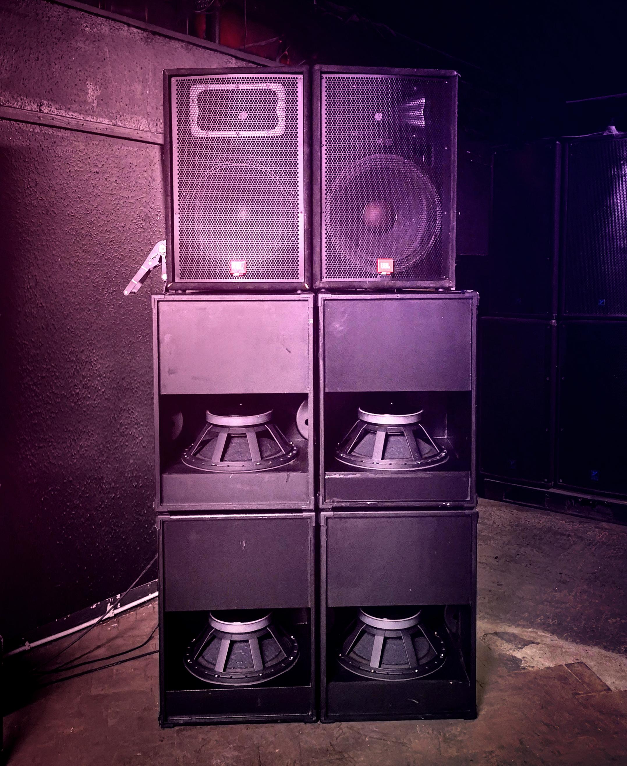

Like what a lot of people have been saying, it depends what your looking for! This is what i've noticed:
- THAM 15 is really easy to drive due to the efficiency.
- In terms of SPL, 1 tham 15 will match 1 double reflex sub (or two single reflex)
- The bassseems to fill out a room really well and works very well outside.
- It has a nice natural roll off
- -10db ~40hz mark
- We've had DJ's play all sorts of music on them, Disco to from fast heavy techno to slow melodic dub. All we've had is compliments on the sound.
Essentiually you wont find a more compact, easy to run speaker system than this. Sure if you want high spl under 40hz your looking at a Dual Bass reflex cab & Expensive amps OR a larger 18" horn loaded sub like Xoc1's TH-18.
I've attached a wee snap of our current setup from last night

The tops are JRX115 (second hand bargin) which have had D220 Ti's installed after the fact. TBH though these are just stand in's for our PM90 Mid tops which are far superior and were getting a few fixs applied at the time.
The dual JRX's were struggling to keep up with the 4x THAM15's which had loads of headroom left.
We play everything from Disco & House to Jungle & d&b.
Going with the THAM12 you get a more compact, lighter speaker but you loose some extension & power handling. Most avereage people wont really notice this unless there is a side by side comparison or your a sound guy tbh.
Two tops and two subs are perfect for small parties. The two tops and four subs we ran was for a party of about 300 and was MORE than enough. Easily fits in a small van or people carrier with the seats folded down.
