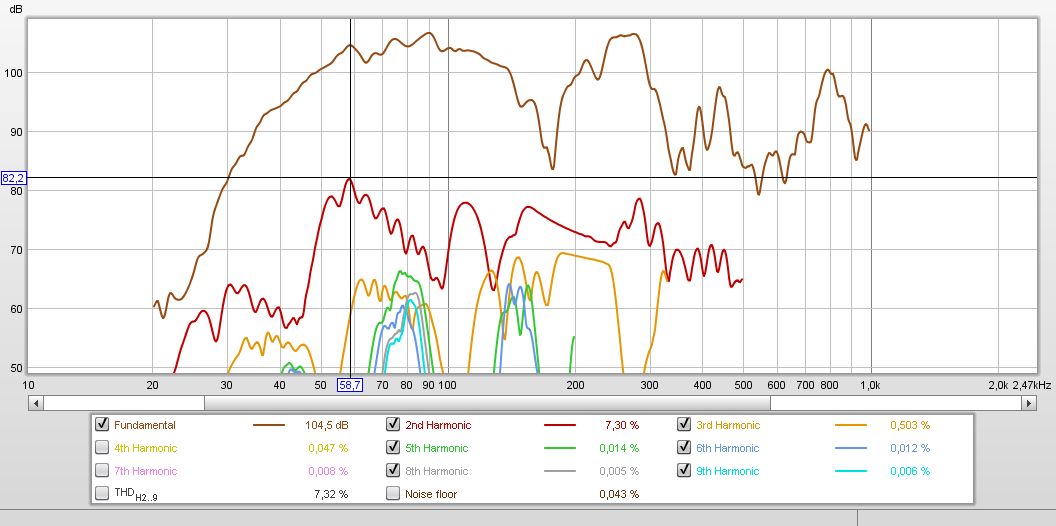

Brian, what do you mean by "standard 4th order 6th order BP alignment"?
I assume the response plot you show is from a helmholtz based design and if so then obviously you would see very different acoustic filtering charateristics compared to a qw based design of simillar order.
The question is how much of the messured out of the band noise that stems from the driver direct generated sound and how well the folding deals with the out of band resonant components (higher order harmonics).
In the end what matters is the filtered (processed) response and that would significantly improve the situation, but there will still be higher order harmonics present, the question then becomes is this critical for the perfomance, my take on this is - no it is not, but we are all entiteled to our own opinion.
That should have been "standard 4th order or 6th order BP alignment".
Agreed. The BP arrangement will typically provide better filtering, The TH arrangement is supposed to provide greater sensitivity (the penalty being a larger box), a wider passband (though not necessarily a wider *useful* passband) and better driver cooling (with it having its motor situated in the mouth of the design). Undersize a TH however, and basically what you end up with is the acoustic equivalent of a basic bandpass box, with poor filtering of out of band noise. It might be best then at that point to just go with a well-designed 4th or 6th order BP box, unless you're really concerned about dealing with the heat from the driver's motor at high volumes. That said, there are ways of dealing with heat buildup in 6th order BP boxes, if the layout of the box is designed appropriately.
As both of the published images are measured response curves, I think that your question's already been answered. The acoustic filtering of the TH's path may apply to higher frequencies. However when you get below about 300 Hz, the only way to filter those frequencies out is extensive stuffing (which also kills low frequency performance), or filtering the signal (which unfortunately does not filter the HD amplified by the out of band noise). In comparision, for the example that I gave, the combination of vent sizes and lengths and driver position in the box resulted in significant nulling of the first out of band resonance peak, resulting in a bandpass box that could theoretically be used with no active filtering at all, as the out of band noise is significantly below the level of the passband, and the HD is reduced as well as the acoustic filter is now more effective.
So what Helmholtz design is this that you are referring to and where can I learn more about it (size, driver compliment, performance).

The comparison is interesting, don't get me wrong, but the if your main concern is the out of band noise then simply build a Helmholtz based band pass since not much else will beat it in that particular regard.

If I where to design a higher order Helmholtz based (ported) band pass enclosure I would be surprised (to say the least) of seeing a out of band response like that of QW based design such as the THAM15 seeing as the acoustic filtering part of a Helmhotz design is not even present in that case, or in any case regarding TH's, this is a given, so I fail to see the value of that statement, or am I missing something?If I saw curves like that from a standard 4th order 6th order BP alignment that I was trying to put together, I'd toss the design and go back to the drawing board to come up with something better (like the attached, which shows a lot less out of band noise).

When aiming for the same response in useful bandwith, parrallel BP 6th vs TH (and their variants) is just a matter of compromise, between filtering vs headroom, depending of segment/port size/lengh, affecting chuffing/port compression/resonnance.

A Helmholtz-resonator port will have mainly odd order harmonics and does sound quite different to quarter wave resonators that tend to have mainly even order harmonics.

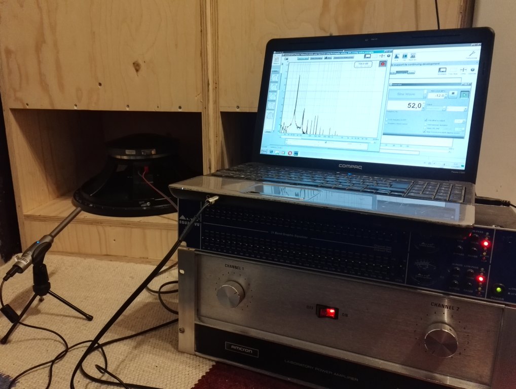

@Tonskulus - Nice amp! Am I correct in that it has a woodstock-ish feel to it? 🙂 thanks for sharing your findings.

But yes, DC300A is the amp I can trust 100%. It does all the things what amplifier should do - no less no more. Reference stuff.

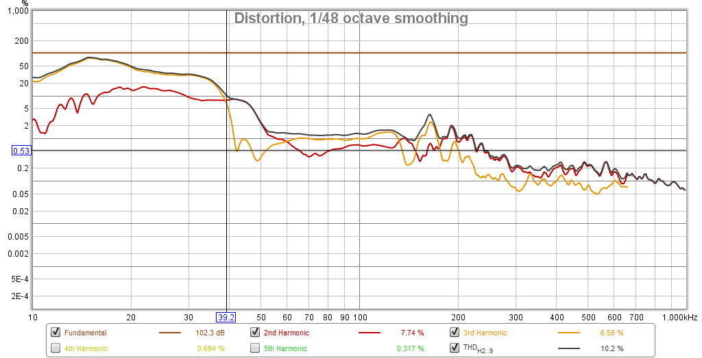

Ok, here is screenshot of distortion pattern. Measured at the mouth.
I'll take impedance measurements soon!

For a clearer image, select the Plot normalised to fundamental" option, and change the highest harmonic to "3". That will make for easier comparisons.
Also, I do distortion testing at various levels, up to the point that the system hits 10% THD in its passband. This typically means that close-miked testing is out, as the mike could get overloaded.
