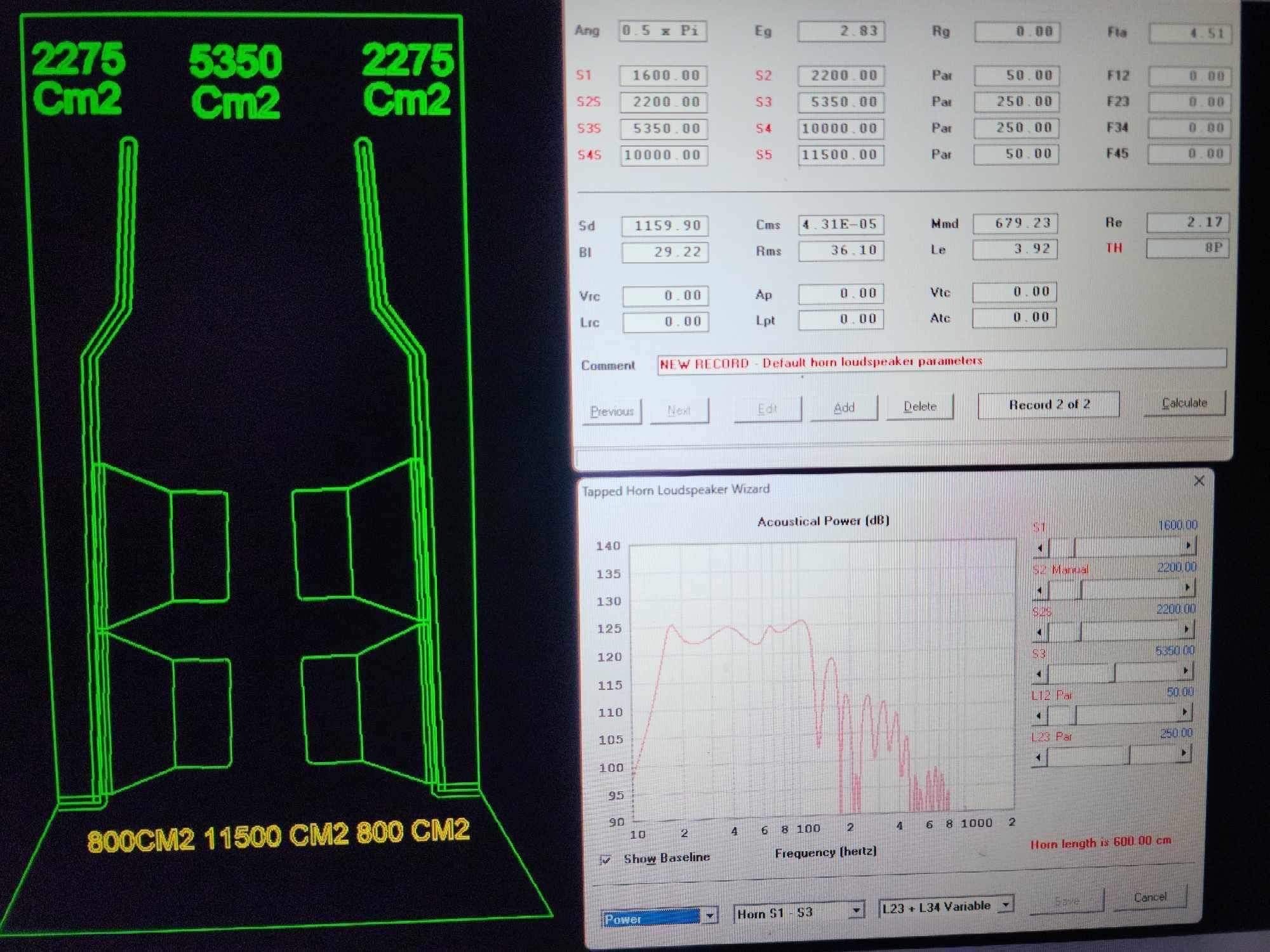

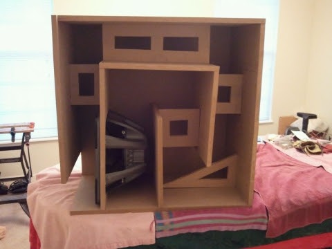

Yeah, his ‘corkscrew’ is pretty cool!Brian Steele built one on his DIY Subwoofer site.

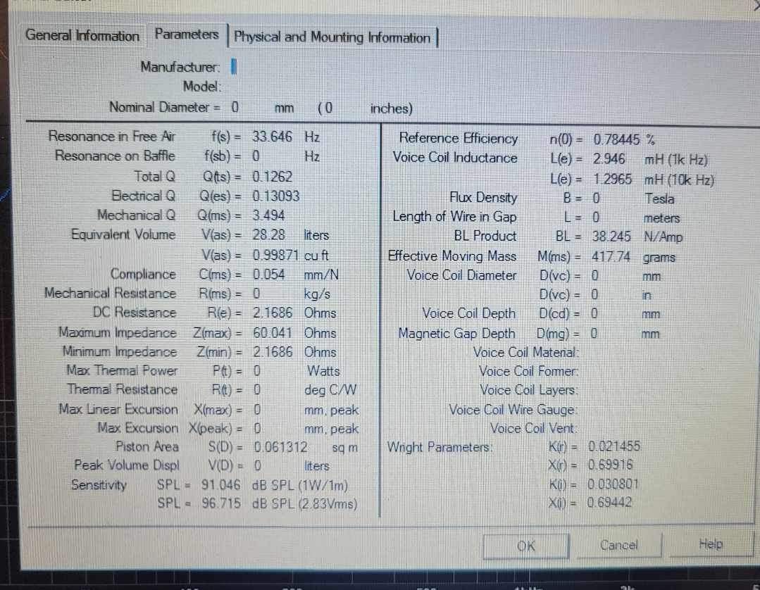

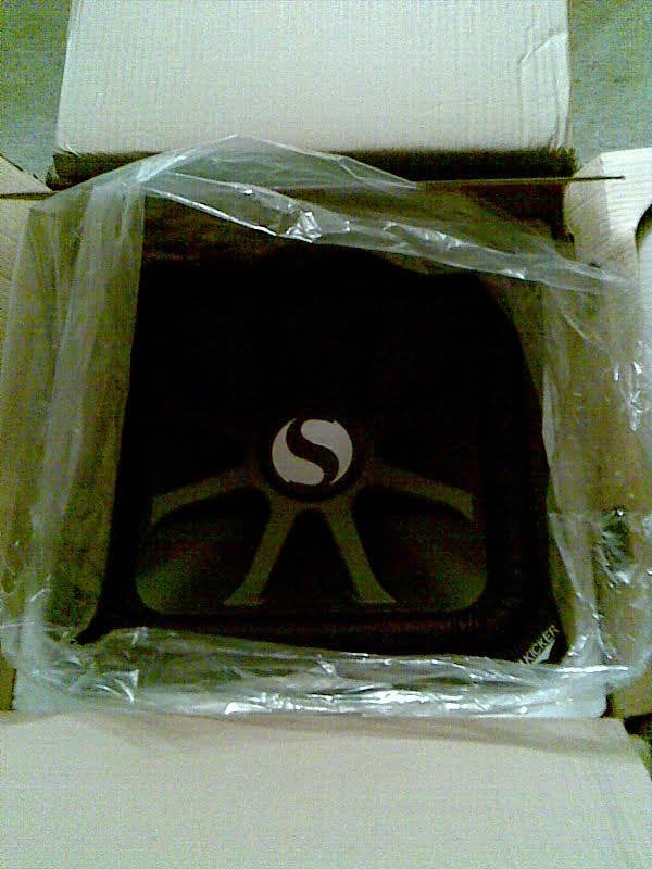

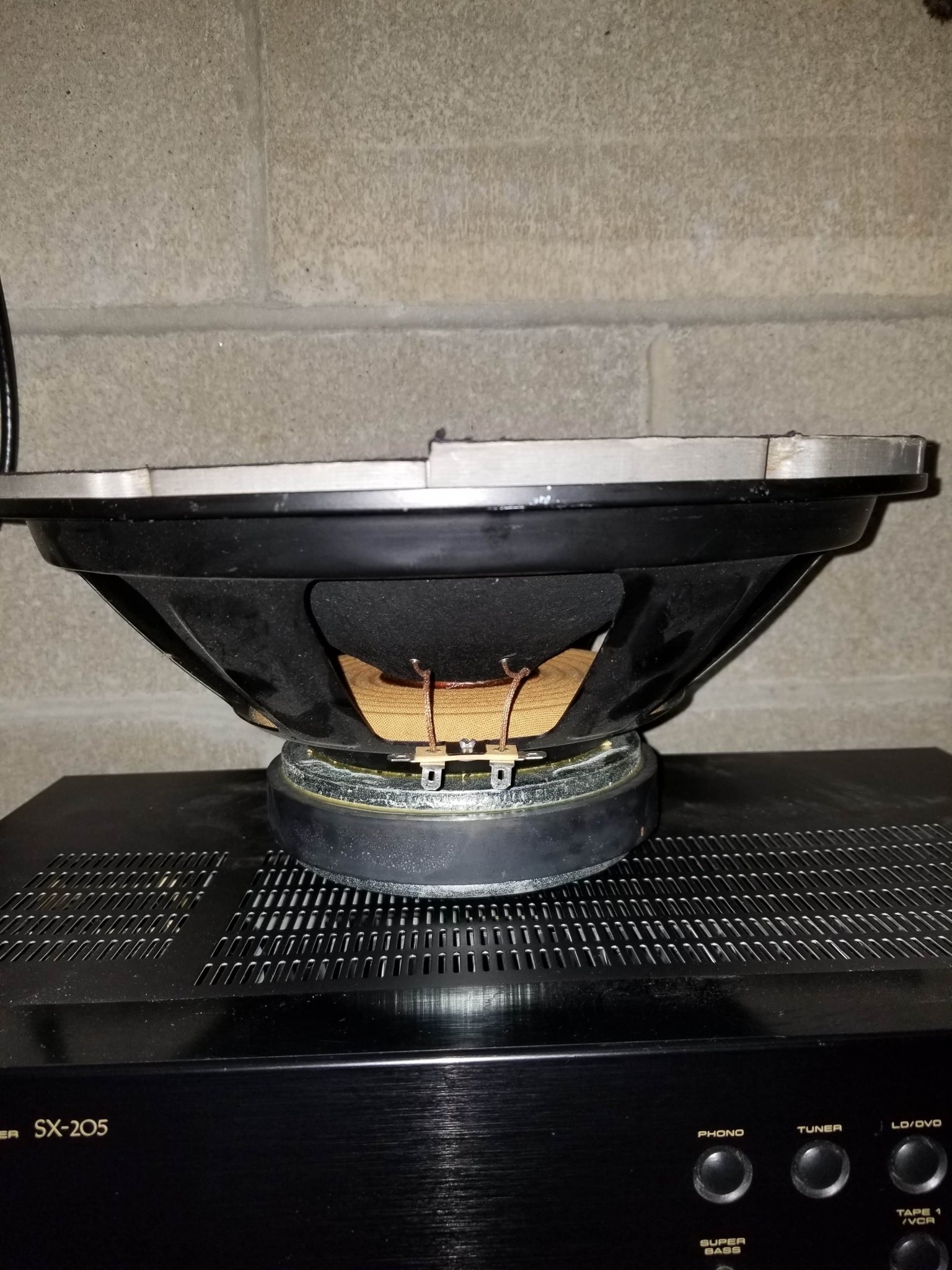

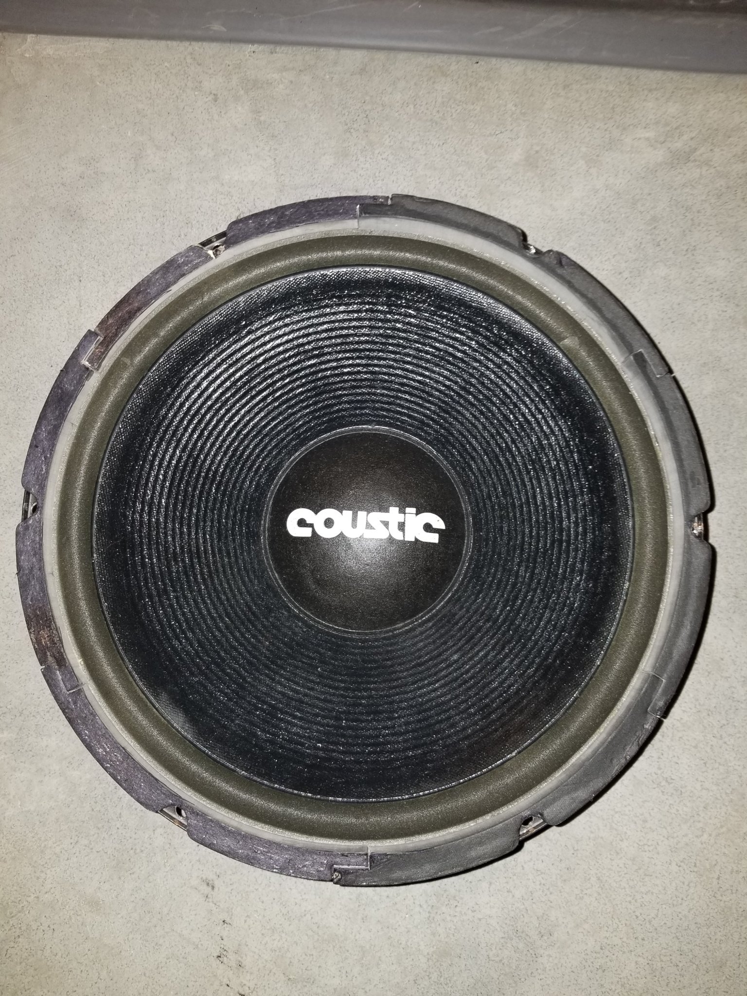

A 613cm2 Sd seems small for a 15.
(14.01" mounting diameter x 2.54cm)^2 × 0.7854 = 994.57cm2 Sd.
I need mounting depth, xmax, wrms, etc.what can you do with this monstrosity?
Car audio drivers are typically not good matches for THs. They tend to have both low sensitivity and high inductance, and the semi-inductance parameters for the driver will have to be measured and used in the Hornresp sim to determine their impact on the response at upper bass frequencies.

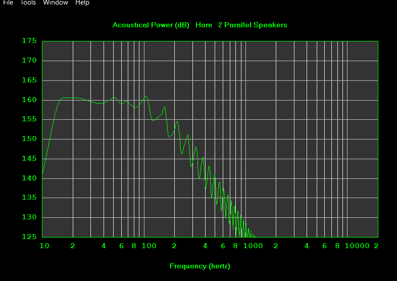

Works just fine for making ‘matterhorns’ (ended up as 10500cm2 at the mouth exit instead if the 11500 in the pic). Absolutely destroys the 6 th order series/transflex bandwidth/impact it replaced in here(because of all those higher qw resonaces and junk) . But goes much lower and with authority as compared to a ‘paraflex’. Creepy !!
-9.25”I need mounting depth, xmax, wrms, etc.
-32mm
-(something ridiculous)
Yeah, strange, like a Rockford fosgate 12”p3 is ‘570cm2 ‘ instead of 510, like a ‘normal’ 12, etc ?A 613cm2 Sd seems small for a 15.

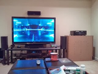

Well, my SAME car audio driver has been working fine for home theater for the past 10 years. I don't need it to play UPPER bass, it's a SUBwoofer. My 15" mains can handle the UPPER bass.Car audio drivers are typically not good matches for THs. They tend to have both low sensitivity and high inductance, and the semi-inductance parameters for the driver will have to be measured and used in the Hornresp sim to determine their impact on the response at upper bass frequencies.

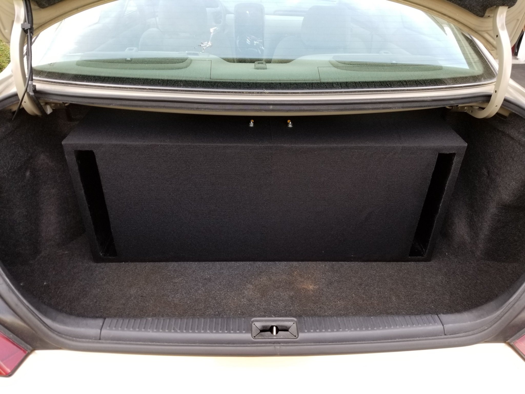

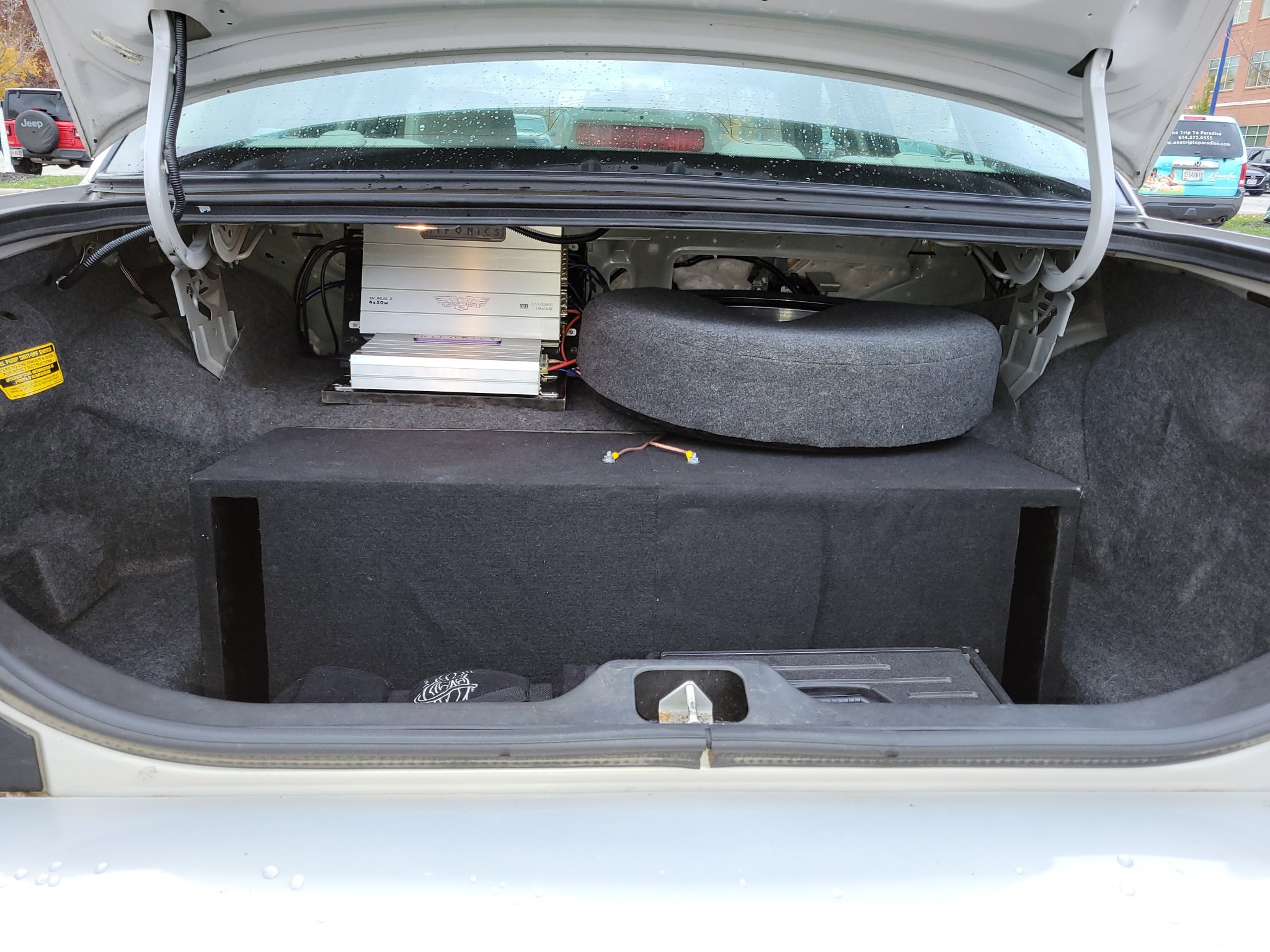

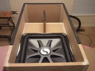

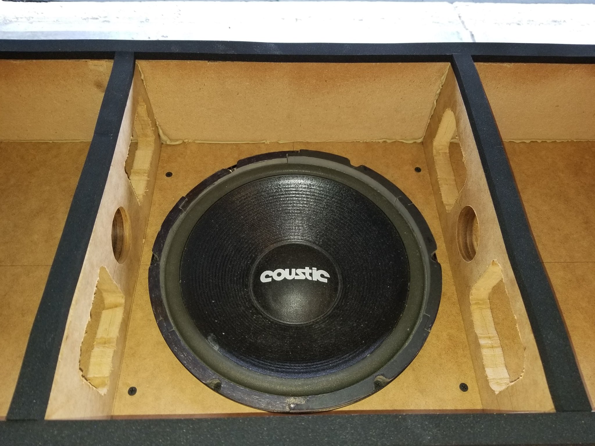

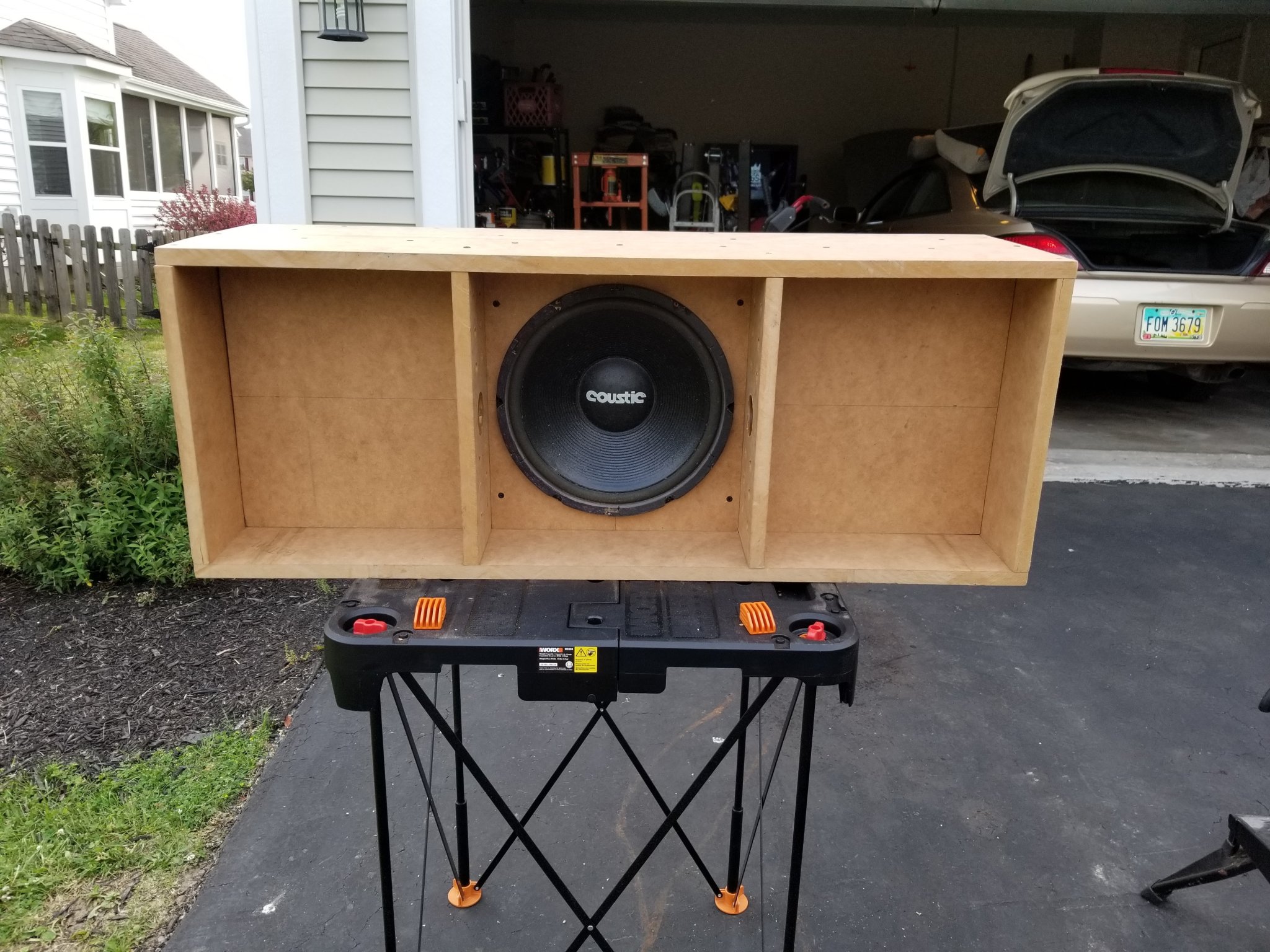

You have really small ports, what do you tune @?
Yeah, I am taking a beating on avsforum.com in the 2023 NFL Season thread.I saw Dallas Cowboys game yesterday vs Buffalo Bill and... Psychology is very important in the sport 😀

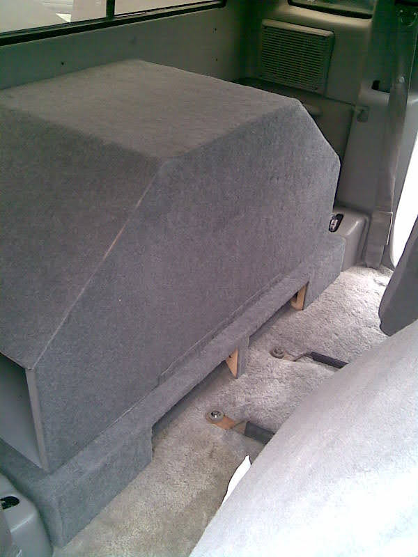

Together, they equal 1/3 of Sd. The twin ports equals a single 13" high x 4" wide port. I think it's around 70hz. 60hz would probably be the lowest I would go in a vehicle when comes to BP4's. That transfer function kills the upper octave of the bandwidth. You can get up to a 30dB boost at 20hz in a vehicle.You have really small ports, what do you tune @?

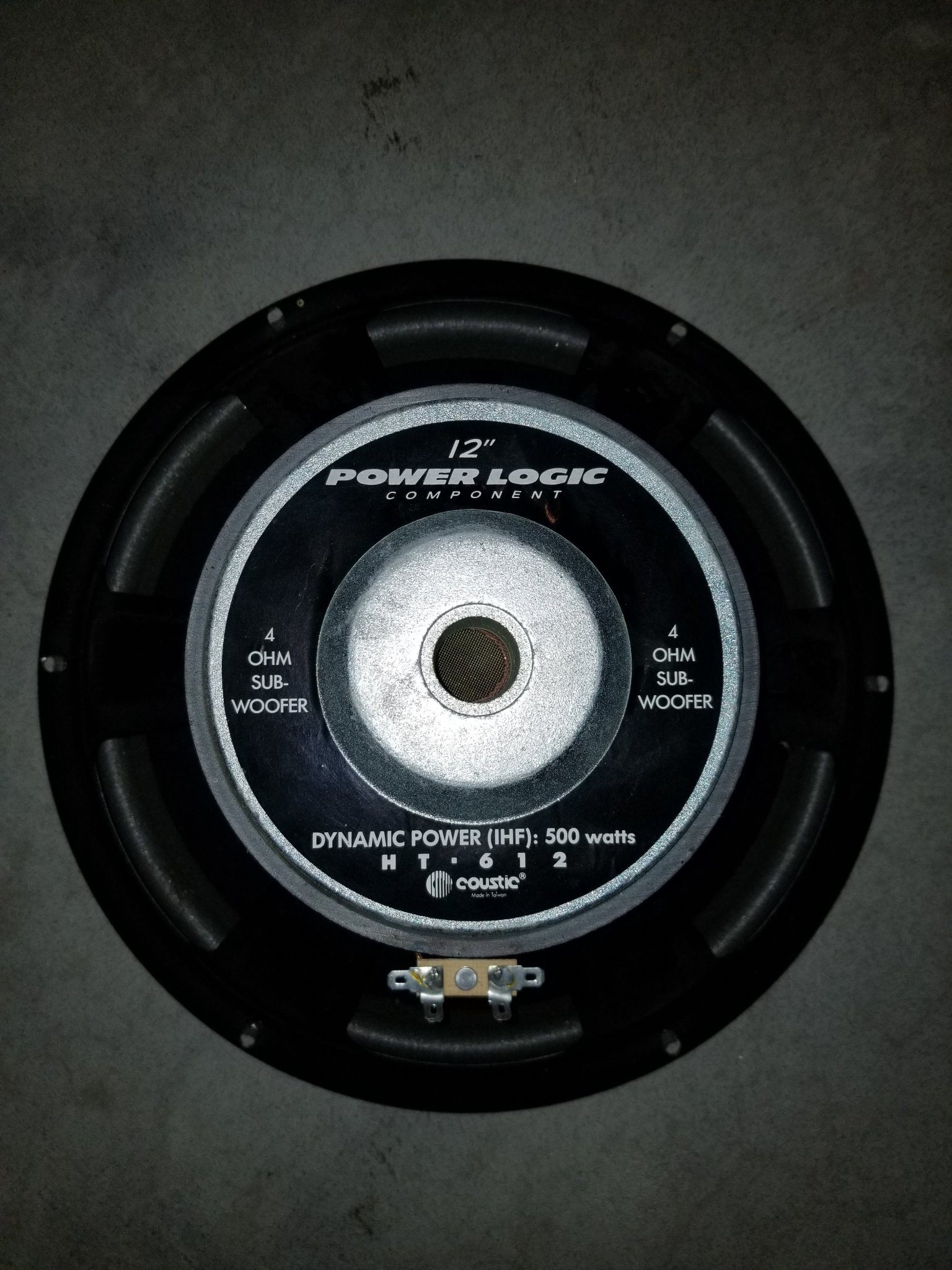

Remember, it's only a single 12" driver from the 1990's.
The older car audio drivers are quite different to the ones you get these days. My old JBL 1200Gti would have worked quite well in a 4th order BP box, perhaps even a 6th.Well, my SAME car audio driver has been working fine for home theater for the past 10 years. I don't need it to play UPPER bass, it's a SUBwoofer. My 15" mains can handle the UPPER bass.
While you fooling, I got a 25-30 year old car audio driver in my car that should have died years ago.
The modern car audio drivers have low Vas, high Le, and pretty low efficiency. Great for getting one-note bass from a car audio build, but not much else.
