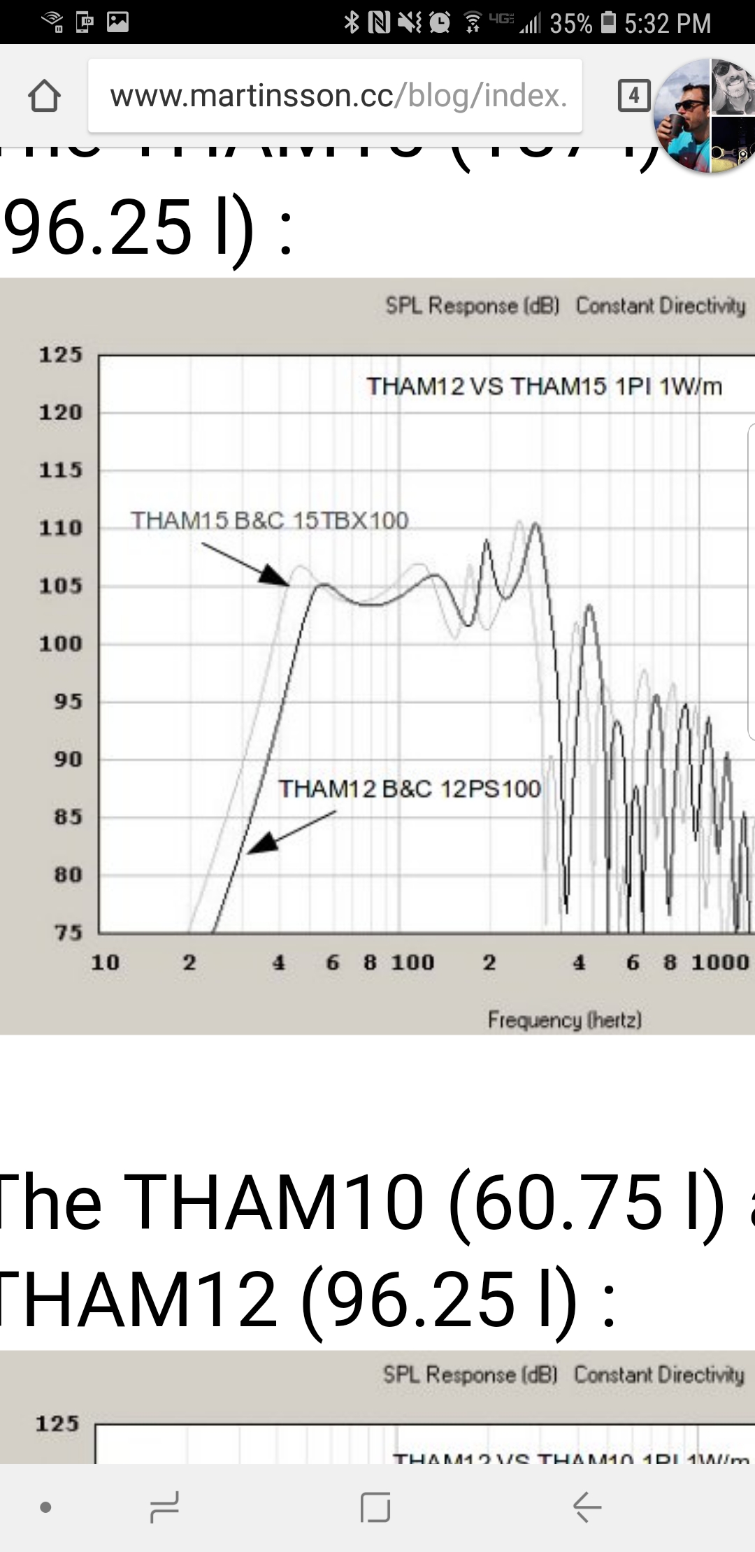

Hey guys call me Dr. Frankenstein for bringing this back to life, but I just read all 42 pages on this Tham 15. Awesome Job Martinsson! I have already built Art's amazing Keystone sub and now need a sub for the old boat. This design seems to fit the bill as its compact and performs. I love reading on this forum its very humbling to sit in the peanut gallery and listen to you audiophile mad scientists work things out (coming from a lowly mechanical engineer who has a love affair with Solidworks and FEA as well).
Anywho nuff brown nosing. This sub is going in the back corner of the ole boat. I have a Kicker CX1200.1 (600watts rms at 4ohms). As you know I am power limited on a boat. I also am a full on bass head sorry its a real condition. Here are my questions:
1. Is there a consensus on the reflectors... I mean real world testing results Mk 1, 2, 3, 4. from Martinssons blog it looks like no reflectors is the way to go overall. Martinsson's Blog - Showdown in Stenungsund (THAM 15 & MKII proposal)

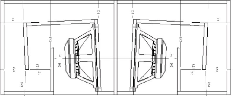

I did this late at night after work as fast as I could so its not great, but it conveys the design and shows both Metric and Imperial units. I also did a fractions drawing for us Americans haha. Its unchecked and I will build from it this weekend and let you know if there are any issues. It includes dual units for checking against Martinssons design and a cut sheet. I will let you know how the 15TBX100 15 4ohm sub build turns out.

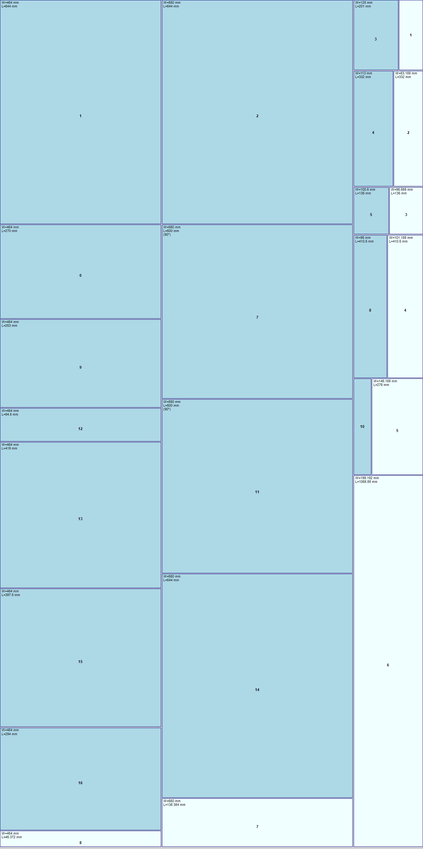

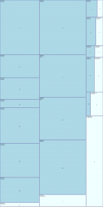

I'm lazy and have not read every single message in this thread, but here's an optimized cut list for the original MK1 THAM 15. It's super easy: you make the two long vertical cuts left to right, then the horizontal cuts are top to bottom. Note that that braces are all square as this cut list is made for a panel saw, not a router. Once you've made the square cuts it'll be up to you to then make the angled cuts. Thes cuta allow for a 1/8" kerf, but you should have plenty of waste at the end of each piece for a thicker carbide rip blade etc.

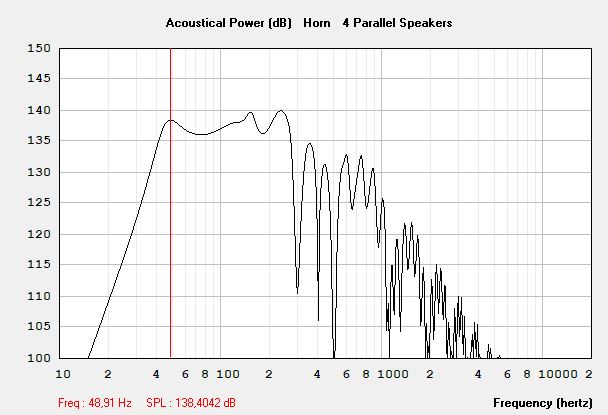

Hi All, whats best way to build a dual THAM15(2 tham15 merged into 1 cabinet) Must the mouths be close together or at the ends? What are the implications of both layouts?
You can share one side to both drivers s1 path. Mouths should be close together.
like this:
Suppose I built four of these, and clustered them as shown here, but the second pair on top. In other words, all four mouths right next to each other.
If I understand correctly, this should give a little bit more LF extension, correct?
(If I did this, it would be for extension, not for the extra SPL.)
Is there a way to calculate that response?

To my knowledge and testing TH's. They do not extend like FLH's do. You get a flatter response over the passband however. You could probably can lower the Highpass a bit and give each driver less juice. You do get more output with four mouths together and you get further thow.

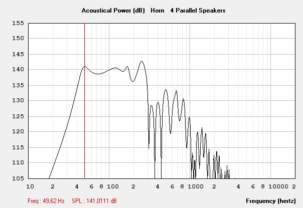

You can simulate a tham in HR and then do multiple speakers in parallel.
This is HR sim of four Tham15's loaded with an Oberton 15B500 (about 400w at 7.5mm xmax:
This is HR sim of four Tham15's loaded with an B&C 15NW100 (about 800w at 9mm xmax:
They also work great with the cheap The Box 15 inch (15LB100-8W) driver from thoman

Post #427 shows an optimized cut list for the original MK1 THAM 15 coming in just under a 4'x8' - add the weight of whatever material (around 40 to 100 pounds) and driver (around 5 to 30 pounds) you choose.## Also: Can anyone tell me how heavy these are, when finished?

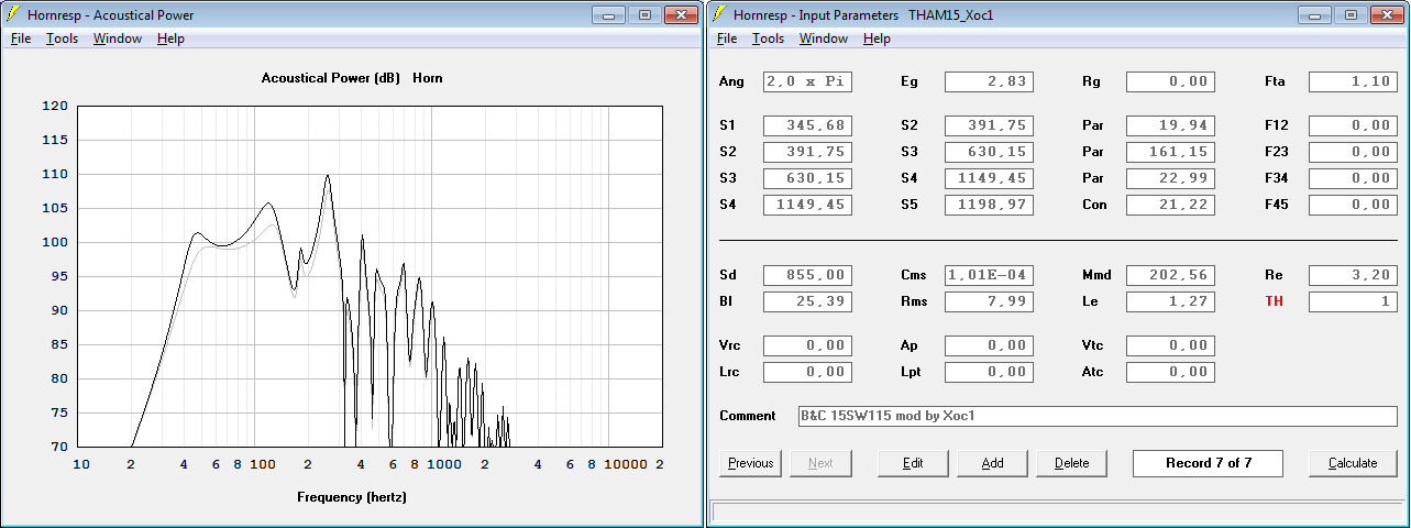

Thanks for running that. Your sim for the 15tbx100 looks a little different than the one on Anders blog. His goes lower. Is yours based on one of the later revisions like mk3 with additional reflectors?
Both sims are probably not as accurate as they could be.

Xoc1 use to do things with more accurate methods and this is the reason I prefer to use his model then the other for Tham15, if he reviews, there is some reason for it but I never checked.

I have not checked but I remember that some of the sims for the Tham speakers if you check the calculated sim volume it is actually bigger than the outside volume of the cabinet.
The sims that I produced were pessimistically realistic in that they would closely match the internal volume of the speaker..
It is always worth checking the schematic volume in Hornresp as it is a good sanity check. It is easy to get excited about making an adjustment to a sim that makes it perform better - but almost invariably it ends up being bigger. Making an adjustment that is an improvement without increasing the overall volume- That's a whole different ball game!
