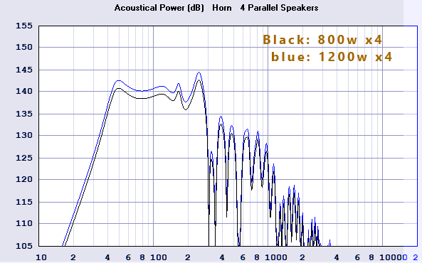

haha, guess what i am planning. especially aiming for the lowend-extension by 4x monostack

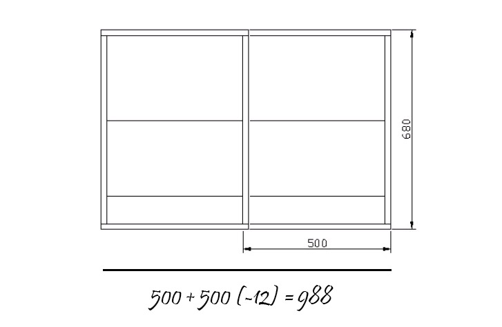

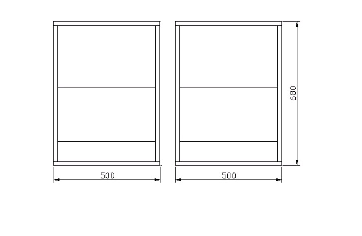

Hi, is it possible to join two tham15 side by side and make dual tham 15? And to make box double the with without middle side, is it something like this doable like in dual bassreflex?
You can share one side to both drivers s1 path. Mouths should be close together.

Hi USRFobiwan, I would like to build a similar "dual enclosure" but need to have the speakers standings. So on, would both options work well or one would be better than another ? I'm thinking about vibrations and most important, saving space and wood.

To be honest i would just build singles instead of a 'dual standing up' version. You can position them anyway you want, and stack them anyway you want, and can build more for your needs.
True that ! Flexibility first you are right, but I just have this project where I need to have everything "sticked" together and where I need to save every Kg possible.

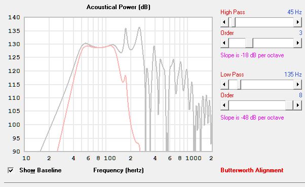

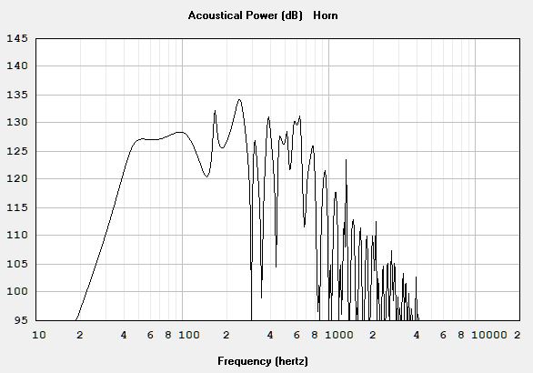

Here is the sim with the B&C 15nbx100 (black) and 15BG100 (grey) @xmax
You can push 800w per single cabinet at xmax of the driver. if you HP at 45hz/18db. Which is inside the powerband of the driver capabilities and you have a little headroom left.
In my experience and by all the thousands of emails we have got since we published the THAM15 design I would say that you easily can push 1200 watts with a 24 dB HP @ 35 Hz with drivers like the 15TBX100 or similar.

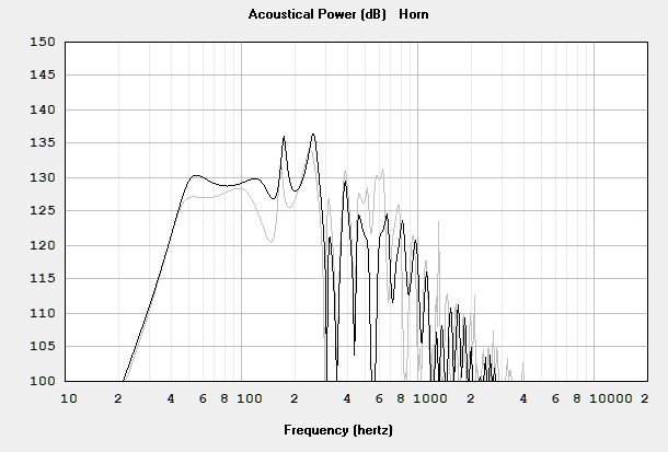

regarding the worry about cabinet width , assuming Hornresp is ballpark then here's what would happen by reducing THAM15 by 1.8cm - then 6.8cm for that LF15N401 RCF woofer. (- don't know if a little width reduction makes mounting the speaker difficult or not as never seen a THAM15 in person)
@Fredi, Yes i think you can reduce inner width. See my tham gallery there is some room left, I think it's safe to cut 2 cm on each side (4cm total)
@circloman, We all know the HR xmax 'prediction' is a bit off. And of course you can push whatever power you want into it. But I was using modest (safe) margin in output. If you are going to push all the power on the driver, I say build more cabinets. Doing 1200w into it will not last hours and it will go into power compression in some time or worse. Even with the TBX100 i will not exceed 1000w continues. You do know they determine those ratings in free air with pink noise?

Well, accounting for the fact that one needs to think about real power burnt as heat on the speaker, not apparent power as immediate consumption, and that with lower band used with impedance peaks across the range, and coil getting cooled by nearly sinusoidal movement compared to high frequency noise, I would believe it could do 1200W with dynamic program power (crest 8-10db) content. On the other hand, for heavy and compressed music with DR of 3-5db, it sounds like obvious and not so long taking death of the driver. In a nutshell, IT DEPENDS...

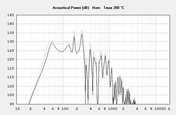

Hornresp is a great tool, but it is not reliable at predicting correct respons or cone travel at high power levels.
The voice coil temperature is going to be rather high for an input power of 1.2 KW. Are you using the Power Compression tool with an temperature of at least 200 degrees Celsius specified?
Here is the 200c power compression (black) with the NBX100 at 800w (80v) in the tham15.

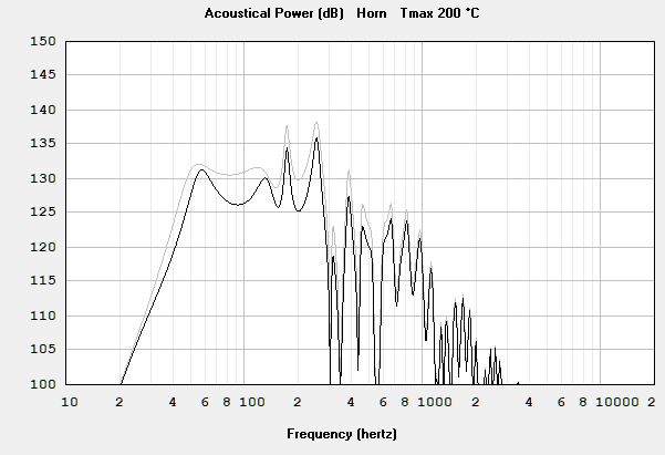

And here at 1200w:
If you look carefully you are spending 400w more power on a few db more output and risking more change of driver failure, more power compression. This makes no sense especially if you build multiples...
