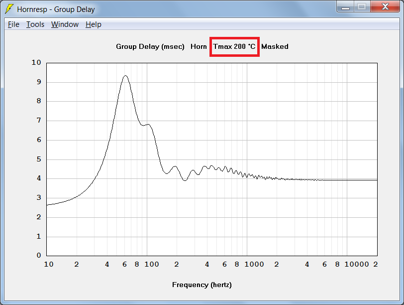

And here at 1200w:
What does the diaphragm displacement comparison look like at low frequencies, assuming a 200 deg C voice coil temperature?

@David what low frequencies you are thinking about? Since I assumed the power compression setting with input of 200c is for the whole graphical representation in HR.
What i see in the graph (tham15 with 15NBX100-8 @800w (80v) as example:
What i do notice, is the power compression is more in relation to negative xmax. I expected power compression would be more severe on high xmax.

Nope. Cone excursion is not directly related to real power spent on the coil as heat. But I would also expect we would see more dips at impedance minimums.

Hi USRFobiwan,
Thanks for posting the comparison.
I was just wondering what effect a voice coil temperature of 200 deg C would have on the diaphragm displacement of the system in question below about 40 Hz. Not much it would seem, at least not until you get below 20 Hz. Unfortunately the quoted driver Xmax of 10 mm is exceeded below about 40 Hz with or without the Power Compression tool being used.
You assumed correctly 🙂. The voice coil temperature is included in each chart title when the Power Compression tool is used, to indicate that this is indeed the case.

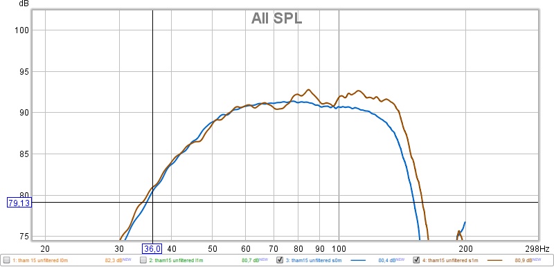

I did a quick measurement of one of my THAMs. Not too close to the simu, but looking and sounding good. For more information see here.
Looks like the -3dB point is around 50 Hz for the raw response.
Did you take an impedance curve as well? That will also show how close (or not) the response of the built THAM15 is to the sim'd response.
Pro audio woofer boxes that have an F3 around 50 Hz are interesting, in that they're fine for most purposes. However, compare them to a 40 Hz (or lower) capable box, and most people would prefer the box that goes lower (based on my albeit unofficial polling 🙂 ). My POC6 build has a similar cutoff frequency, so it was fairly easy to do the comparison between it and my POC3, which can get down to 40 Hz.
